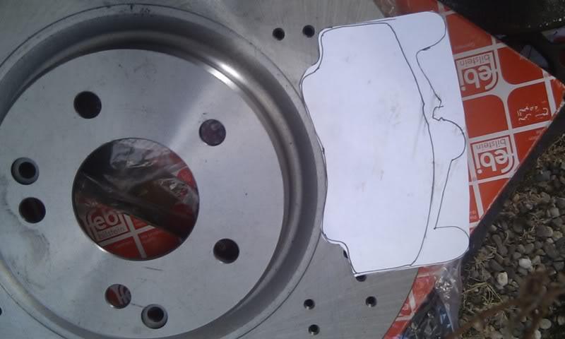

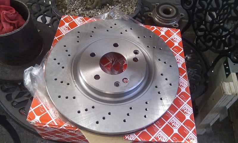

These are the basis of the conversion so far - Mercedes 330x28 drilled. They have an overall height of 46.5mm. They are very reasonably priced - although they are not coated so I will be having to prepare the areas that the pad wont work against to keep them looking nice.
I have offered up a template of a 996 pad and they seem to cover the friction area perfectly - the pad just meets with the machined area on the inside, so I shouldn't have a rusty strip.

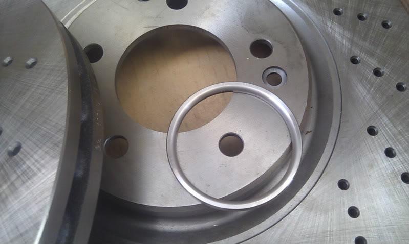

Took them to my local machine shop and they are going to take out the centre bore a bit more - then make a spigot to fill back in again to the 65mm dia. of the VW hub.

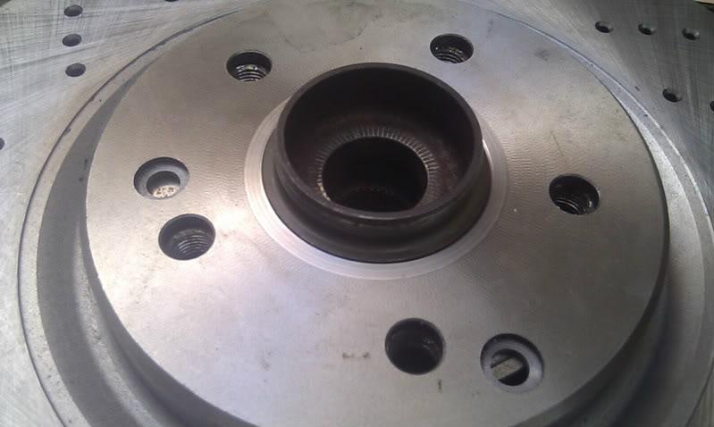

Discs are now back from machining - we took the centres out in diameter then made up some stainless spigots. They fit a treat!
Time to paint them now and hunt for some calipers!

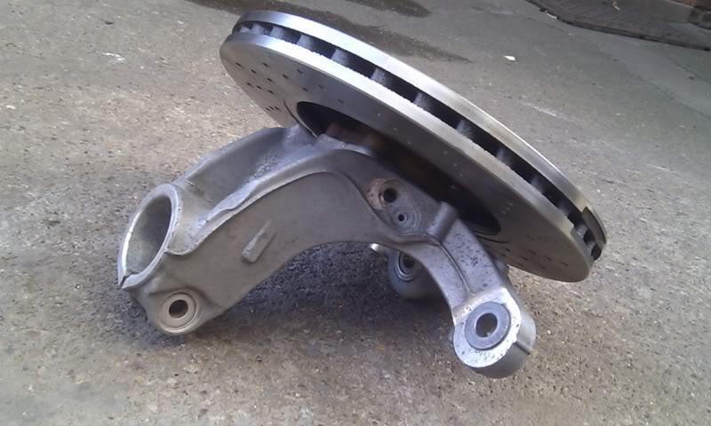

Discs are painted so will put some pics up soon, and I have sorted a pair of 996 fronts that need a refurb for decent money so that is good for me as I like to tinker!
will soon be time to get the machine shop to do me some carriers! :party:
