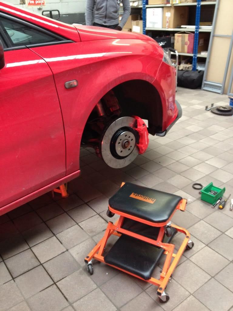

I recently traded the NQSBBK for its bigger brother the 996 TT kit.  The NQS was getting better & better & better as the pagid blues bedded in and I though it may regret swapping but I missed the sight of big discs under the team dynamics on my Leon Cupra (Stage 2+)
Here are some details & my thoughts on the kit.  Its is the same kit found on TEFFs ridiculously awesome specced GolfR

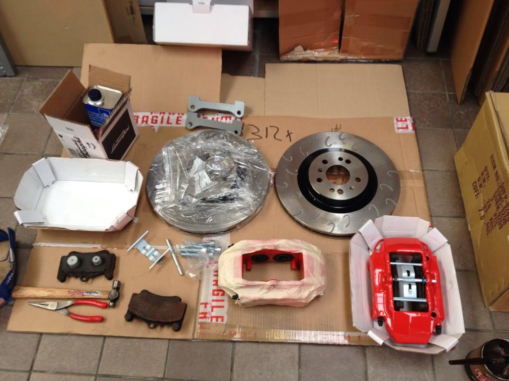

What is it:
This Porsche 996tt Kit is;
  • lightweight OEM Porsche 4 pot caliper
With a fitting kit comprising of;
  • 350mm rotors in a choice of plain, drilled or J hooked
  • Brackets for either Gti, TTS or S3 / Cupra or Passat R36
  • Centering rings
  • HEL performance brake lines
The calipers have unique piston sizes of 36 and 44mm that work really well with the MkV platform Master cylinder

The Part numbers are:
996.351.429 Left
996.351.430 Right
and are from Porsche 996 Turbo, 996 GT2, Carrera 4S, Carrera 2S (The later 997 S also got these calipers)
A fitting kit with plain discs is £450
A fitting kit with Drilled discs is £485 - Ive had drilled discs from Dave on my OEM Cupra setup and they were superb!
A fitting kit with J hooked discs is £515 - Ive had J hooks on my NQSBBK , S3 rear kit and now this 996 Turbo kit and they are also  :drool: :drool:
Calipers are typically £300 - £400 and could be brand new right down to needing a full on refurb.

Bear in mind with this kit the discs supplied are designed to be the right width (34mm) for the caliper so there's no need to modify / trim the pegs on the caliper to squeeze the disc in.
Remember the calipers will need reversing, this is explained in the NQS BBK link above.

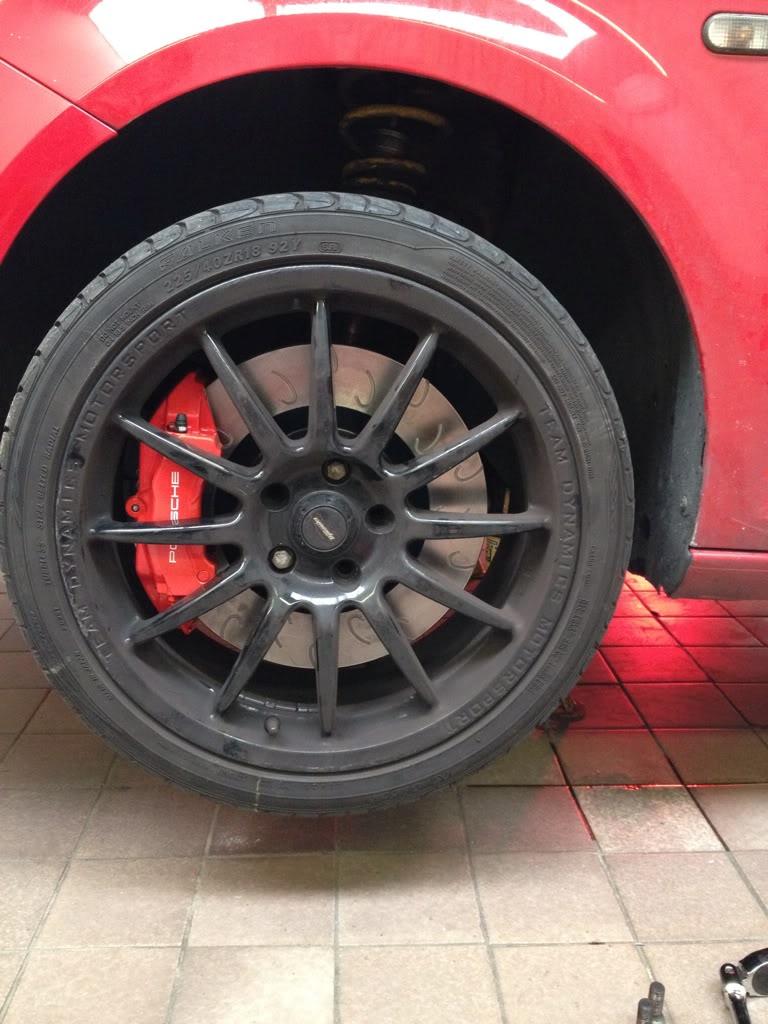

I had to use 3mm spacers on my car but dave has had this kit on a Golf (QD's I believe) under BBS Golf BBS VZ's wheels without the need.

Im using OEM Porsche pads (used ones) for now and although Ive only covered a few hundred miles they are bloody brilliant!  Bearing in mind Ive just had the v3.1 APR map update, Ive been putting the car through its paces and its  :surprised: :scared: quicker than before.  Shaving the speed of is effortless with these without the off / on feel of some brake kits due to the small pistons working at lower speeds and thier bigger brothers joining in if you really want to stop!
