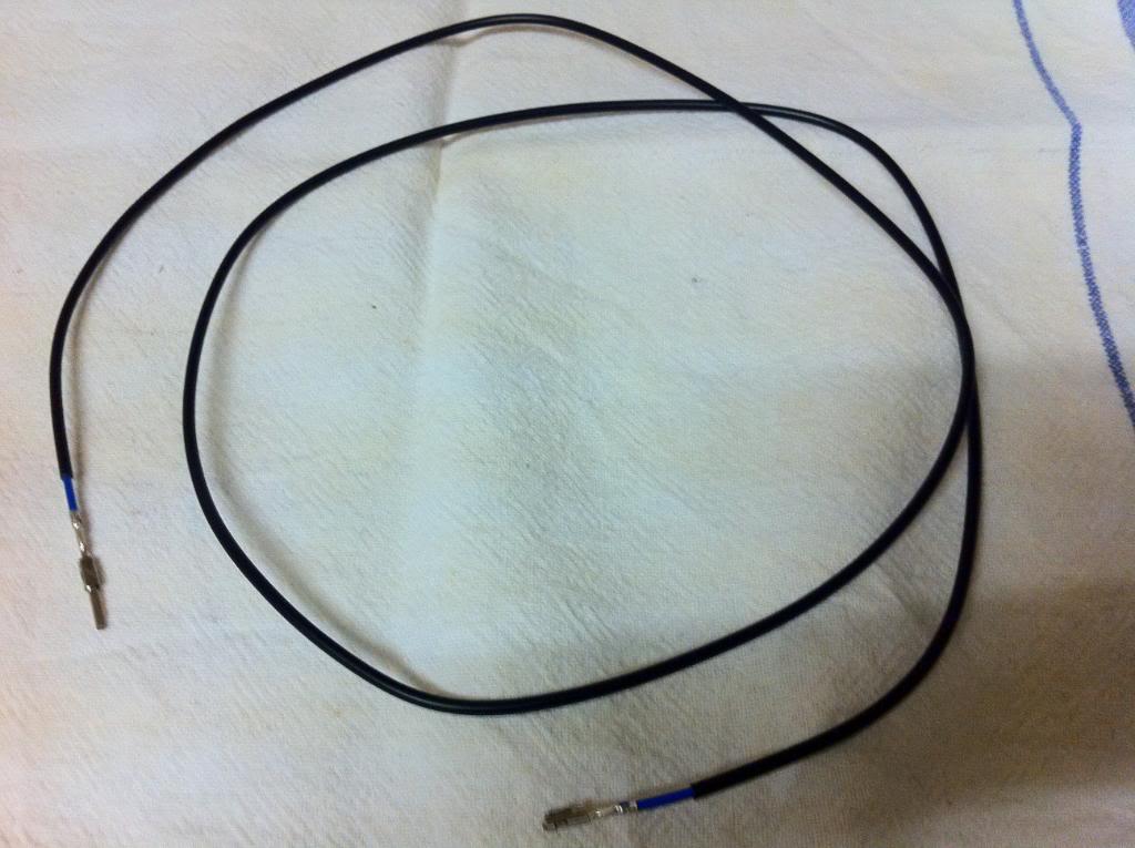

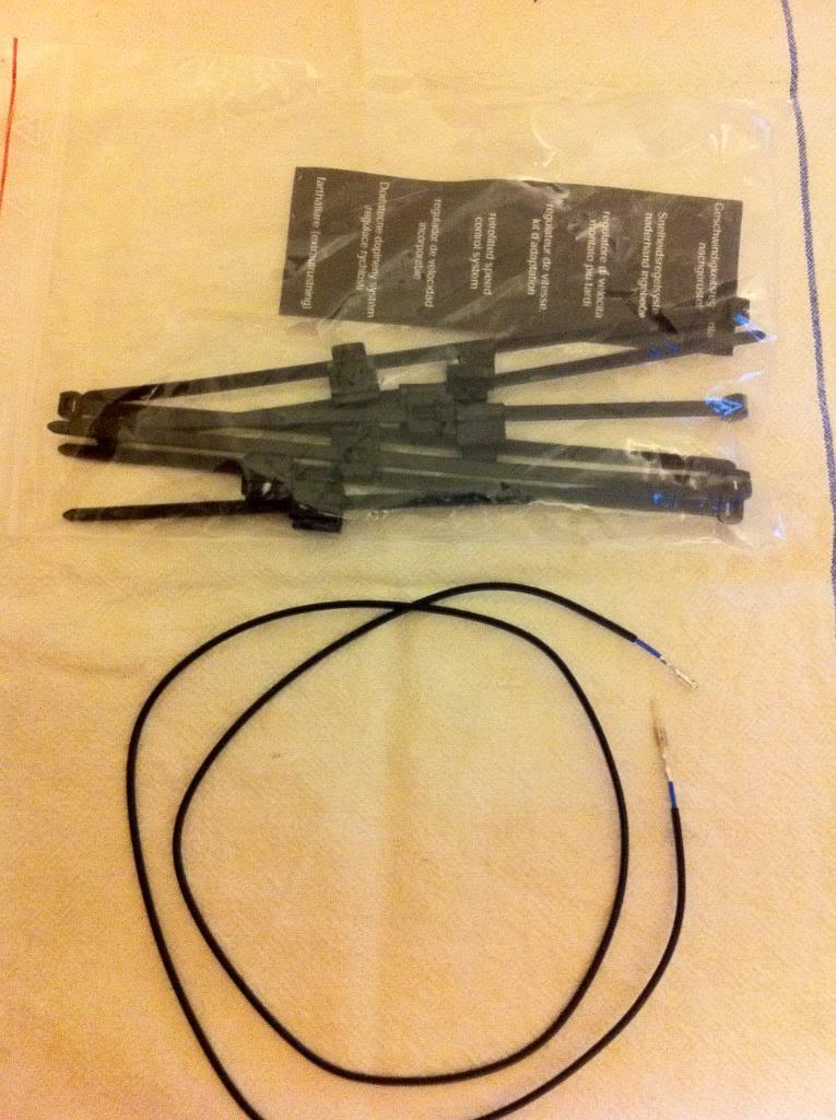

Good news if were talking about the same thing  :rolleye:
I have the wire left over from my install as i didn't need it
Eddie might help confirm if this is what your looking for  :innocent:
Part number 1K0 054 690 A
PM your address and i'll wing it over to you, your welcome to it as it's doing nothing here.  :happy2:
This the one?

« Reply #5 on: February 08, 2012, 07:45:35 pm »
That's the one.
