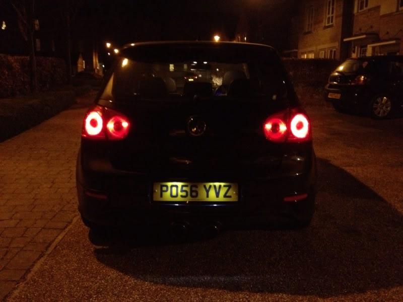

Pics as requested! Kit was easy to install and well made! I might put something over the ends of the leds so the dots not so bright but overall pleased :)

Are they more ring like in the flesh?

the inner lights could do with brighter bulbs to match the outers

Ideal glad you found them easy to fit, i did think about maybe a little black paint on the tip of the LED, that way i think the spot wouldnt be there and it will make the ring appear brighter, as the spot wouldnt be as bright, if that makes sence?
