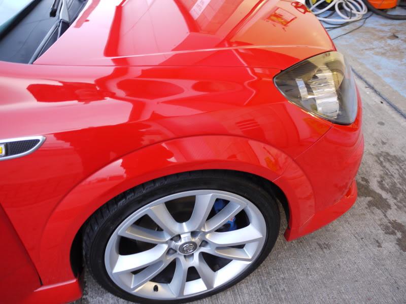

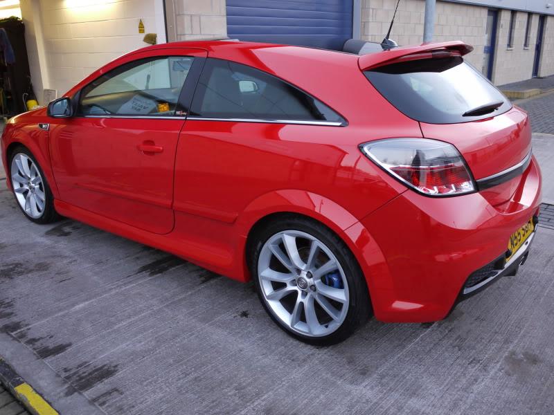

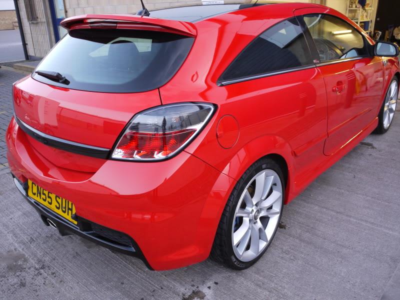

The car in question is a 55plate astra vxr, just bought 3rd owner. Previous owner had it machine polished before selling. It had a lot of polish residue on plastic trim and in door jams and in panel gaps as well as trade mark pinky paint. Owner wanted a general tidyup heres some befores
Started on the engine bay using AS G101 once clean dressed with AG vinyl & rubber then left to dry before moving onto the wheels - Megs wheel brightener as i had a damaged one gathering dust. Pre wash was AG tfr for arches and tyres power washed off then snow foamed using various brushes for the panel gaps etc.

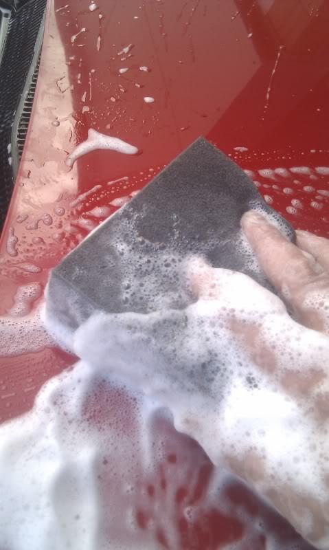

2BM with AF Lather, not been sure about this as I always need more than the instructons say to use. I have switched from lambswool mitts to valetpros new sponges and think they are good alternative seeing as lambswools at its most highest pricewise.
once washed and rinsed it was de-tar time with tardis then iron-x for decontamination. not a good idea as it was blustery so had to keep out of the way of sprayback  :sick: then clayed and dried of and taken inside.
Got out the das6 and set to work with some megs# 205 then a soft pad and some clearkote red moose glaze followed up by reds fav wax Vic's Conc really like this first time I have used this and def not the last buffed of with eurow blue mf's. here's the results

How have you found the valet pro soonge compared to the likes of dodo and zymol?

Once you get it primed so to speak it works well. they suggest letting it soak a while before its first use and mine seems to get better every time i use it. It holds its shape and holds a fair amount of water where the mitt would allow it to pour out before you can get it on the vehicle. I haven't tried the zymol sponge so cant say for that but the dodo sn feels firmer. on one of the pics where the sponge is on top of the bucket its sitting there all fine and thats with a fair wind blowing about as well.

I'm using a zymol sponge and find the opposite to the mitt - it doesn't hold its water as well as the mitt. But it definitely softens up after a few weeks of usage.

i found the moose hidden away so bit of luck. pics show the bumper and bodywork a diff shade of red just like the silver leons bit annoying
I think with all those angles going on on the back of the Astra it couldn't look any other way!
Don't know what the designer was thinking of, other than how to get in a few more angled edges probably  :laugh: the back end is far too busy  :fighting2: :fighting2:

Did you take the vxr badge off the rear?

Started to rinse it the car and if flew off, he forgot to mention he took it off and stuck it back down after spraying the silver trim black
