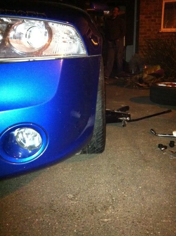

This is 19x8.5 ET45. My new wheels

Rotiform.......? Look forward to seeing them in the metal Thursday.
