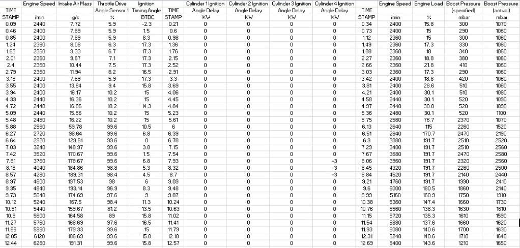

Right guys. Did a couple of runs yesterday to try and figure out reason for poor timing. This is what I got. Being a total n00b at this, would appreciate any feedback on this. Thanks  :happy2:
Run 1
Run 2

« Reply #12 on: March 22, 2012, 01:21:59 pm »
IMO you logs look ok with a good max intake mass.
What setting are you using?

« Reply #13 on: March 22, 2012, 01:26:03 pm »
Thanks for the reply Bacillus, current setting is B:8:F9:T3.

« Reply #14 on: March 22, 2012, 01:33:47 pm »
Personally I would try T4 as you have no CFs for most of your run and see what the log looks like.
Just to be clear, are you using 98/99 octane fuel?
