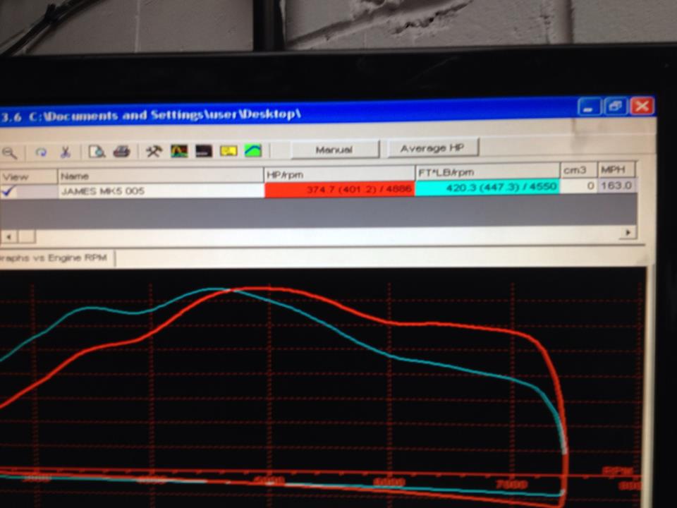

Well I popped to r-tech for a couple of days for some testing to find out really what this turbo can do with WMI!
We started off by setting up launch control at 4k but it was abit of an epic fail, the car has way too much power and just sits there!  So I asked nick to have a look into limiting the power in 1&2nd to see  if we could get a good launch!  (still in testing)
The next fun part was seeing what we could get out of the old girl!   The car was producing good power 380hp/400ftlb but the turbo was tailing off so much at the top end!  (like normal)  So went about adjusting the actuator on the turbo .  We found it nearly made 50hp on the stop end! but you lose it down low but that suites me.
The next problem was we were getting a dip at 5800rpm then it would pick back up at 6200. Logged the LPFP and it was dropping to 3.9bar :(   So I got the latest revision from TPS “1K0 919 051 DB” + new fuel filter it was then holding 4.2 bar  so it is better but will need an inline fuel pump!!
Also just a fyi  the car made an extra 12hp and 10bhp just buy installing a new fuel pump and filter!  (might be something to look into?)
In the end we left the car with some more testing required, but this was the end power result!  Good show for a standard k04 and WMI!!
Must thank nick for a epic car :driver:
