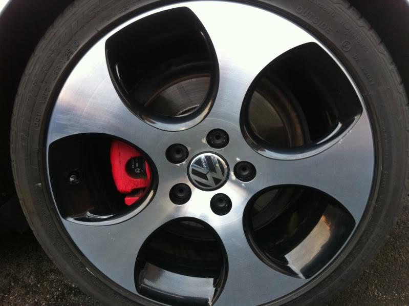

Hi everyone, well its lasted nearly year, longer than I was expecting for my refurbed alloys to stay immaculate, the dreaded white worm has started appearing on one of the alloys:
Despite my best efforts to wash them weekly with Blackfire Gel Wheel cleaner and wax them monthly with Collinite 476s
So what are my options guys?
I was told by S.E.M (who did a great job for what its worth) that theyd probably stay immaculate for a few months before deteriorating, and that because theyve been machine polished once they would not be able to refurb them again. Can anyone confirm this?
Would it be possible to have them just powder coated regular silver whilst keeping the inserts black as they are now?
Or am I best selling these whilst theyre still pretty good condition and going for something different? My car is a standard KO3 GTI in reflex silver if anyone has any ideas for replacement alloys.
Thanks in advance guys
