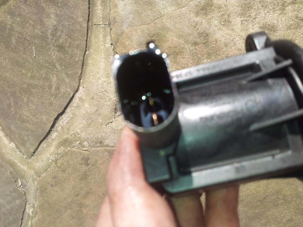

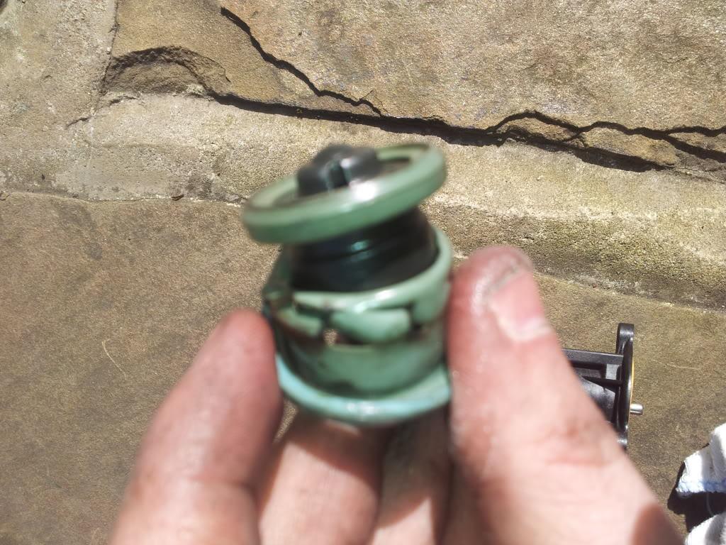

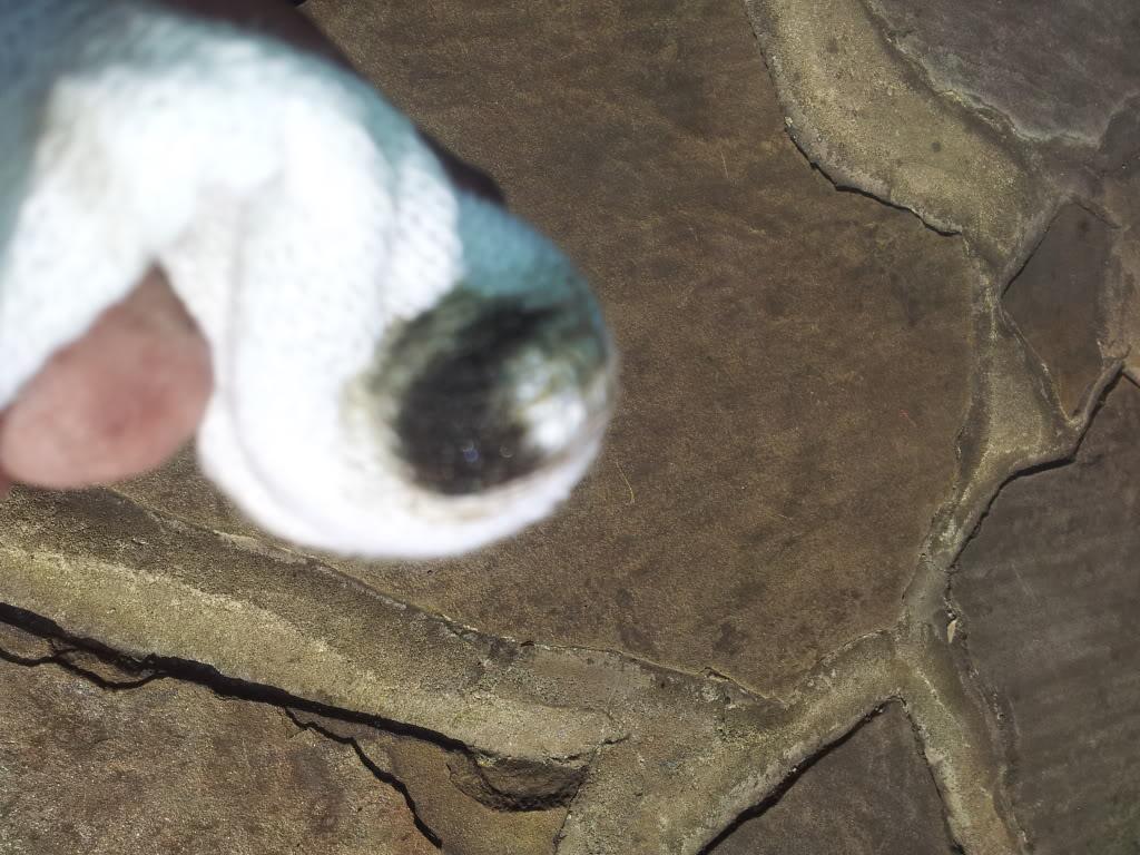

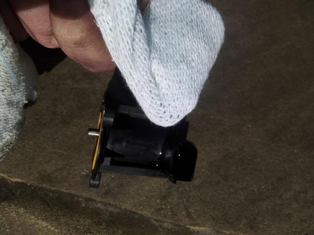

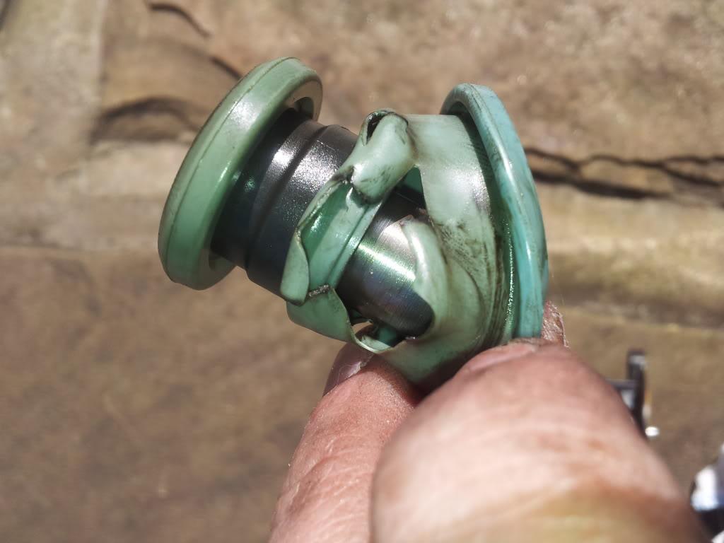

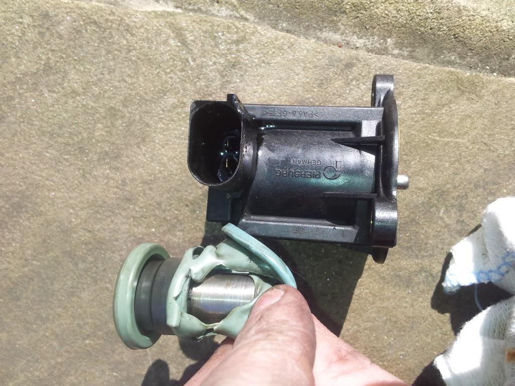

Some quick images
You can see all the oil in the socket here, there was some around the diaphragm but i think it could of been wd40 from where i was trying to get the bolts a little looser.
Heres the actual Diverter valve Diaphragm, Now when i pulled the valve out of the socket the thing actually feel apart, as in the spring and the pin and diaphragm simply fell out over my face, that was quite worrying. Some of the images are of the and the actual lower bit was only just holding on around the top section (where its joined to the pin) so really it was only on literally by a few threads of rubber.
