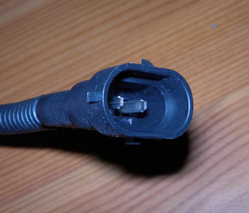

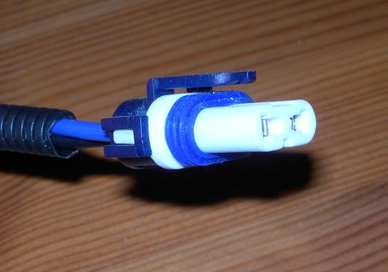

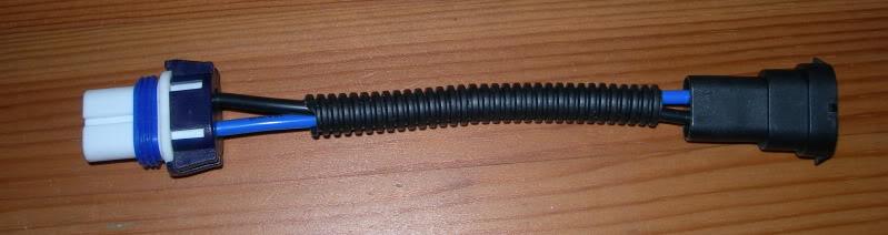

I originally had 'standard' reflector fogs in my 2006 GTI but changed to 'projectors'.
To do this I had to buy some bits and made two convertor cables which went from HB4 socket (to connect to car's existing HB4 plug) to HB11 plug (to connect to HB11 socket on rear of new projector fogs).  With the bits I had left over, I made the 'reverse' cable, so I've got a couple of these spare..
These would be suitable for any one originally with projectors who wants to replace them with reflectors.  Saves hacking off connectors!
