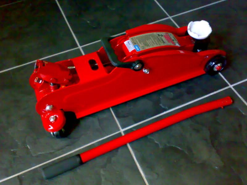

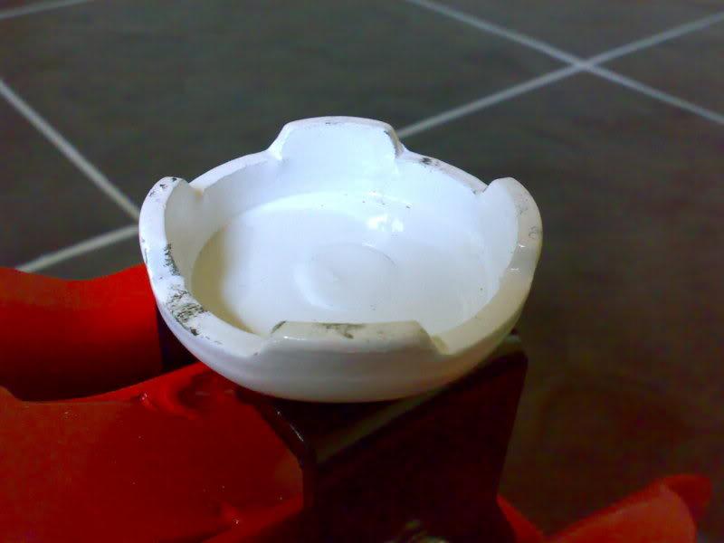

I bought this trolley jack from machine mart and did the 'S3 jacking points' mod to make life easy for changing the wheels.  Just squeezes under the sills and is easy to use.  Mine is on standard suspension, so not sure if it would be too high for a car that's been lowered.
Clarke CTJ2Q 2-tonne quick lift trolley jack.
Appears to be well made and ideal for 'occasional' home use.
Paul.  :happy2:
