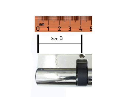

I have seen the video of the normal Astral ones and you can see that they are brass and dont have the anti snap bar though the middle, the S version has anti bump built in, as for one size fits all then no they dont fit all but they do have many variations in size, what you need to do is measure your current lock and then buy the one that suits, if ones to lon then just deduct the unnecessary bit from the measurements, i will find you a guide to measuring your current lock, ps the locks are about £30 each.

You basically measure the screw hole in the middle to the outer face , you do this on both sides as some locks are equal and some are ofset, the good thing about the astral is you dont need an internal and external side and the key can be turned whilst a key is already in the lock, i ordered mine from here and got keyed alike for free too http://www.barnsleylockandsafe.co.uk/ , i have also used http://www.saundersonsecurity.co.uk/ but Barnsley do the Hoppe handles to so saves on shipping etc.

Measuring is relatively simple, remove the cylinder and measure the total length then the length from each end of the cylinder to the centre fixing hole, the internal measurement (portion of the lock inside the house) is always quoted first, then the external one,
This is usually only applicable to the higher end locks such as the ABS/MTL as its important the external side is correctly positioned to provide full protection  :happy2:
e.g my locks are 80mm total length made up of 45mm internal and 35mm external, so if looking at an advert when purchasing they would be known as 45/35
