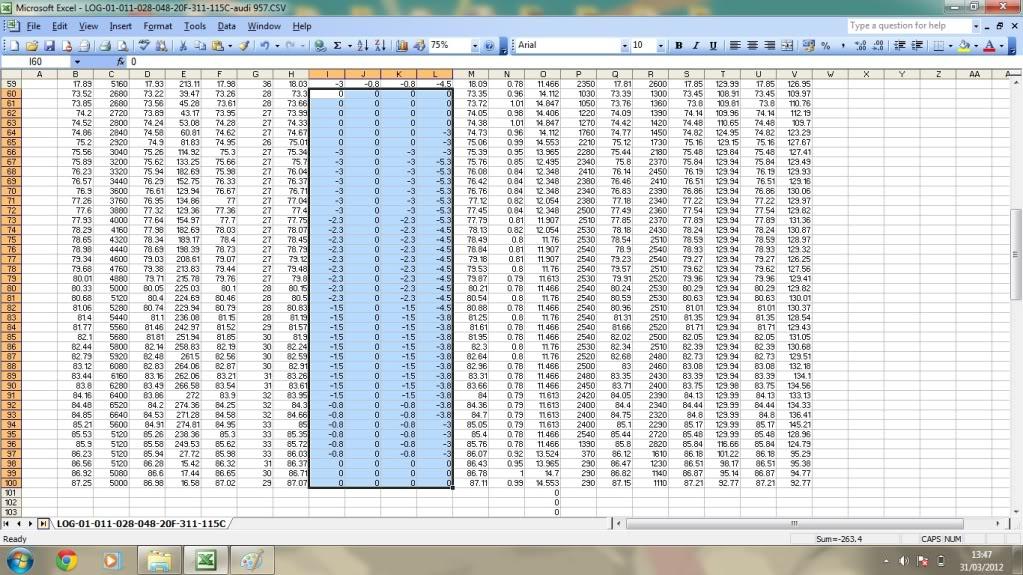

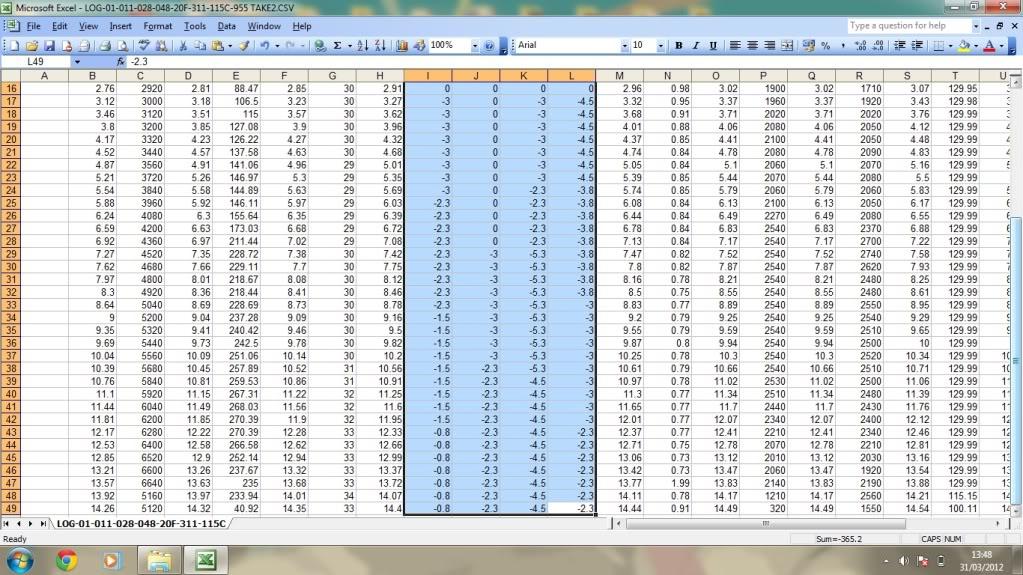

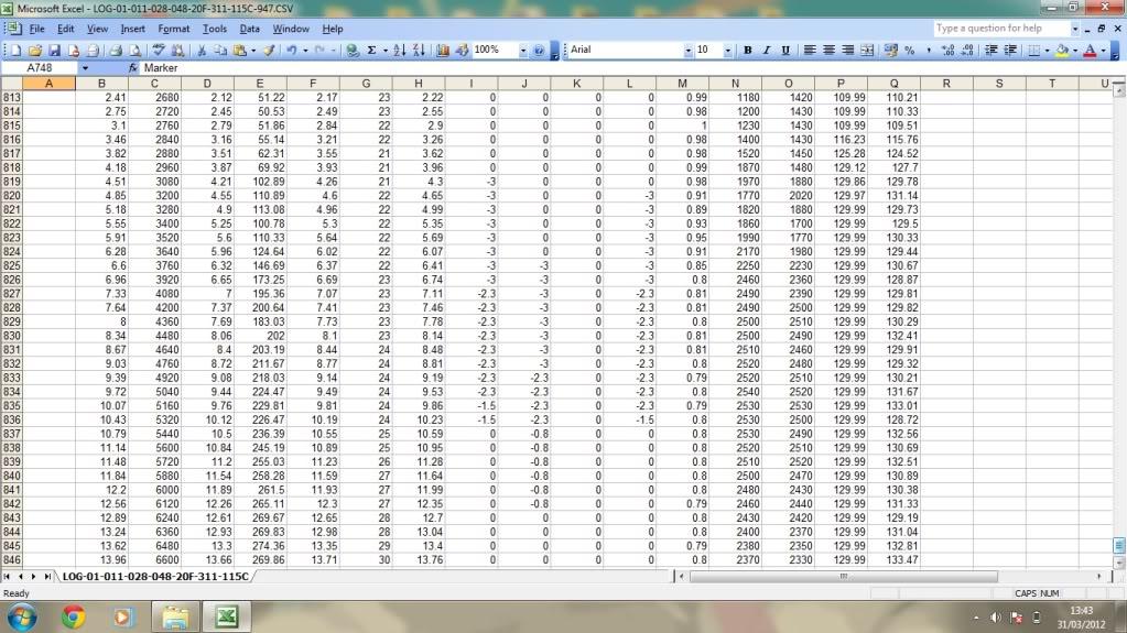

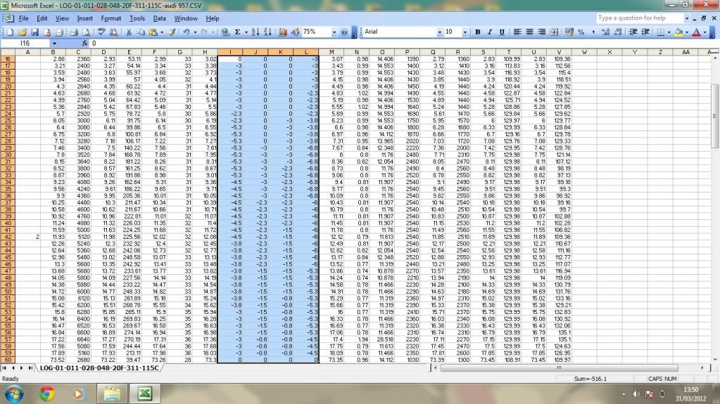

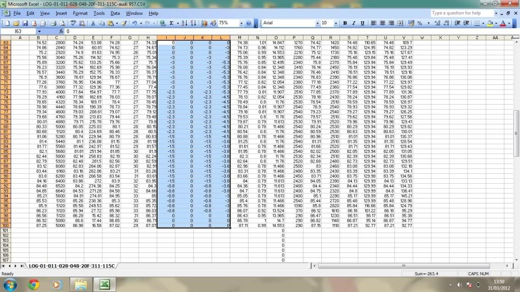

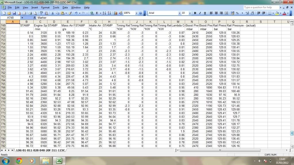

Hey guys, need a second opinion on these 3 settings for Justin's S3. He originally had 957 which AwesomeGTI set for him, took the car down to TC Garage to have his THS cooler fitted and they dropped the timing back down to 4, so its now at 947 (B/T/F).
IMO 947 is good for Justin, however Justin can notice a performance loss down in low revs since the timing has been dropped, so we was hoping to bump the timing back to 5 but from the logs its not good.
I also set the fueling to 5 to see if it helps (955)
I set the S3 BTF back to 947 as i felt this is safe!
To be fair the car is quick, and a nice 4.2 seconds 0-60mph  :laugh:

Try 948.  Healthy maf readings.

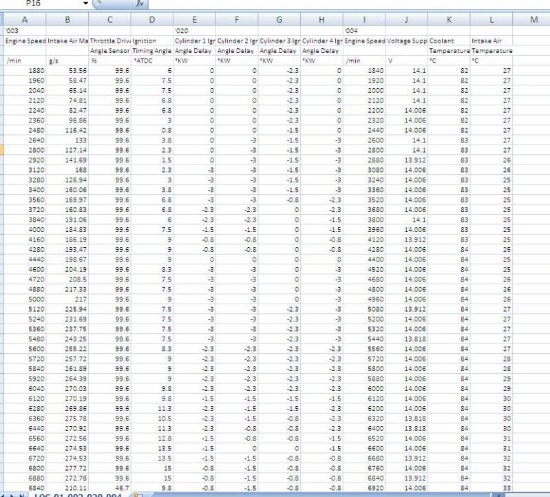

Think my peak air flow is quite low compared 238 iirc
Re: Data log Jussa S3 Stage2+
« Reply #8 on: March 31, 2012, 05:12:46 pm »
Your MAF reading cannot be that low mike.

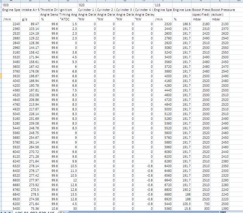

Heres what I have with mine. .
I'm unsure wether 856 is better, as very little pull, but 956 has quite a bit, but all 3 or under which from what I understand is ok?
278.5g/s  :laugh:
856
956
966

It's all about fuel 9.  I run 959 on the Revo race file with the hybrid.
Dom, try 858.

235g/s mike.  The VAS logs showed 845kg/h MAF.
Wouldnt worry about it mike.  It makes good figures, pulls like a train.
Did you remove the ITG heatshield?  could be inhesting hot air
