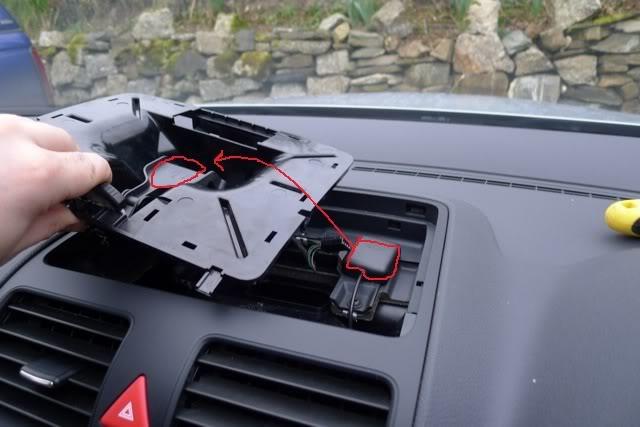

The Satellite issue seemed to me due to the antenna moving slightly by coming unstuck and then sitting on a slant.
I have a Laviline one if anyone has one are they any good?
I re stuck it and it found 6 satellites...great.
put everything back together and worked for a few days. Again today the same has happened. So i took the top vent of and had a look the antenna hasn't moved?!
But i noticed as soon as i took the top grill off it found the satellites. So it seems like the top grill on my dash is blocking the signal, because as soon as i place the top grill back on it looses the satellites again?!
My antenna is fitted here:
The plastic section in my hand has no effect when that's fitted only the top metal mesh grill
Any ideas guys?

I stuck mine here:
You could try moving it and seeing if that works? Never had issues with the top mesh.
