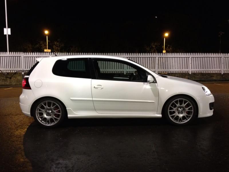

Re: Edition 30 Lowering
« Reply #16 on: April 20, 2012, 01:51:33 pm »
This was the night the springs were fitted so it's settled down a bits sorry for the poor quality picture
PM for details

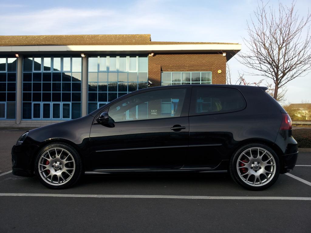

« Reply #17 on: April 20, 2012, 02:58:49 pm »
This is on H&R lowering springs, the ride's great. Very slightly stiffer than standard but at the same time not too low as to cause problems with speed-humps etc. Great feel to the car when cornering!
