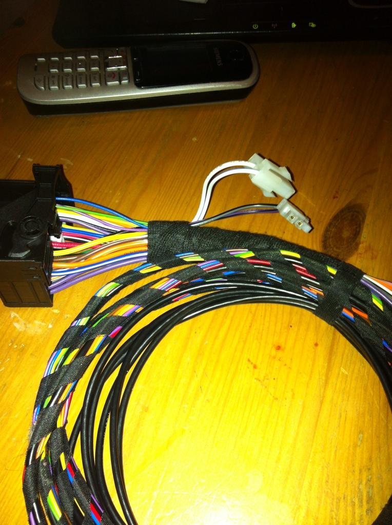

hi all i got a car systems  wiring kit today and was wondering what do you connect this or not?
also when using the BT unit can you still use the MDI or Ipod adaptor?

Coming off the main connector in your picture should be 2 white 2 pin connectors, one male one female.
You will then have a microphone with cable and connector. This connects to the two pin connector with the white wires in your picture.
The other connector has grey and purple wires, this connects to the black shielded cable which runs down to the blue tooth unit.
You then have the blue tooth antenna (if you have the same kit as me) that plugs into the bluetooth box.

That might be to wire with or without voice control.
Stu...
Offline jason_rmh
  • -Given: 69
  • -Receive: 81
  • Posts: 911
Re: BT wiring kits
« Reply #3 on: April 25, 2012, 08:52:23 pm »
Yep thats correct.
If you want to wire with voice control you connect as I said.
If you want to wire without, the mic connects to a 2 pin connector not in the above picture which routes back to the blue tooth unit. Leaving the 2 pin connector coming from the head unit empty.
Jas
VCDS (Preston, Lancashire)
Offline Phil Miller
  • -Given: 86
  • Posts: 744
Re: BT wiring kits
« Reply #4 on: April 25, 2012, 09:09:41 pm »

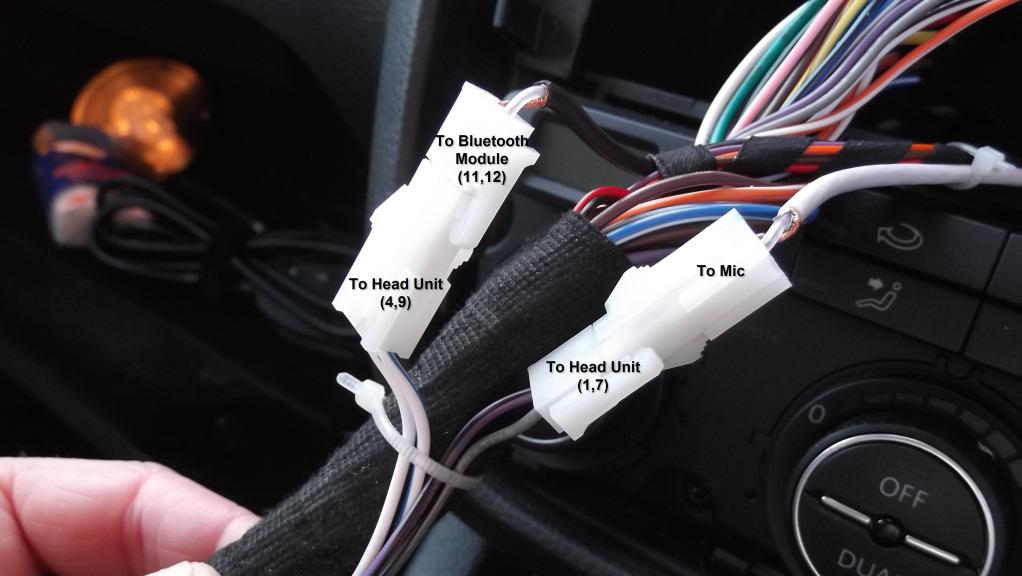

Thank you both thats ideal, so how does voice control work and is it another box that needs adding? take it the plug with the white wires and the plug with 2 purple wires go to something for voice control?
the kit ive got is a 5P0862335C, does anyone know the full pros and cons to this kit? ive read that it works with iphones but some say it will stream music some say it wont, others say it will bring the info up on the highline others say it wont????? any info would be great
If you connect the two pairs of white 2 pin plugs, that should allow voice control, no extra box, but may need enabling in vcds. Also, I think you need the star button on the steering wheel.

Yeah ive got the star button on my MFSW so the plug with 2 whits and the plug with 2 purples connect them up and that gives voice control? ok next question will voice control work with an RCD300 or RCD310, or is it only the RNS510 that it works on?

The plug with 2 whites connects to the wire that extends from the mic.
The plug with purple connects to another plug near by that traces down a black shielded cable. Into the connector for the BT box.
That will give voice control. :)

Phil,
Here's a picture of what I was trying to explain, I took this earlier of my BT installation:
