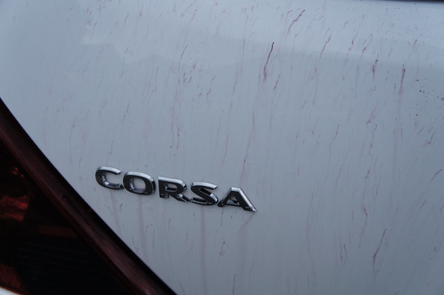

Pretty mucky behind the number plates!
DSC06358 by RussZS, on Flickr

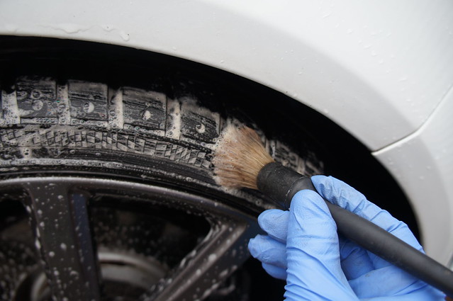

Next Auto Smart G101 mixed 4:1 was used on the the tyre sidewalls in conjunction with a Valet Pro Detail brush, to degrease and release and dirt or existing tyre dressing thus ensuring the new tyre dressing can bond properly to the rubber:
DSC06366 by RussZS, on Flickr

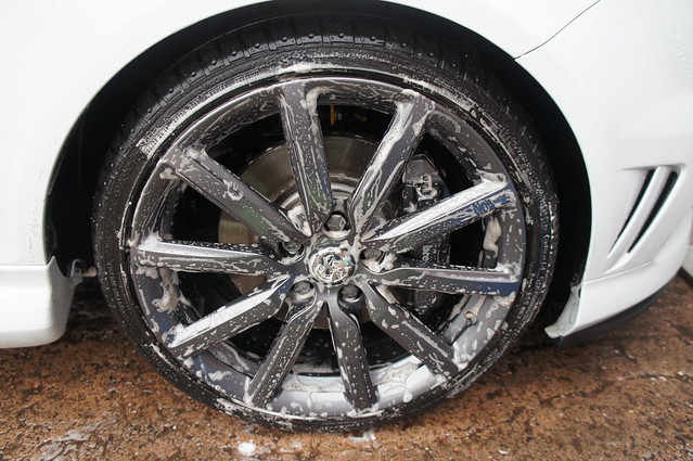

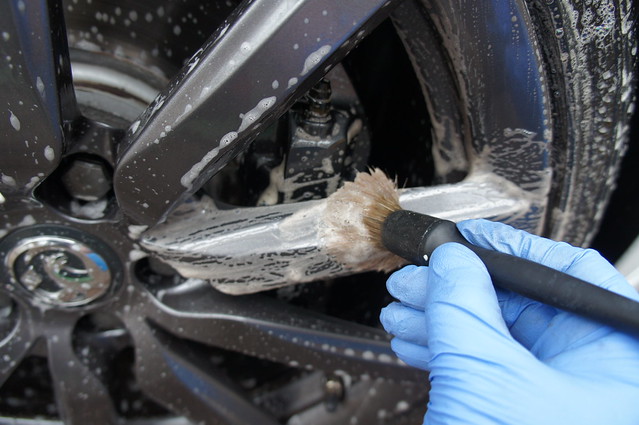

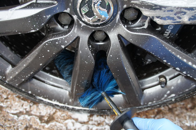

Next Auto Smart Smart Wheels at 4:1 was liberally sprayed over the face and rear of the wheels, along with the calipers, then agitated with various brushes to safely release and dirt and brake dust build up:
DSC06368 by RussZS, on Flickr
DSC06369 by RussZS, on Flickr
DSC06370 by RussZS, on Flickr
DSC06371 by RussZS, on Flickr

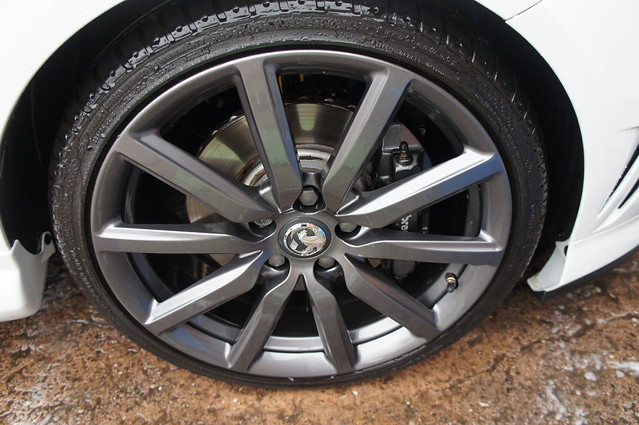

Finally, the wheels were pressure rinsed:
DSC06372 by RussZS, on Flickr

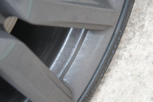

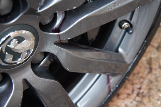

Much better, however there was some evidence of light brake dust pitting so IronX was used to each and every wheel to ensure any brake dust or fallout was also removed safely:
DSC06373 by RussZS, on Flickr

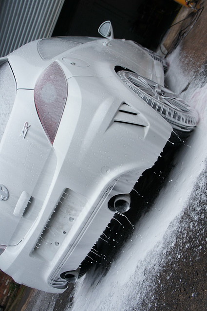

Car covered using HD Foam Lance:
DSC06376 by RussZS, on Flickr

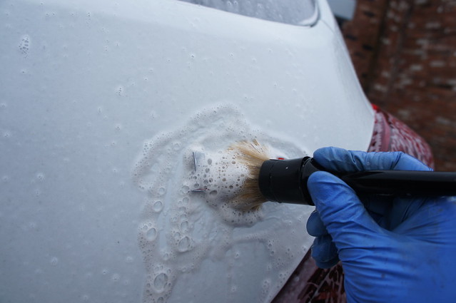

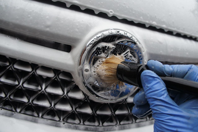

Whilst the Grime Out was dwelling, I worked around the more intricate parts of the car with a different Valet Pro Detail Brush and G101 mixed up 4:1 to remove any dirt caught up in between badges, in door shuts etc:
DSC06378 by RussZS, on Flickr
DSC06380 by RussZS, on Flickr

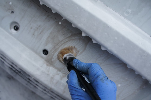

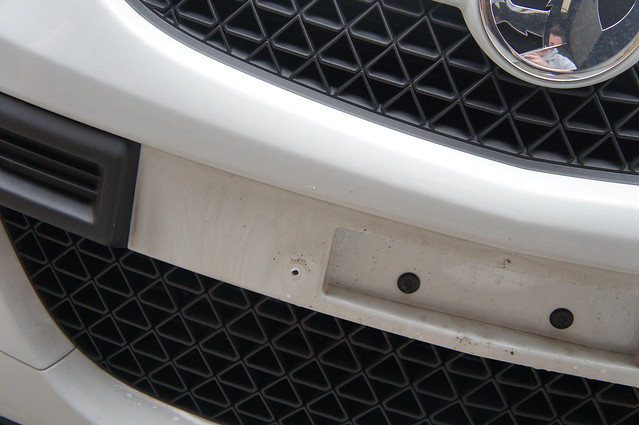

The stubborn dirt behind the number plates was worked specifically too:
DSC06381 by RussZS, on Flickr

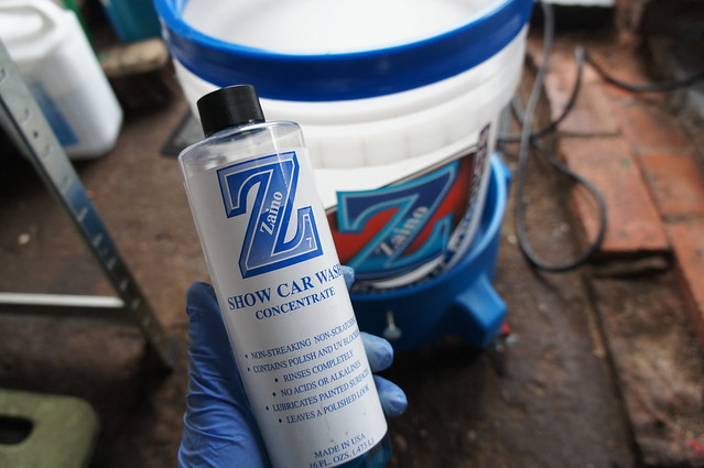

Next the Grime Out was pressure rinsed off and the car was hand washed with Zaino Z7, CarPro Wash Mitt and Zaino's excellent bucket system:
DSC06382 by RussZS, on Flickr

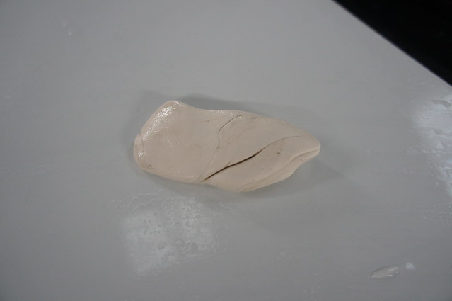

For the claying stage I used Auto Finesse's Soft Clay in conjunction with Valet Pro's Citrus Bling 16:1 as lube:
DSC06389 by RussZS, on Flickr
Not much left after IronX and Tardis had done their respective jobs so well!

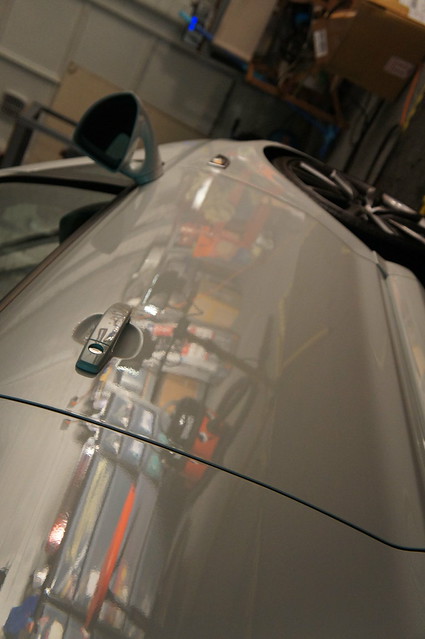

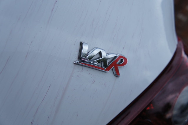

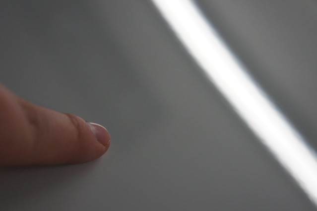

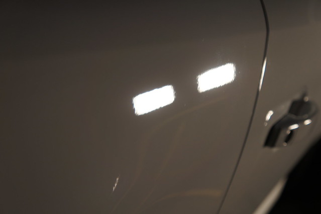

Surprisingly deep marks around the door handle:
DSC06391 by RussZS, on Flickr

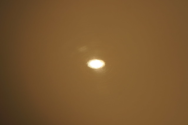

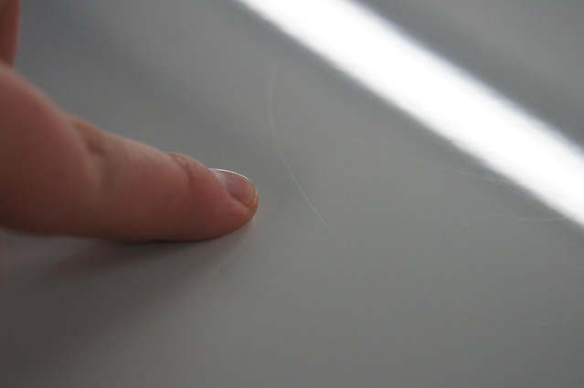

General swirling:
DSC06392 by RussZS, on Flickr
DSC06393 by RussZS, on Flickr

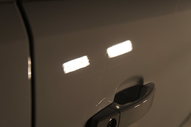

After trialling a few combos, I settled on the new Megs M101 Compound in conjunction with Festool Rotary and 3M Polishing Pads.
Some of the defects around the handle remained, but much improved:
DSC06394 by RussZS, on Flickr
DSC06397 by RussZS, on Flickr
DSC06399 by RussZS, on Flickr

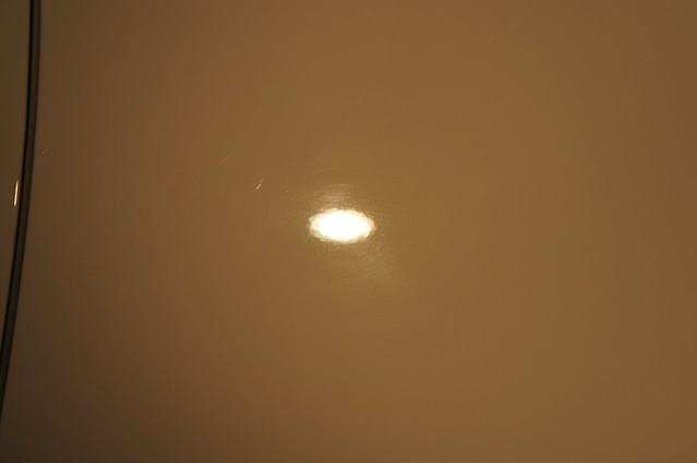

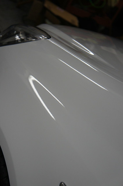

Deeper scratch on the bonnet given particular attention:
Before:
DSC06402 by RussZS, on Flickr

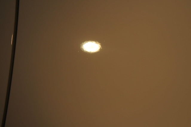

After:
DSC06403 by RussZS, on Flickr

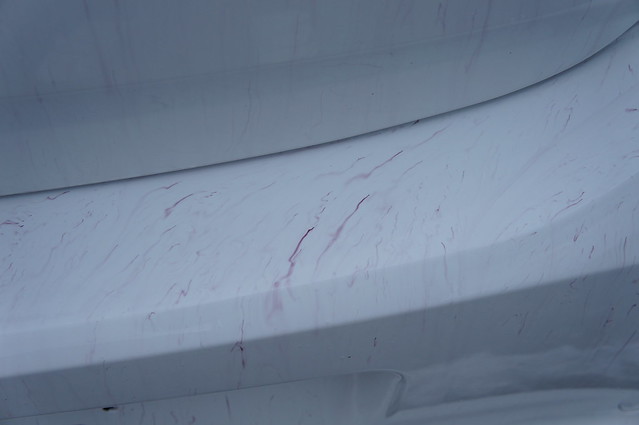

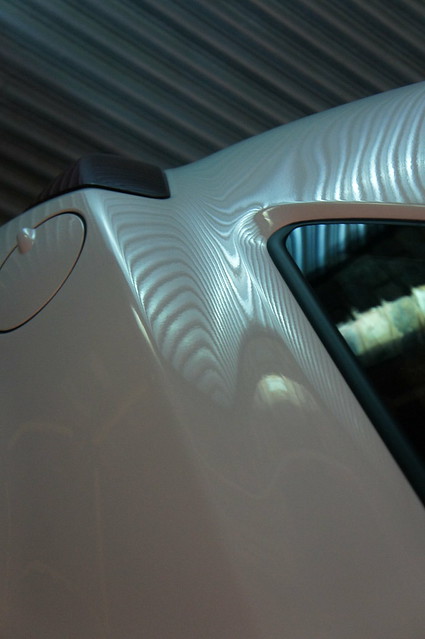

Quite severe swirling was found on the passenger side:
DSC06404 by RussZS, on Flickr
DSC06405 by RussZS, on Flickr
and after:
DSC06408 by RussZS, on Flickr
DSC06409 by RussZS, on Flickr

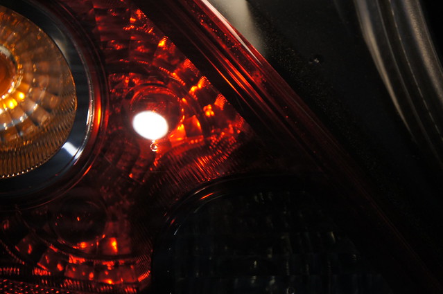

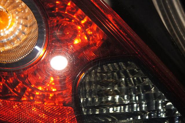

The lights were also quite heavily swirled:
DSC06414 by RussZS, on Flickr
After:
DSC06419 by RussZS, on Flickr

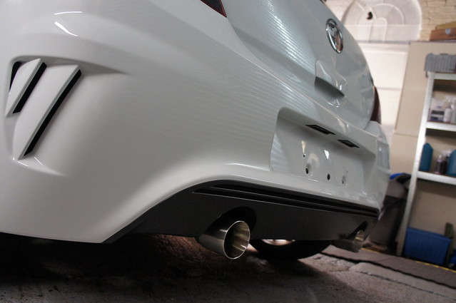

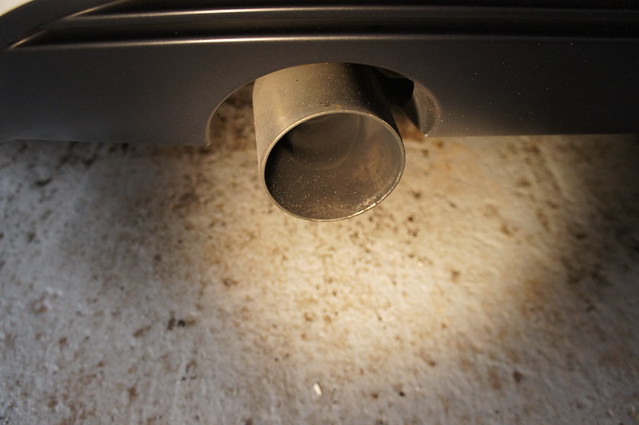

Auto Finesse Mercury on the exhaust...
DSC06421 by RussZS, on Flickr
Before:
DSC06422 by RussZS, on Flickr
After:
DSC06443 by RussZS, on Flickr

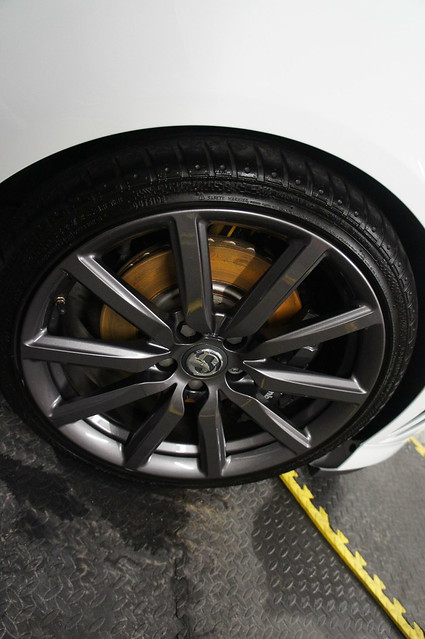

Mint Rims on the alloys:
DSC06429 by RussZS, on Flickr

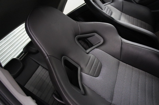

Z9 on the leather:
DSC06430 by RussZS, on Flickr

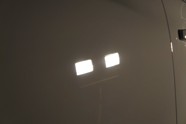

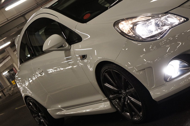

and finally Auto Finesse's Desire on the paintwork!
DSC06427 by RussZS, on Flickr

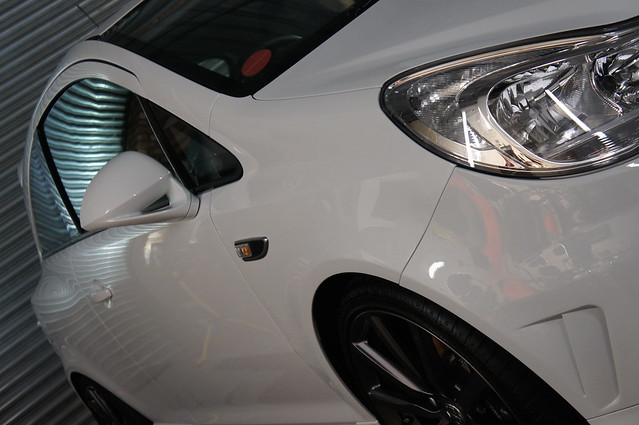

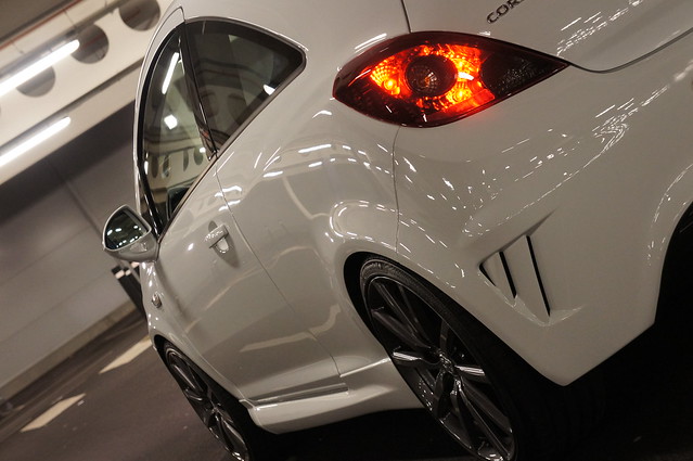

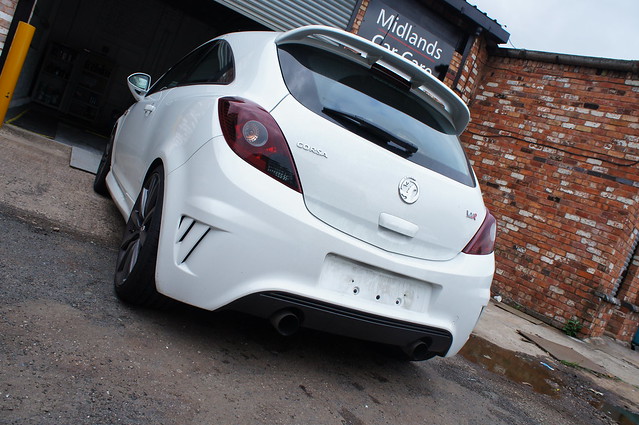

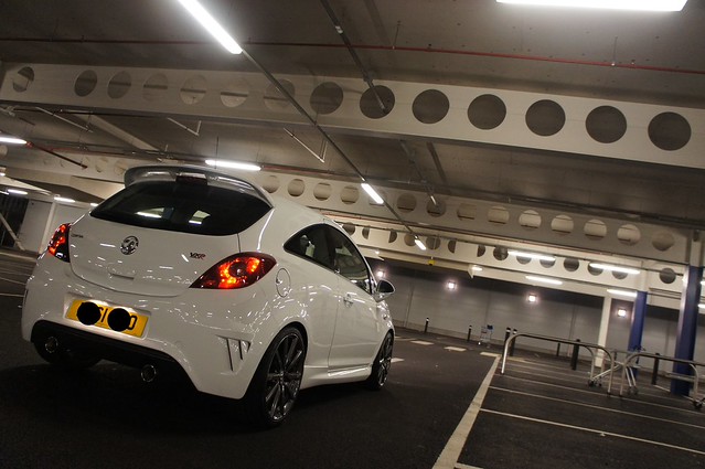

and finally, after 8 hours or so, some afters:
DSC06432 by RussZS, on Flickr
DSC06434 by RussZS, on Flickr
DSC06437 by RussZS, on Flickr
DSC06439 by RussZS, on Flickr
DSC06435 by RussZS, on Flickr
DSC06444 by RussZS, on Flickr
DSC06447 by RussZS, on Flickr
DSC06448 by RussZS, on Flickr
DSC06454 by RussZS, on Flickr
DSC06458 by RussZS, on Flickr
DSC06463 by RussZS, on Flickr
DSC06460 by RussZS, on Flickr
DSC06465 by RussZS, on Flickr
DSC06469 by RussZS, on Flickr
DSC06471 by RussZS, on Flickr
DSC06472 by RussZS, on Flickr
DSC06473 by RussZS, on Flickr
