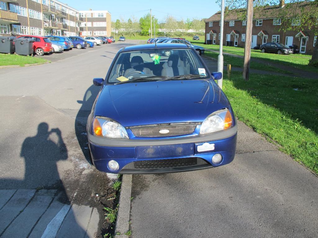

This car belongs to a friend in work. Every time i see it i've felt sorry for it as it was in a sad state as you can see from the pics. She has owned the car since she bought it new 12yrs ago and in that time it has only ever been put through a car wash to clean  :surprised:
So the car was dropped of and this was what i was up against.
Lovely Scratches
Swirl Central
Wheel condition
Engine bay
Interior
Car was then Pressure washed off to remove as much of the loose muck up the sides as possible and then the car was coated with AF Citrus Power

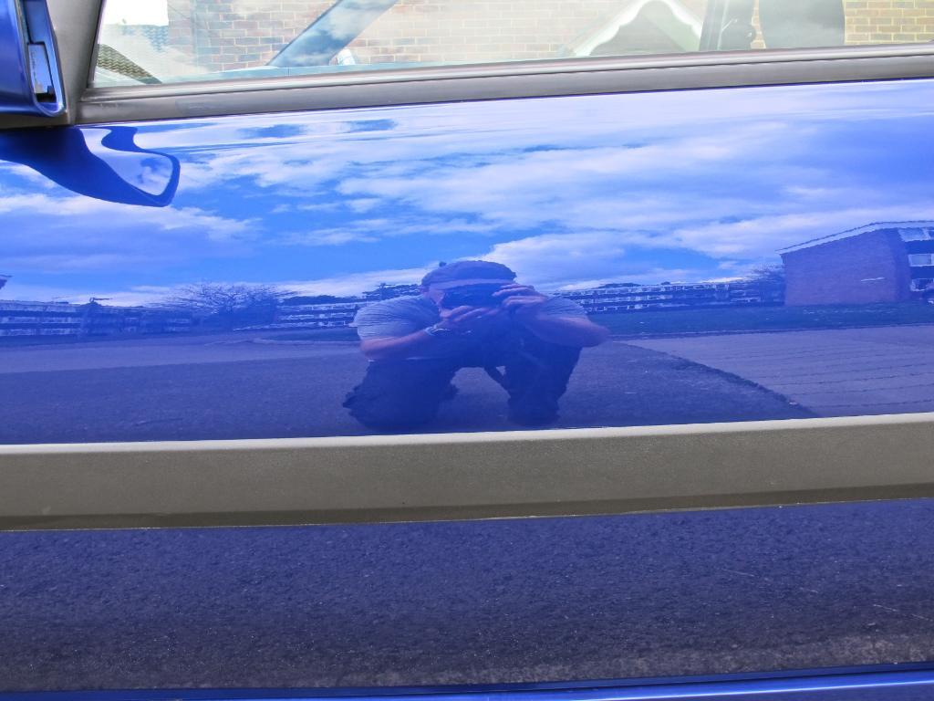

I tried various pad/polish combinations and found that a 3M Orange compounding pad and Menzerna S500 Fast Gloss gave a good level of correction.
50/50 front wing
50/50 Passenger door
So i went round the rest of the car. Once done i pressure washed the dust off, dried and i then went over the car again using a 3M Blue Finishing pad and Menzerna P085RD Final Finish

This is my favourite shot. As you can see i got all apart from the deepest part of the scratch out
