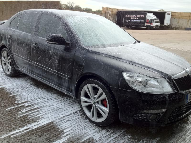

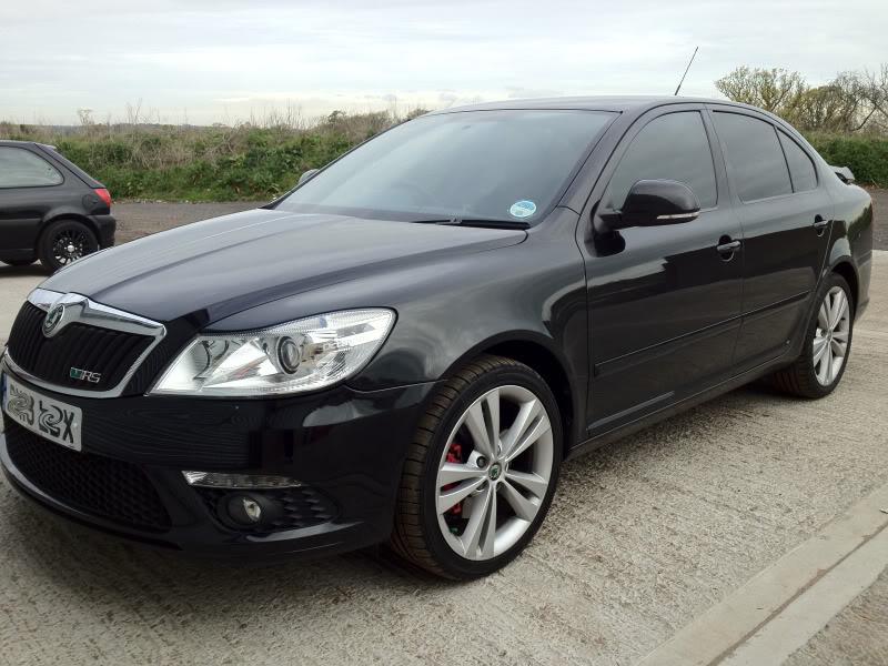

How the car looked on arrival:

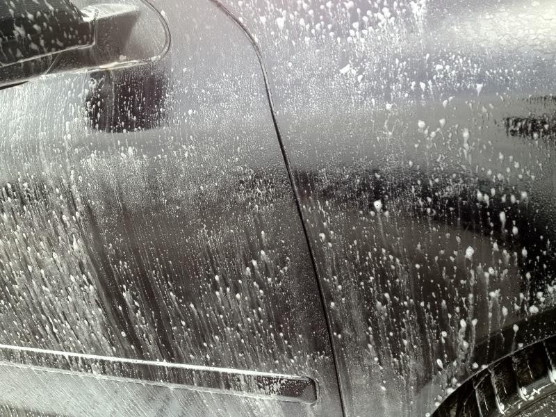

Quick shot of the wash stage, the car arrived having being recently clayed/decontaminated by the owner, so was fairly clean and required little in terms of wash/decontamination, only some light tar to remove.

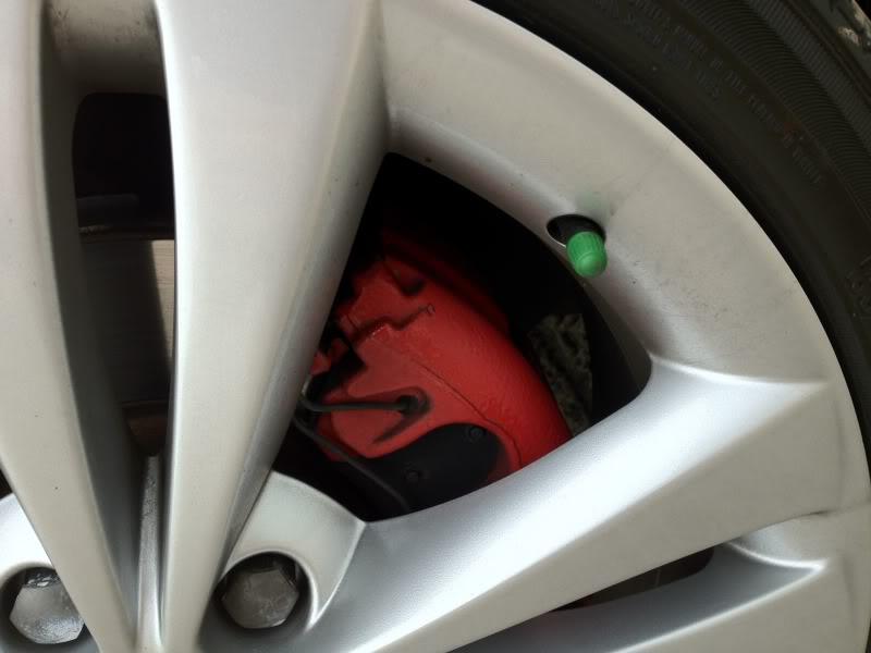

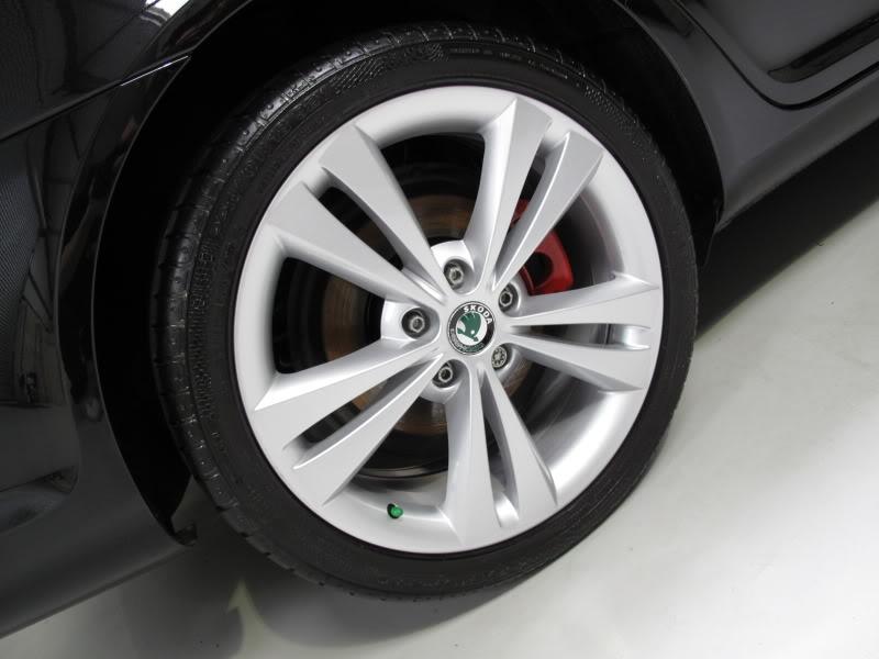

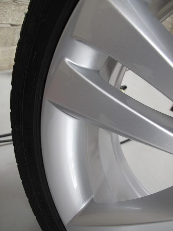

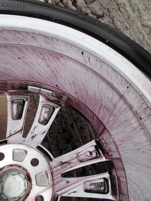

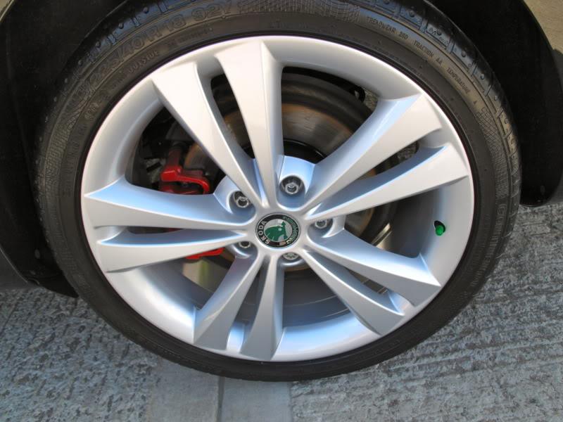

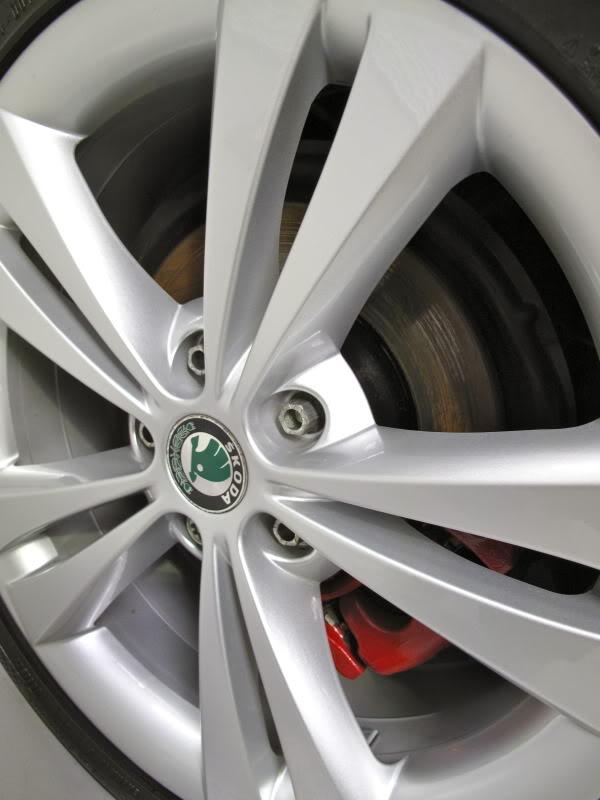

Wheels certainly benefitted from some decontamination! Cleaned with Smart Wheels, decontaminated with Iron X/Tardis. Polished then sealed with Auto Finesse Mint Rims. Tyres cleaned with G101 and dressed with Car Pro Perl.
Looking much fresher:

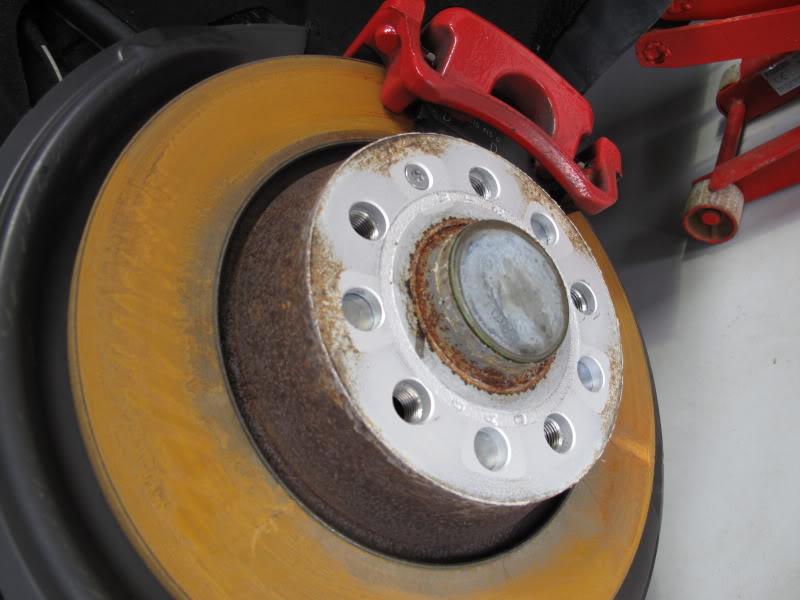

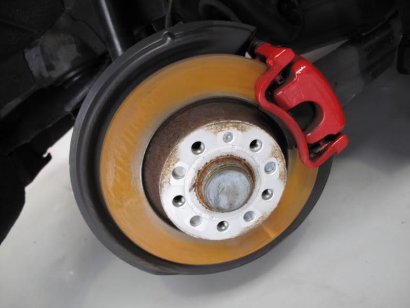

With the wheels complete, attention turned to the tired looking brake hubs/calipers. Calipers were cleaned up with G101, polished and sealed. Hubs were rubbed down to key and painted with heat resistant enamel in black. Finished pics with final result pictures.

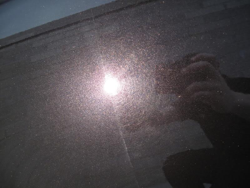

Once inside, dried off it was clear to see the problem we were dealing with!

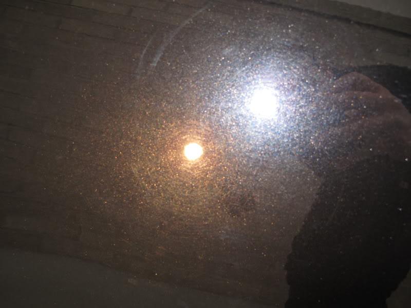

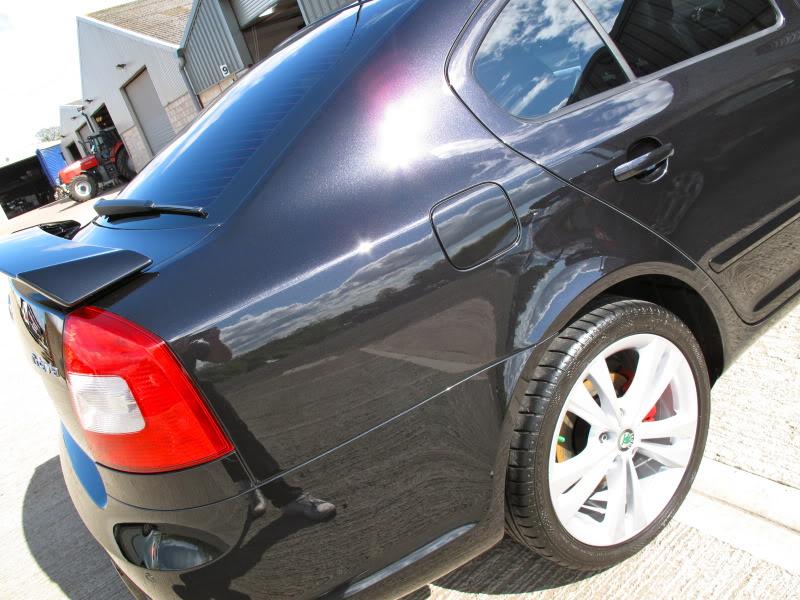

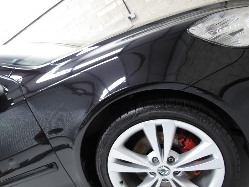

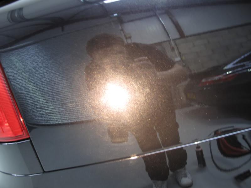

After various test combos, a combination of Scholl S17+ on a Yellow 3M pad, via rotary were used, alongside Meguiars DA Microfibre system for some areas.
Once correction had been achieved, finish was refined with Dodo Juice Lime Prime via 3M Yellow pad.

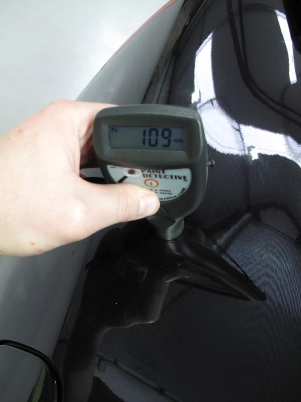

The car overall read pretty low in terms of paint thickness, average paint reading was around 120uM.

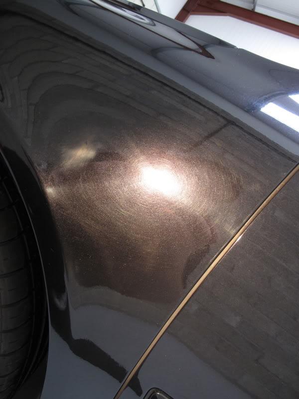

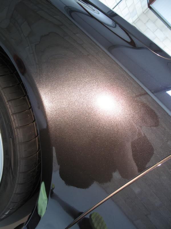

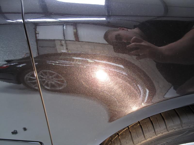

Some correction pics! Note these pics are prior to refinement.
Before:

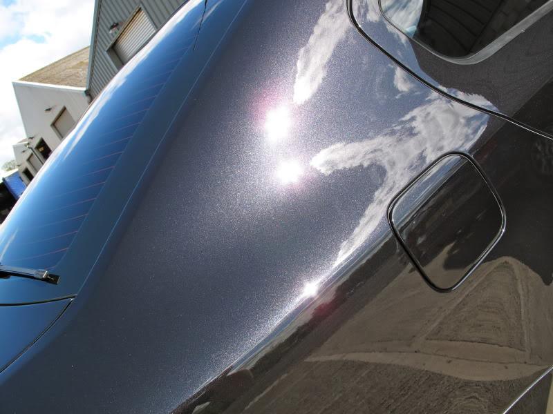

After:
50/50:

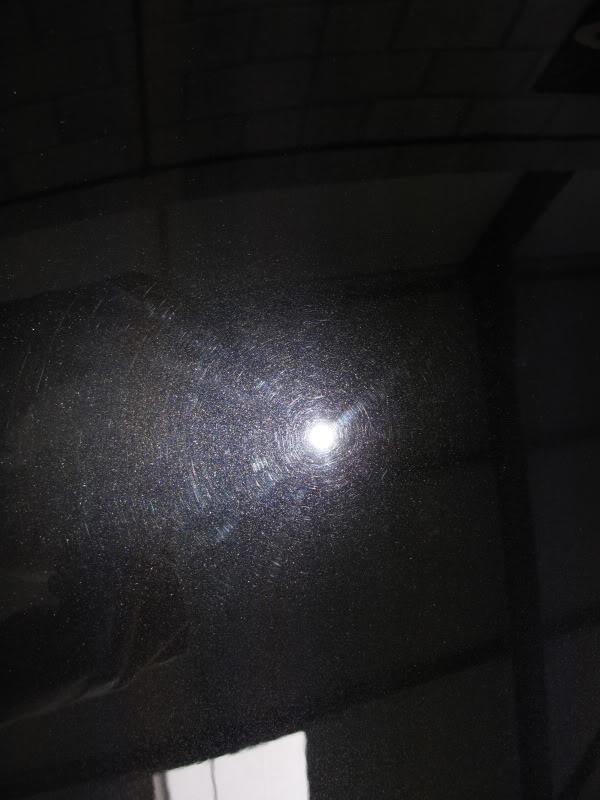

Before (LED not sun gun, it needed charging!):

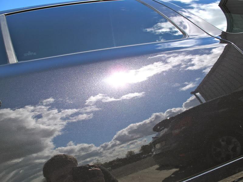

After:

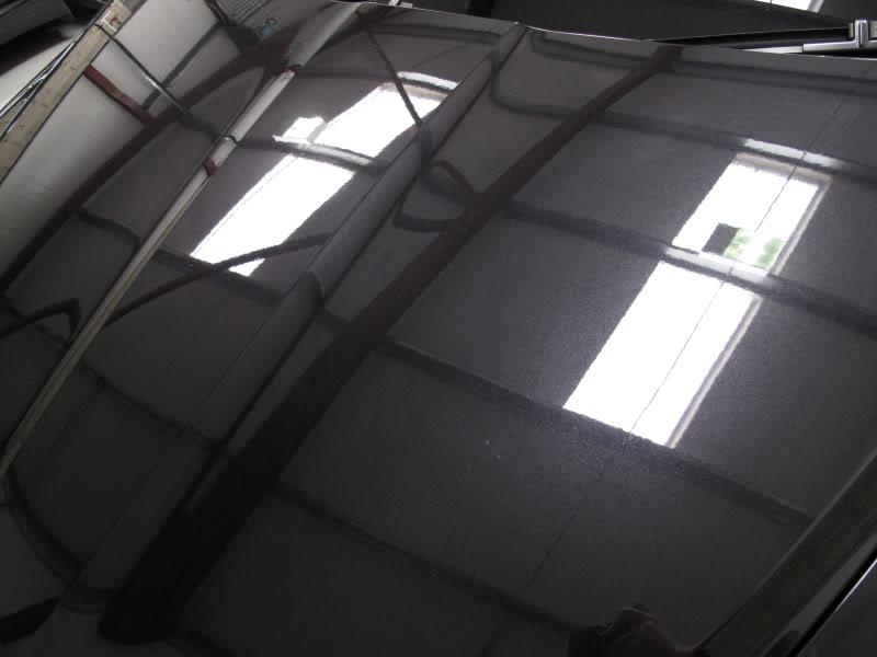

A few 50/50's:
Before:
After:

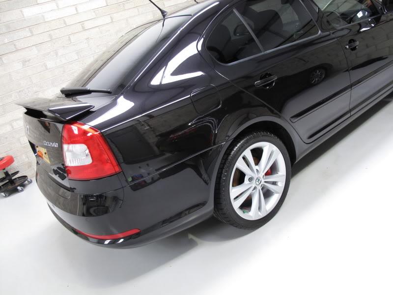

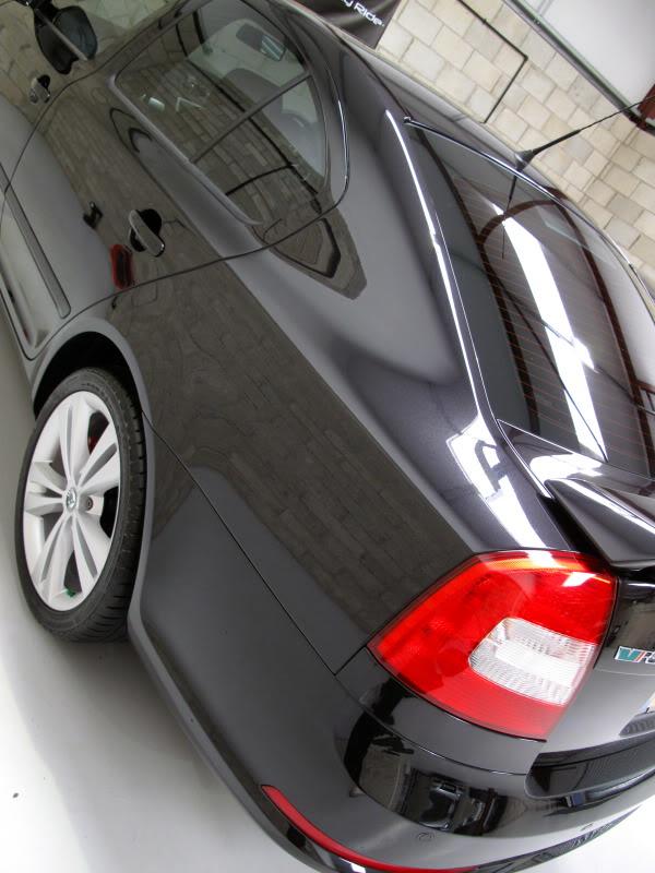

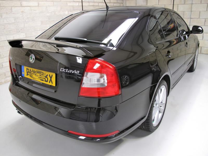

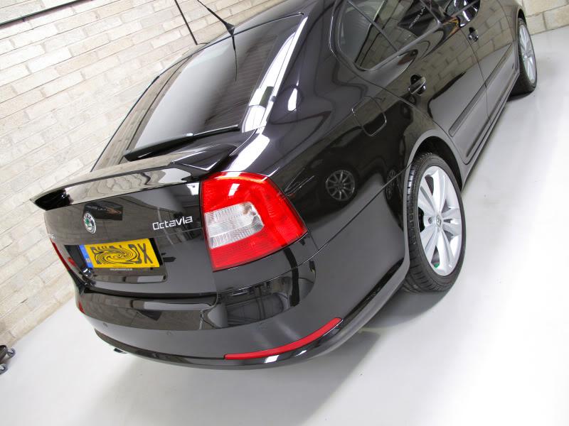

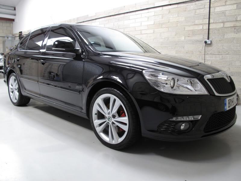

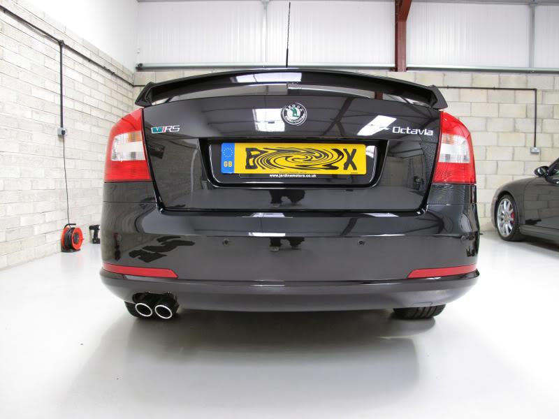

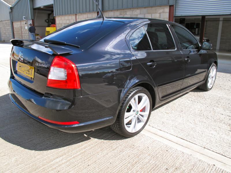

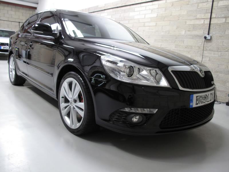

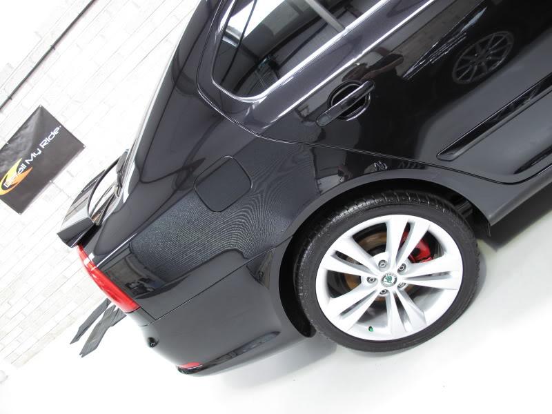

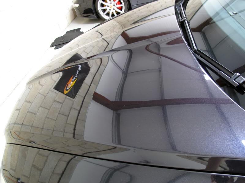

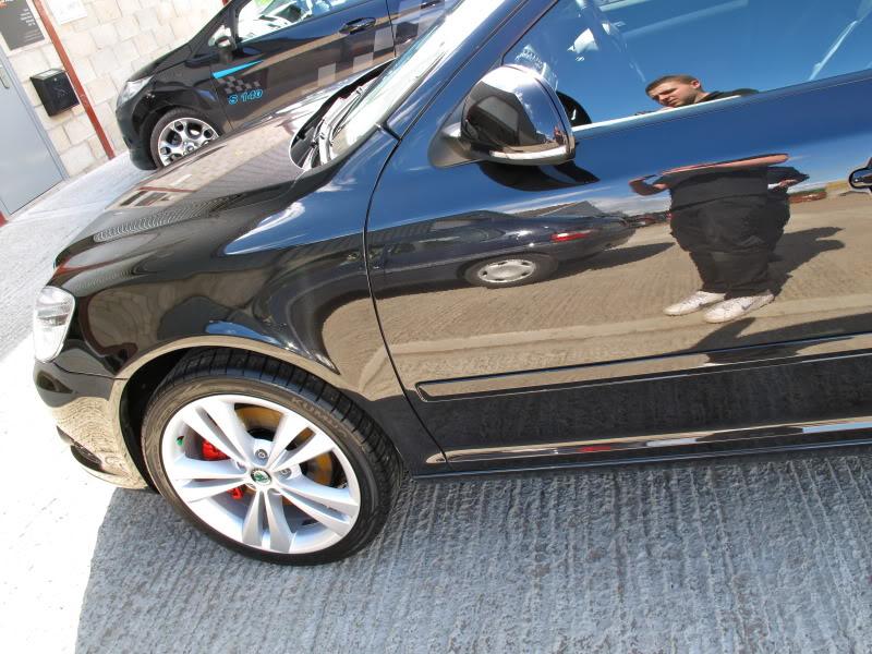

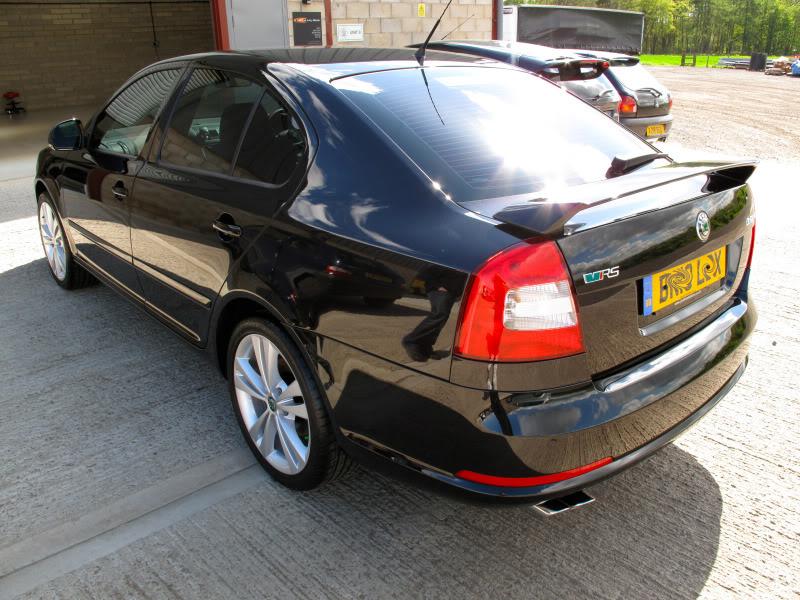

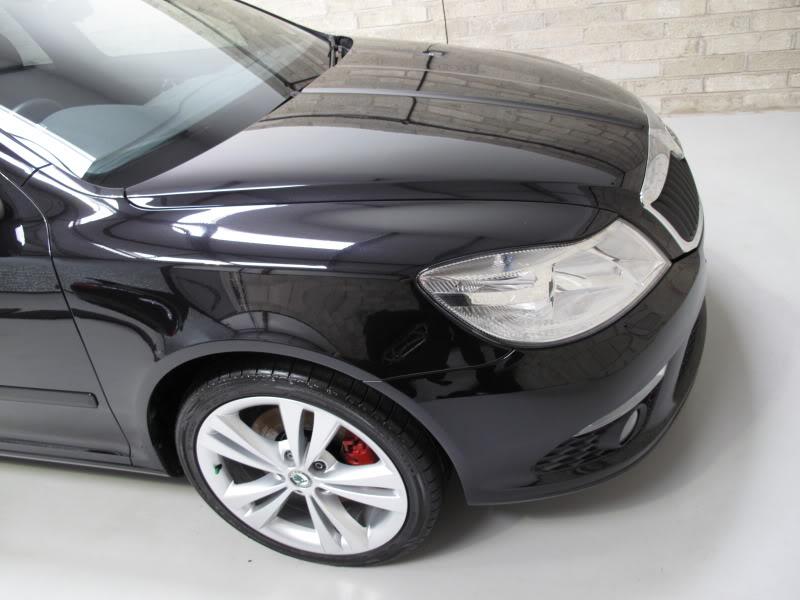

Finished! LSP used was Auto Finesse Tough Coat.
Thanks for looking! Comments/questions etc welcome!
