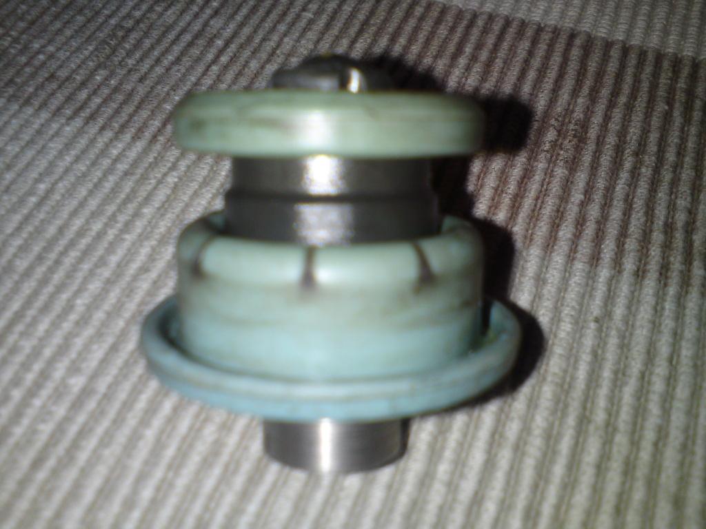

Took my 'B' version out this evening, has probably been on the car since 2005 as I am going to replace with 'G' version I bought last night.
Glad I did nice little rip:
No fault lights in car and as far as I knew car was running ok.
This picture shows black areas where rubber is breaking down and about to split:

At end of day A B C D E F G H I J K  ect.... are all going to fail at some point,  early ones quicker than the newer ones with tuned engines.   Just have a look at D valve and pull it apart you will see.
D valves dont break like the rubber desgins, but they are crap at the job the are meant to do.  The G valve seals very well but at end of the day its still a rubber version which could end up splitting.
The way I look at it is if the G valves last 2-3year and only cost £40 then in my eyes thats a good investement to keep changing it if it fails.
Totally agree :happy2:
The only concern I have is as far as I knew my car was running fine (no warning lights, car seemed to be pulling nicely, mpg was good) even though my 'B' version had split!
What should I be looking out for so I know when to change it next time?
 I only removed mine because I had seen no evidence of it ever being changed car is a 2005 Model Gti. Luckily I have a 'G' version on its way.  Should I always have a spare just in case?
