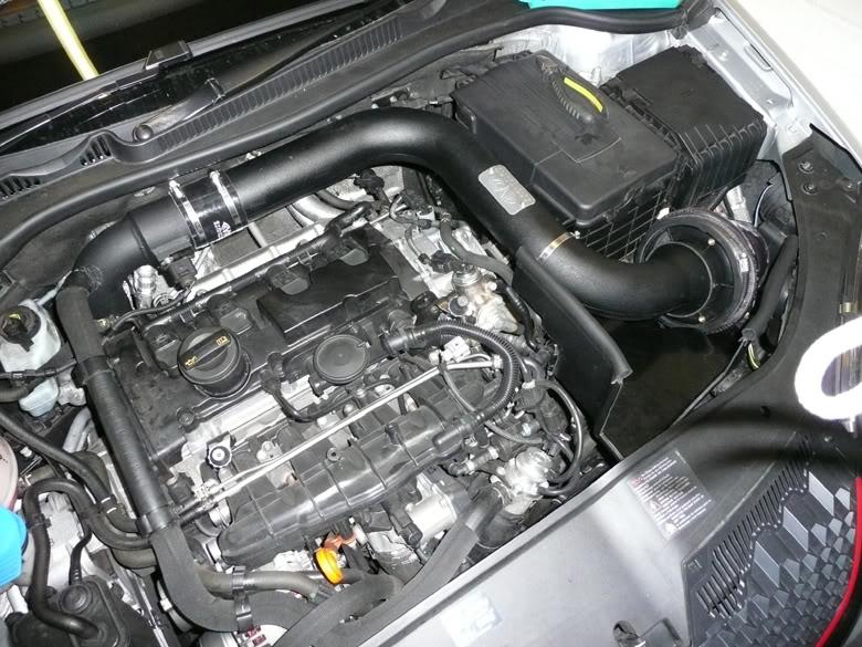

Yes, the one I've ordered is specific to the K04. Unfortunately for me, I have a few mods in the engine bay which get in the way of the EVOM's ...specifically
Part of the take-off for the Forge DV piping
My rear section of the aftermarket headlight housing encroached into the engine bay further than stock (Hacksaw FTW!!!)
Circuitry for the headlights and for the power cables to the amp and head unit were nestled in the gap for the EVOM's shield.
However, the good news is that I finished it this morning and so here is the completed article.
Took it out for a test drive and so far no CEL. :happy2:
Talk about an induction noise and turbo chatter on the overrun :jumping:
I totally agree when they say it sounds like Darth Vader under your bonnet :laugh:
The test run revealed that the take off is a little less hectic - so some torque has gone at the lower end?!?
Also revealed that the top end is even more frenetic - There is an extra surge towards the redline that wasn't quite as pronounced as before - even better when added to the higher redline change-up......STEVE PG :wink: :wink:

Looking good mate. :happy2:
Do you still have the original intake thingy that sits at the front as it looks a little strange without one?
Not sure if there are any positives or negatives with it but I thought it made it slightly more airtight from when I had one on my Octavia.
I was a little suprised about the loss of torque as well, perhaps it just goes on for so long now its not so noticable. :laugh:
