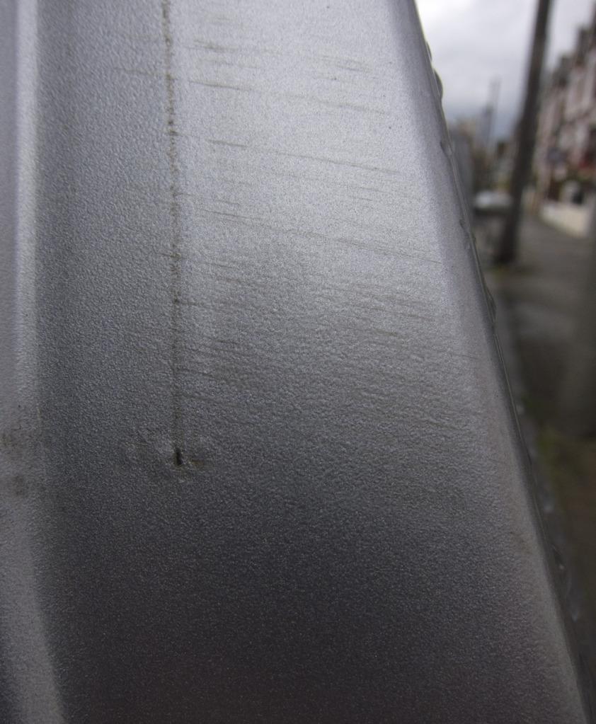

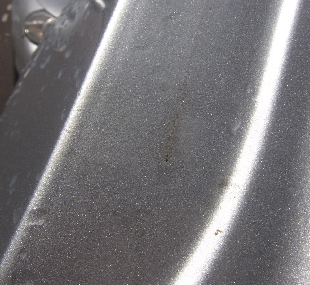

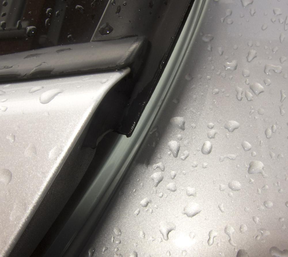

My 5 door Edition 30 has small rust spots on exactly the same place on both rear door shuts.  They are definitely caused by the hard rubber trim attached to the rear door repeatedly scraping across the painted shut area and the sharp end causing micro abrasion to a specific area as the car is being driven which has caused the paint surface to be broken and lead to the rust spots.
Anyone else had this problem?

I've just had a look on ELSAWIN and this problem is documented on there, the official fix is as follows:
Customer statement / workshop findings
Scratches (see illustration 1, red arrows) in the inner side panel on the C pillar - only vehicles with 4 doors.
Illustration 1
Technical background
Dirt particles in the sealing lip of the window guide rub on the paint of the C pillar when opening and closing the door.
This complaint may recur after the chassis break(10.2004) - caused by very unfavourable or incorrect adjustment of the door.
Production change
Better contact of the window guide to the side panel.
From Chassis No.:
 1K5W127000
 1K5B068000
 1K5P042000
 1K5D009000
Measure
• Perform the following procedure on the left and right side:
• Remove scratches:
• Polish or paint, depending on the degree of the damage.
• If painting is necessary, only spot-paint the affected area.
Protect the areas by sticking PU foil part number: 1K4 809 387 on the contact area of the window guides. Part number 1K4 809 387 includes the foil for the left and right side.
