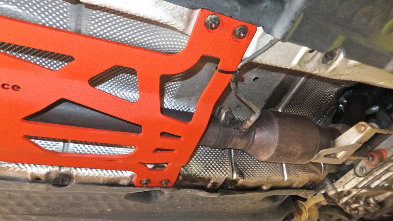

What is the difference between a Turbo Back exhaust and a Cat Back exhaust?
Am I right in saying that if I go for this package with a Cat back exhaust, when I go to Stage 2 I will need a decat downpipe or a sportscat downpipe, with the former meaning an MOT failure?
If I have a turbo Back exhaust, do I need a decat downpipe for Stage 2?
Has anyone got a diagram of both options?  :confused: :confused: :confused:

A turbo back exhaust will include either a sport cat or de-cat :happy2:
Re: Cat-back Milltek or Decat back?
« Reply #13 on: June 18, 2012, 07:55:17 am »
....No, with a Turbo Back Exhaust (often abbreviated to 'TBE') you don't need a decat for Stage 2.
A TBE is the whole system without keeping the OEM downpipe. In other words, A Cat-Back piping runs back from the Cat, and a Turbo-Back piping runs back from the Turbo.
Personally, I think that unless you've got a workshop etc and are used to doing car mechanics, the hassle for Cat swopping for MOT simply isn't worth it. Especially as exhausts aren't always the easiest to remove and fit after zillions of hot and cold cycles. Also, if you fit it yourself how does this effect your warranty?
