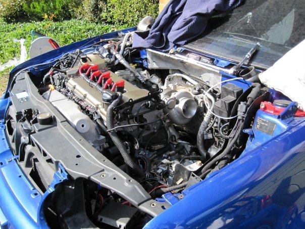

Not without a change of bellhousing, as the R32 engine is canted forward.
The picture below shows a Mk5 r32 engine fitted in a Mk4 (friend's car). Note the space between bulkhead and engine due to the canting of the engine, by comparison the tfsi leans rearwards, and the bellhousing shape and bolt holes locations are accordingly different.
« Last Edit: June 20, 2012, 06:19:20 pm by alackofspeed »

And to answer your question Pov, The TFSI will not fit the R32 gearbox.

What about the s3 dsg box
Offline DanGB
  • Posts: 640
  • Different
Re: R32 DSG, 2.0tfsi engine conversion
« Reply #14 on: June 21, 2012, 11:04:41 am »
That should fit to any TFSI yes.
