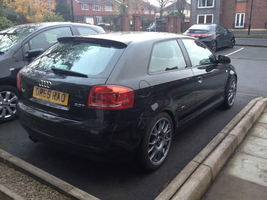

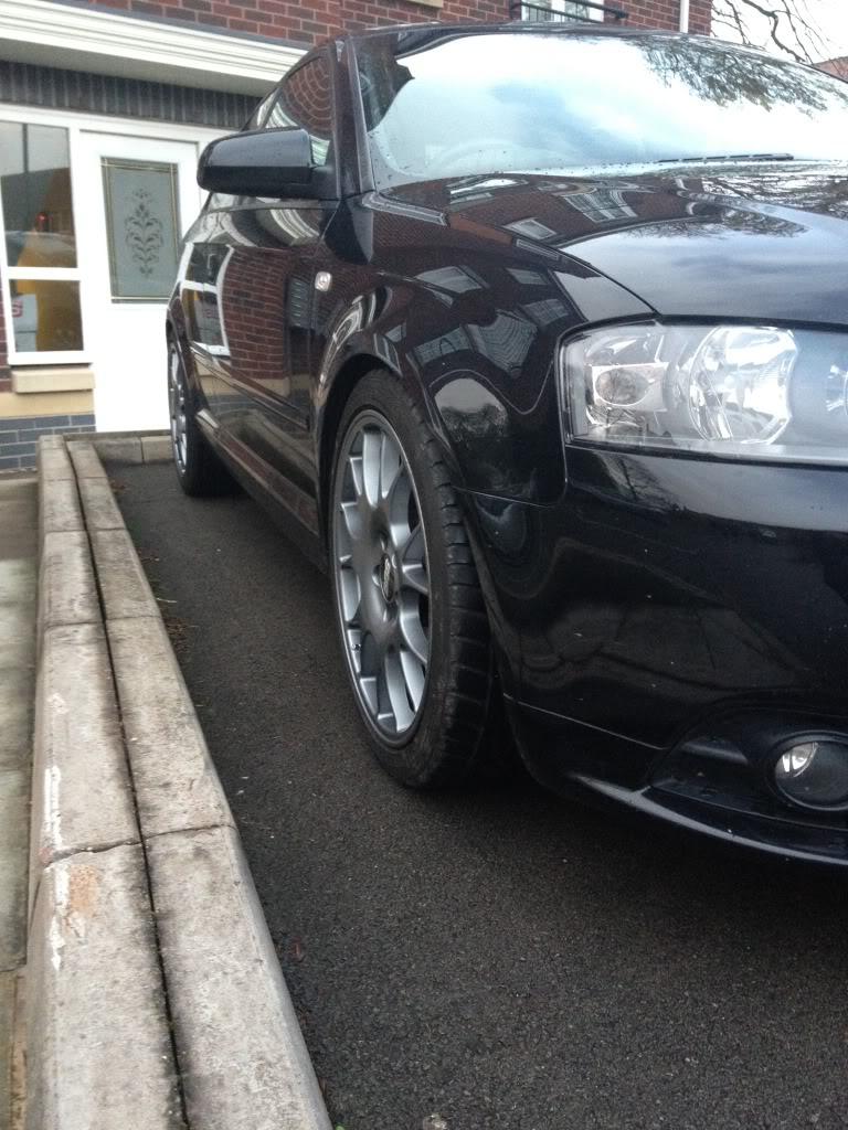

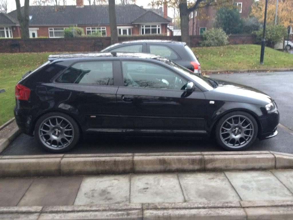

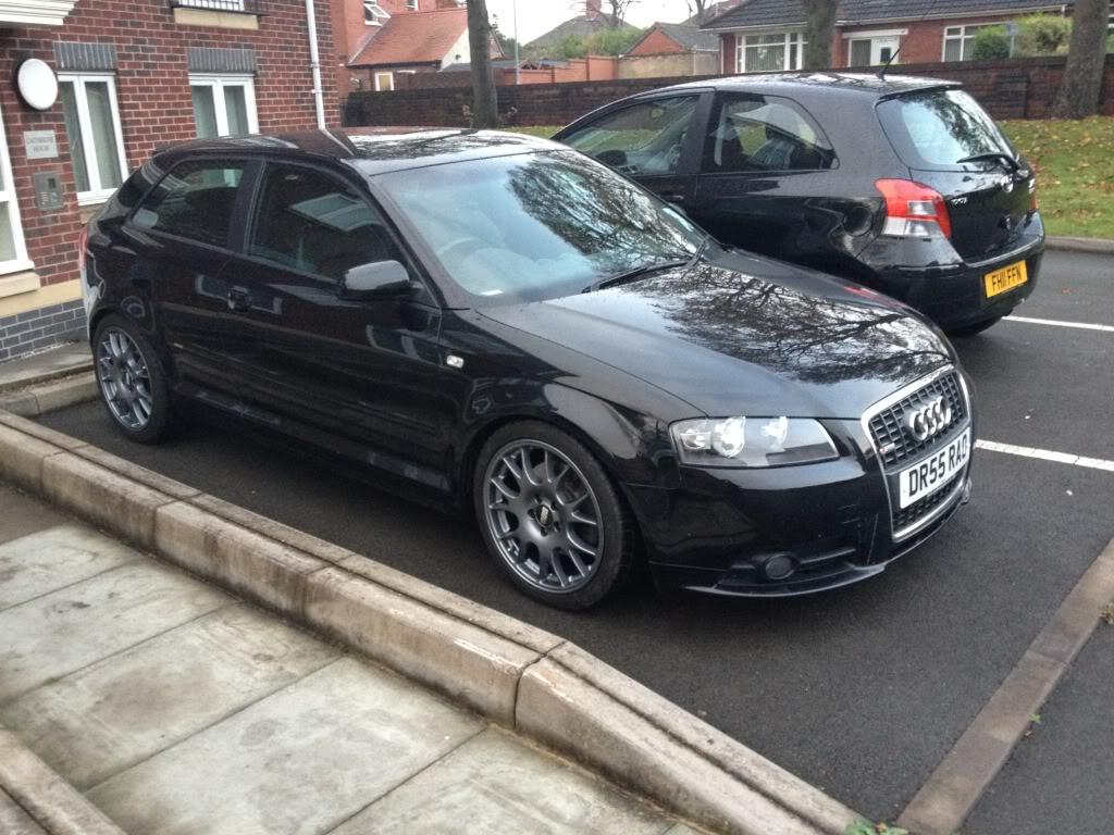

here's some shots of my car on BBS VZs (part of the CH family - now discontinued). i know it's an A3 but you get the idea. the spec is 18x8 ET44 with 225/40 as Audi intended. my car is also lowered on the Weitec Hicon GT coilovers. no rubbing issues unless i'm running 3 up or more:
Pescaras are 18x7.5 ET51. this means that to get them looking like my wheel, you'd need to run a 13mm spacer
