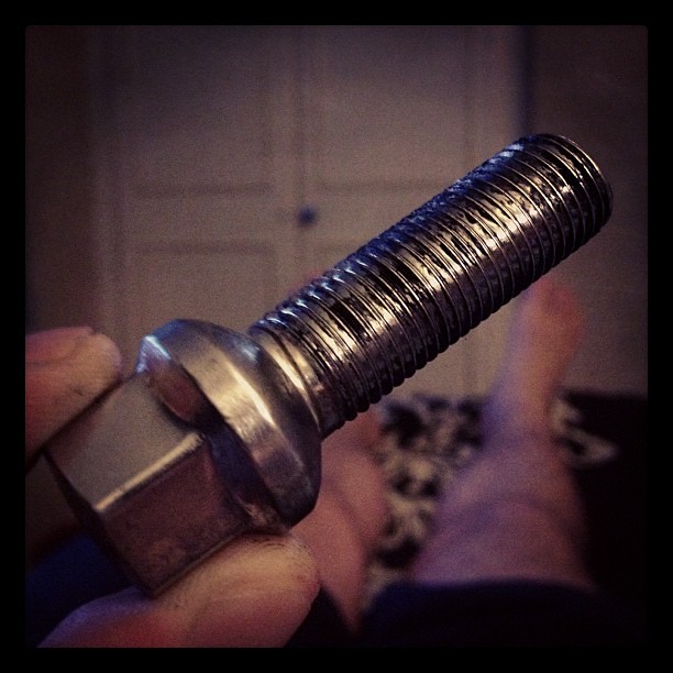

Why are you lying on your bed with a wheel bolt?! :chicken: :signLOL:
