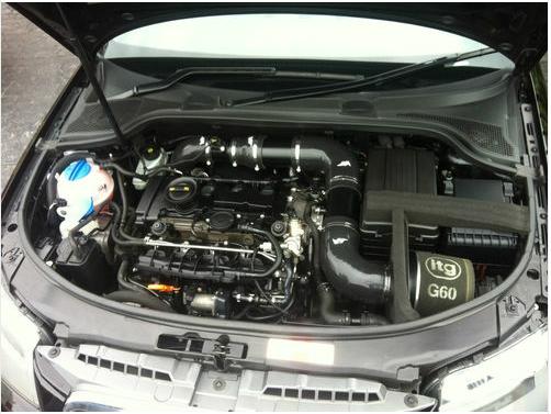

The original ITG intake (shown on an A3 2.0tfsi)

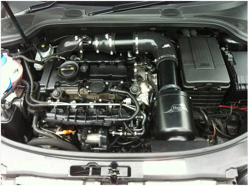

The revised / enclosed intake (again shown on a A3 2.0tfsi)

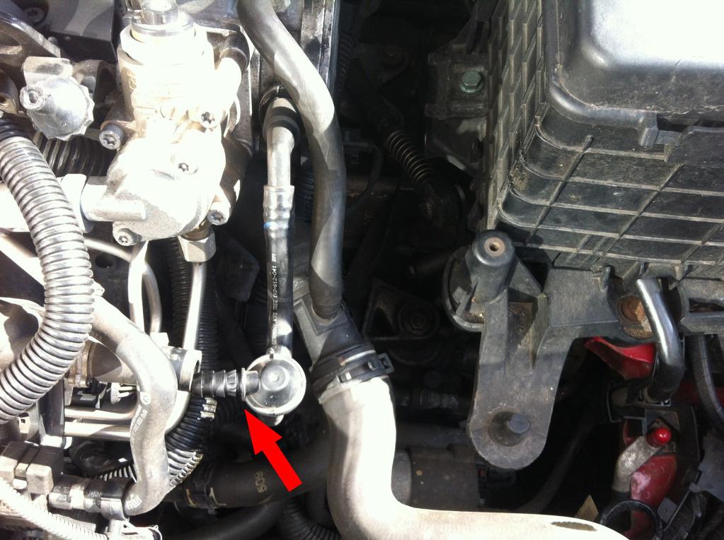

If you already have an ITG fitted you can remove the filter, the front 90 degree elbow hose and the extension pipe that is screwed to the engine block. These are not used in the new kit.

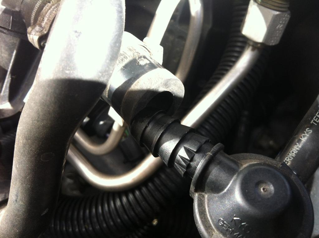

First you need find the hose and valve shown here. Remove the hose clip and pull out the valve and shorten the hose by approx 10mm. then push the valve back in and re do up the hose clip

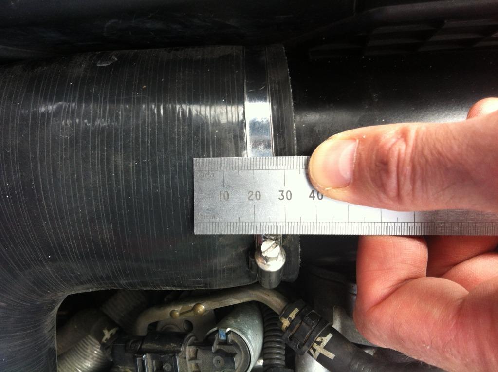

Then fit the slam panel attachment in place and then slide the filter canister into the hose and then bring it forwards into the slam panel attachment (I have not yet got the correct slam panel part so no photos of this bit yet. This is just theory and I will amend this part once I have it fitted.
Aim to fit a good 30mm+ of the canister pipe into the rear hose
Then use the supplied strap over the canister pipe to hold it in place
