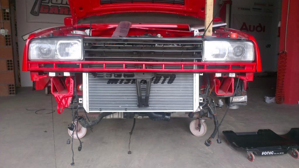

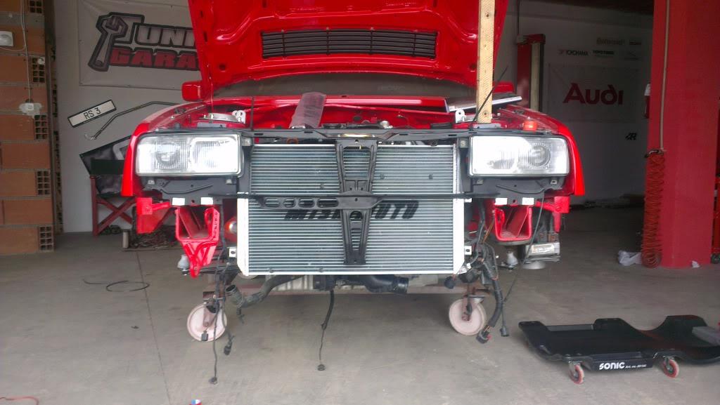

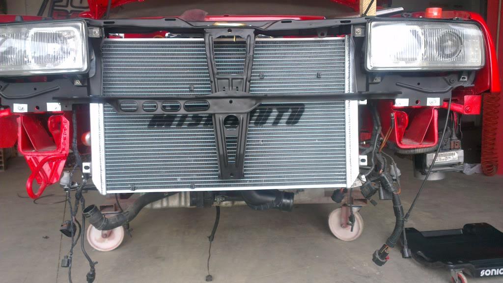

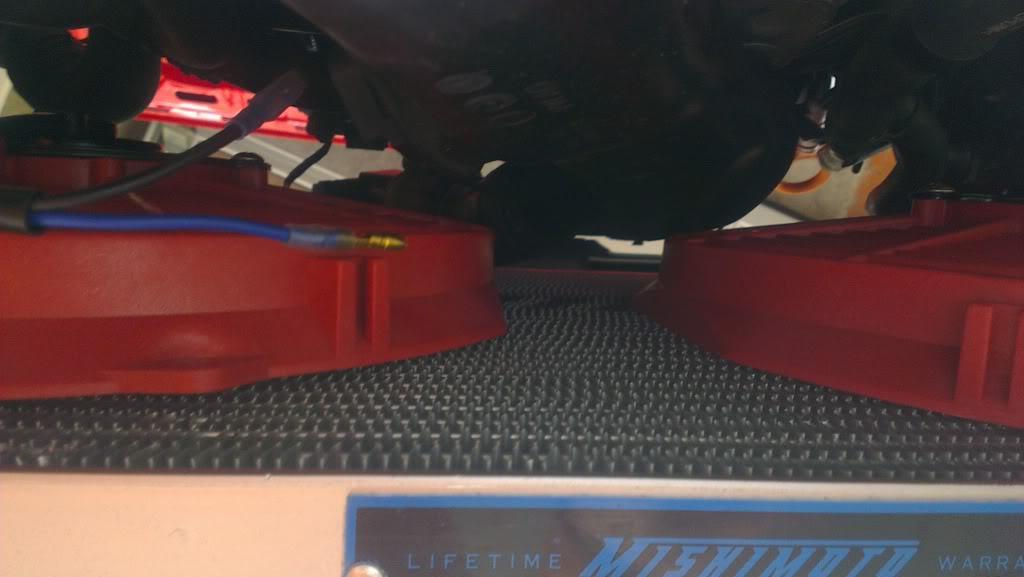

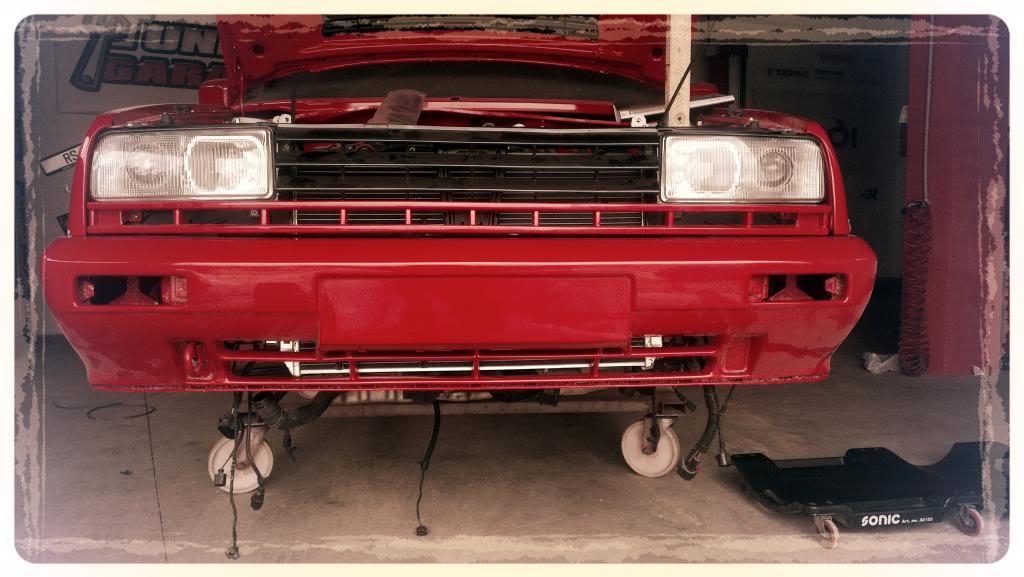

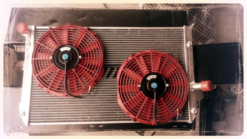

Today I got to completing the front end of the car.
I took the water rad and fans and installed them ...
but no space for the IC  :sad:
so now the question is ... do I cut a perfectly good Rallye bumper and install an Air to Air IC, or I buy a water to air IC and get it in here ...
Any advice  :confused:
Offline DaveB@Vagbremtechnic
  • Trader - 2014
  • -Receive: 130
  • Posts: 1315
    • Vagbremtechnic.com
Re: Golf Rallye 2.0 TFSI + Haldex 2gen
« Reply #138 on: February 17, 2013, 04:46:29 pm »
Somebody somewhere will do a chargecooler kit for a mk2. More efficient than an Ic in many cases
I hope so  :happy2:
I'm looking in to that as we speak  :smiley: There are a lot of interesting solutions  :happy2:

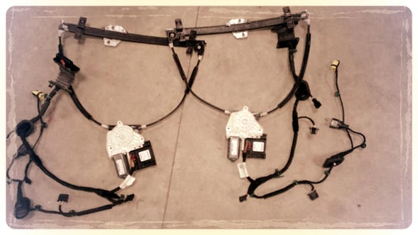

« Reply #144 on: February 21, 2013, 09:54:16 am »
OK the Mishimoto is going out and for sale  :wink: and I will be getting an Alloy 2 row MK2 water rad and thinking of going with the Forge TT RS IC.
I hope I can mount them one on top of the other and get that done  :laugh:
In the meantime i made a great progress... managed to get the MK5 power windows motors to work in the Rallye manual window rail's :drinking:
Again great help from my friend Mario Bacher  :notworthy:

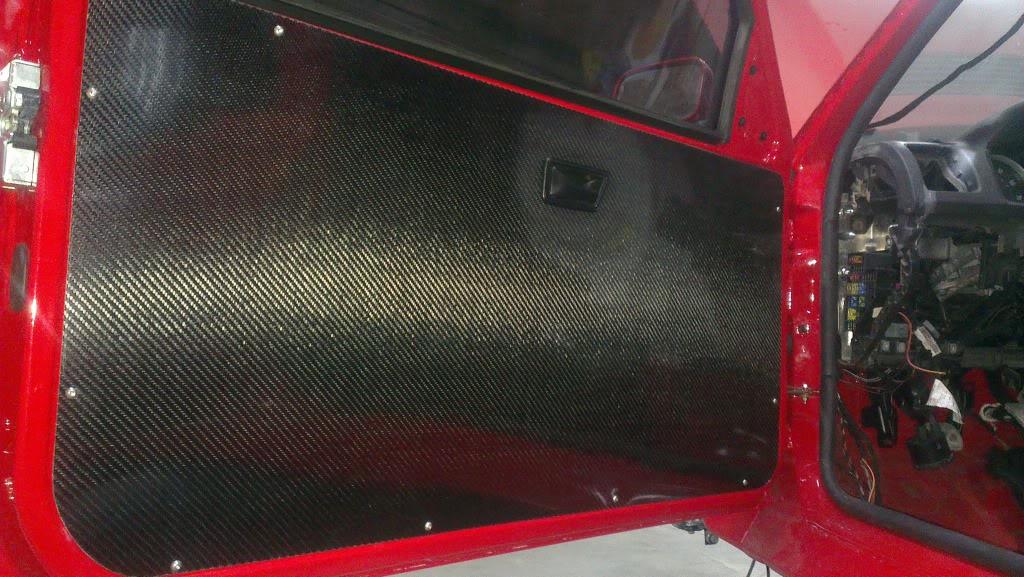

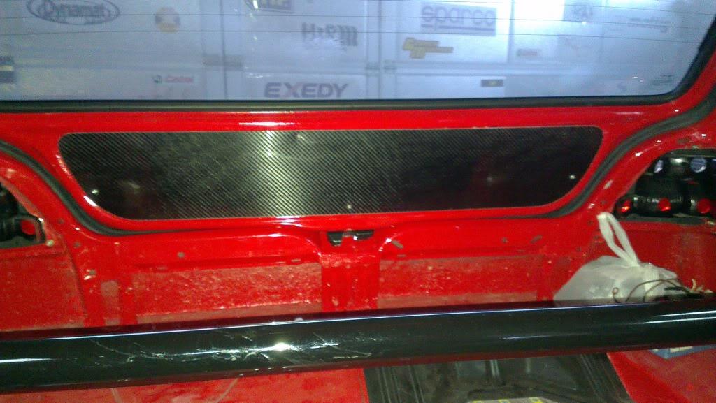

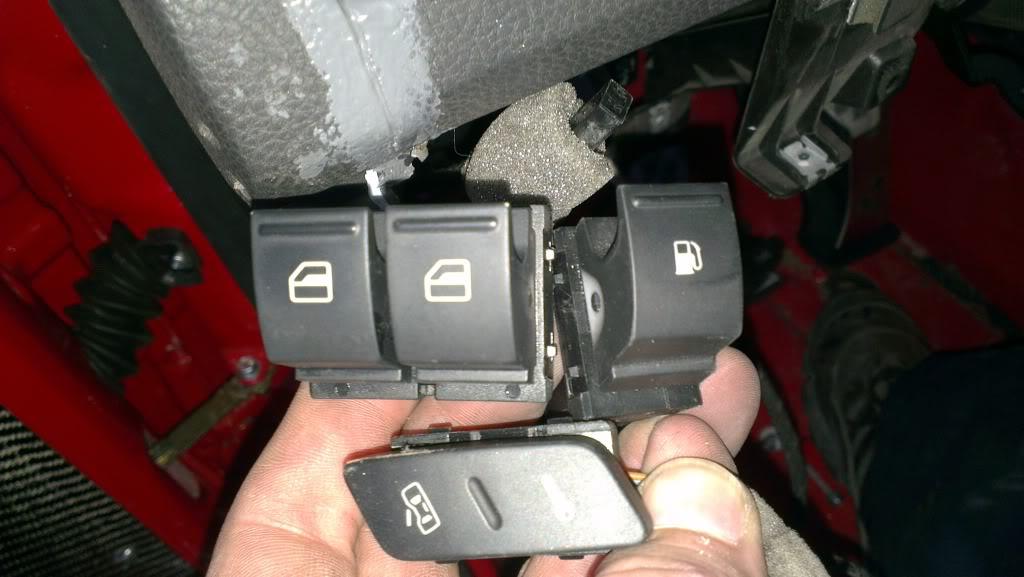

« Reply #147 on: March 10, 2013, 06:38:53 pm »

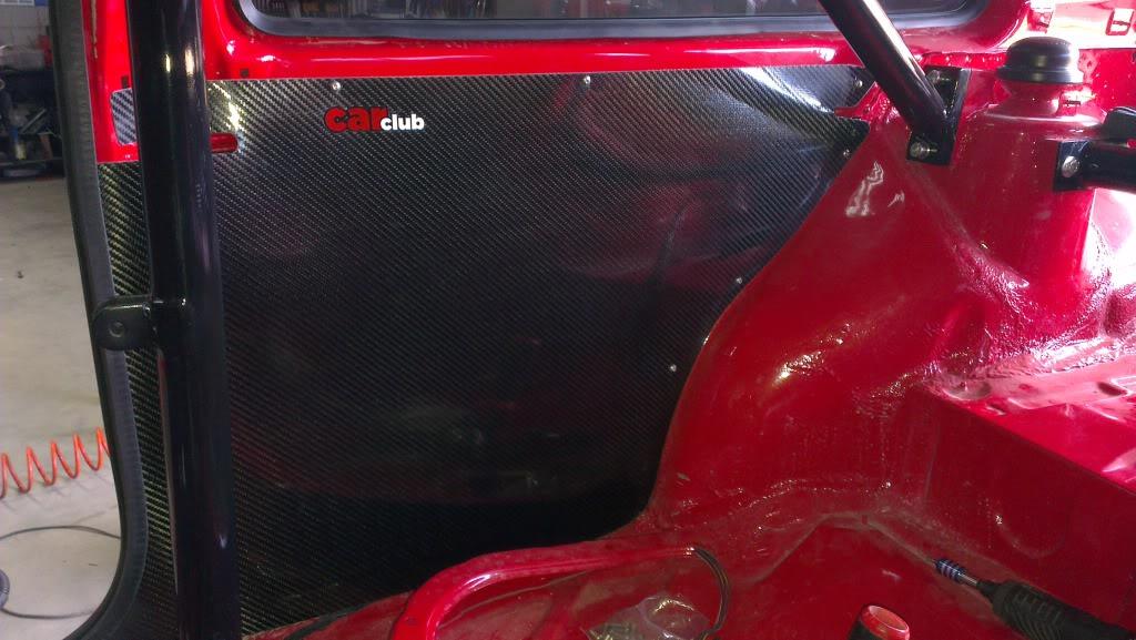

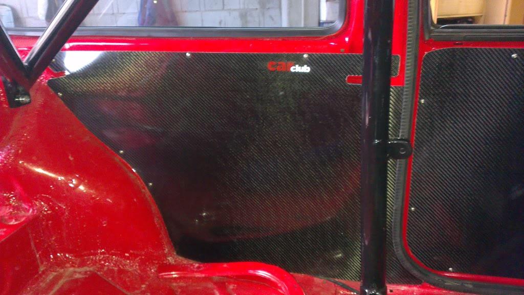

Mounted the power window motors and rails, everything wired up (Lock,Unlock,windows UP&down and tailgate release )
and then the Carbon panels  :laugh:
