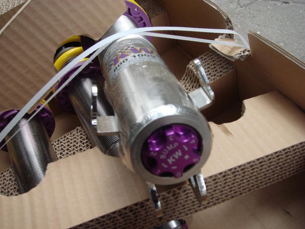

Thanks guys  :happy2:

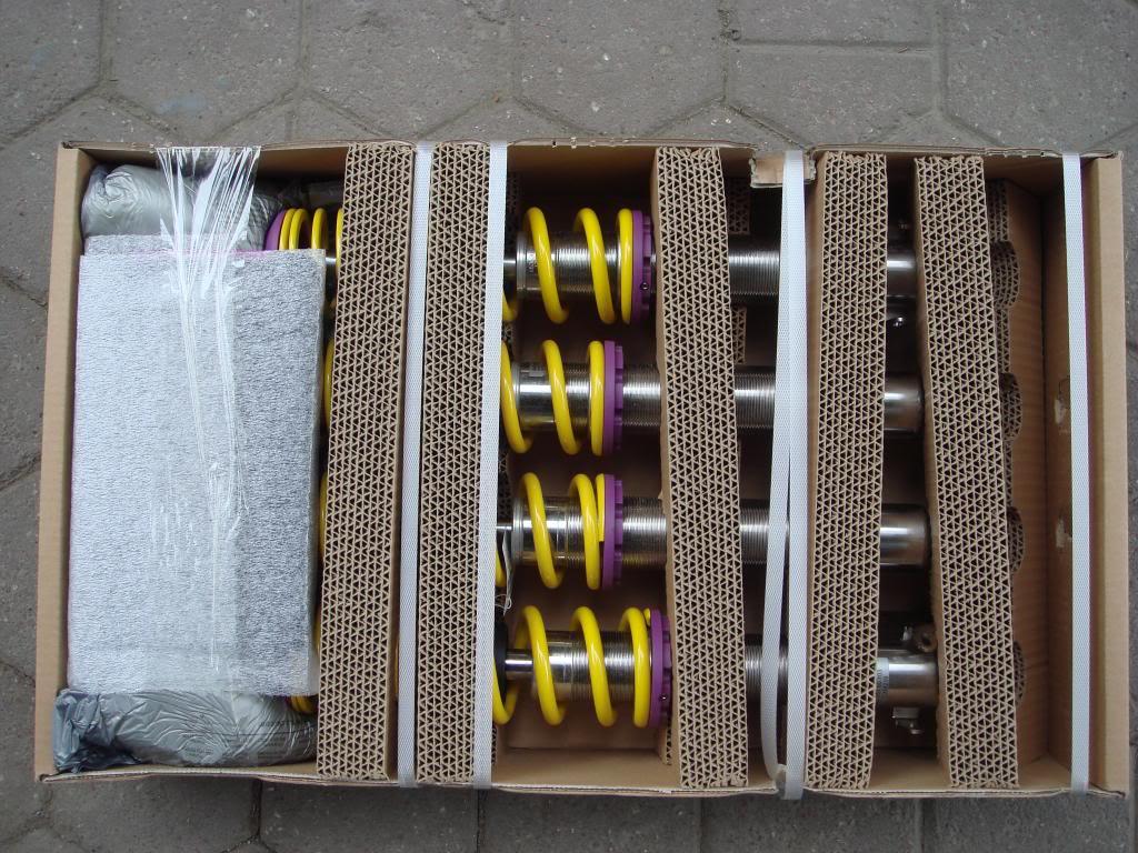

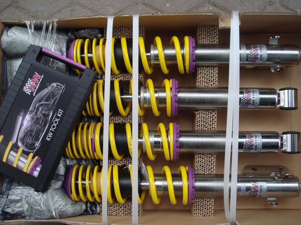

Arrived the ...
and got to work

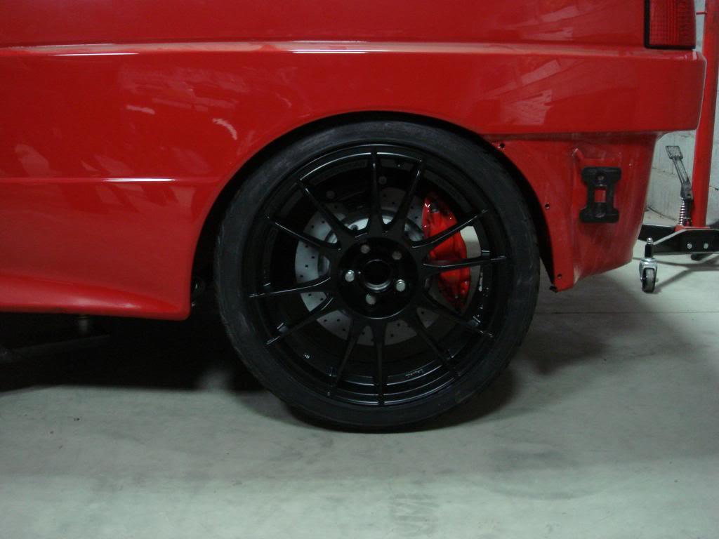

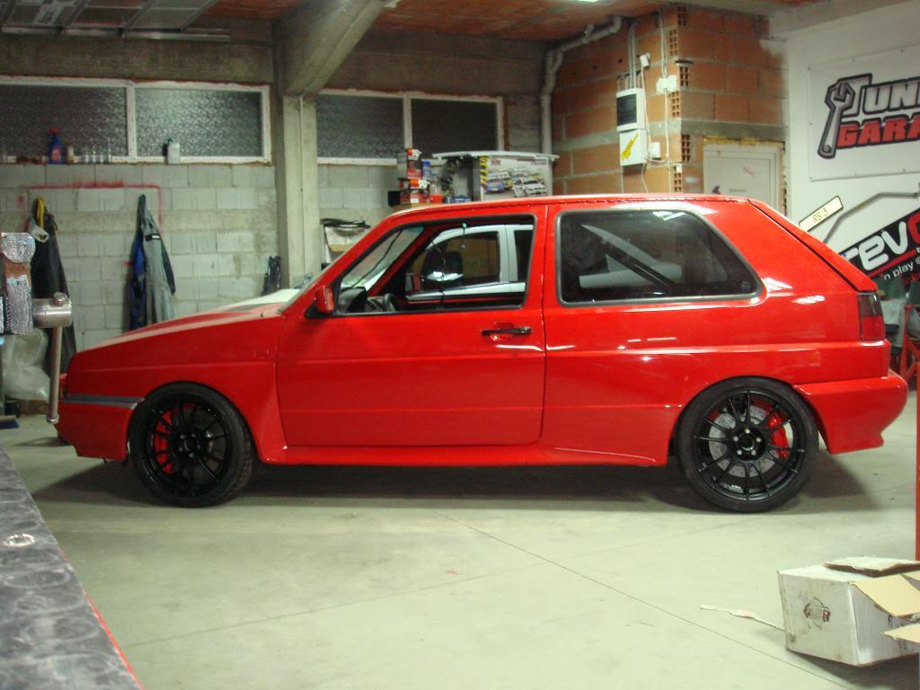

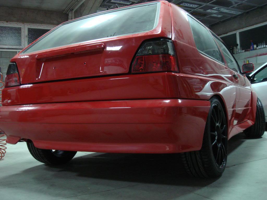

« Reply #171 on: April 10, 2013, 07:52:19 am »

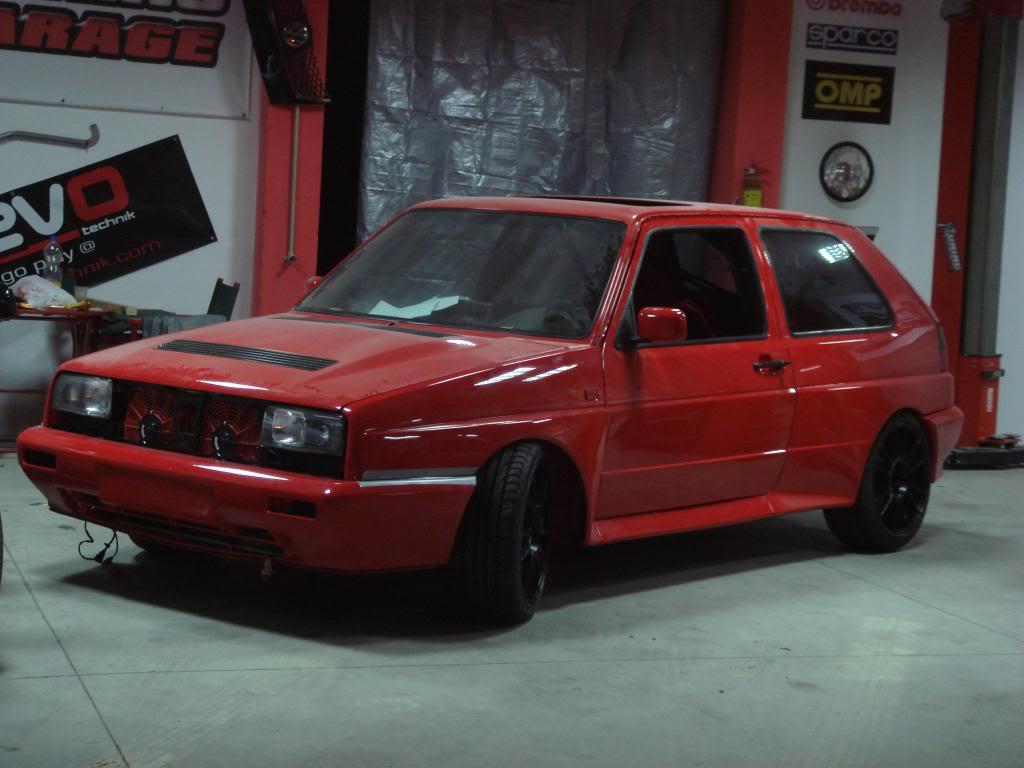

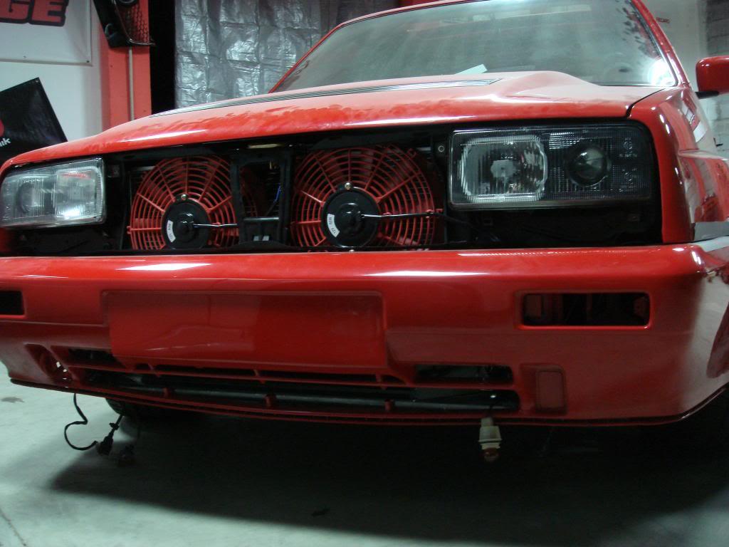

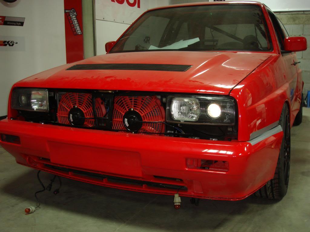

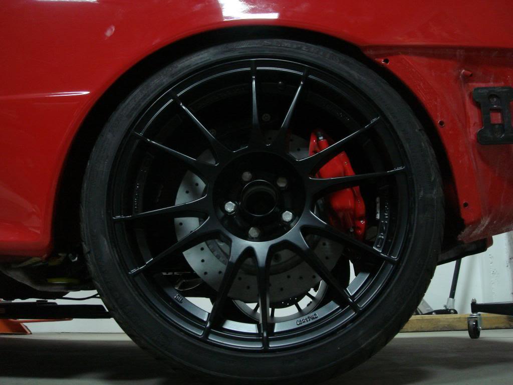

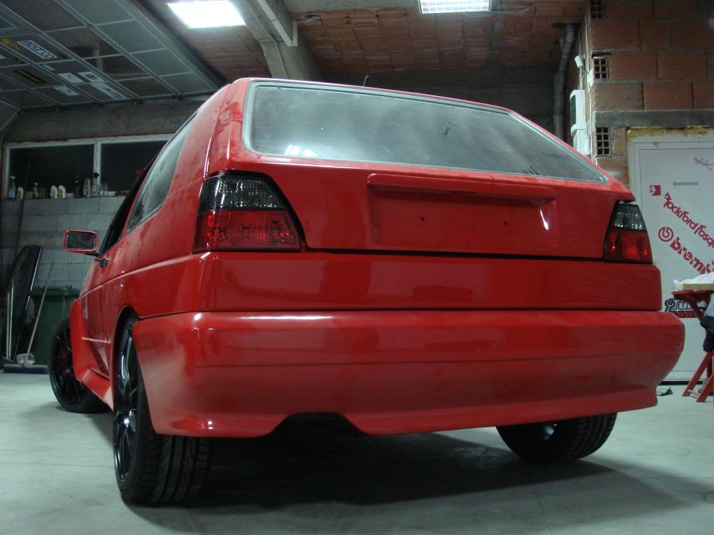

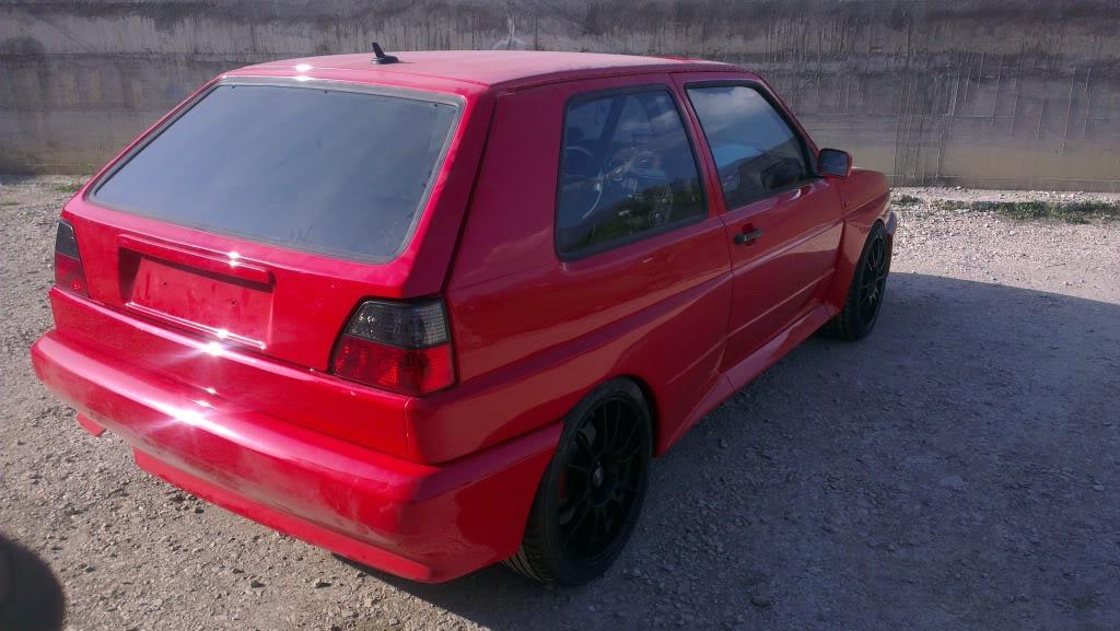

Got the car on wheels  :laugh: ...and painted the headlights in black

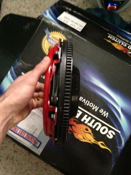

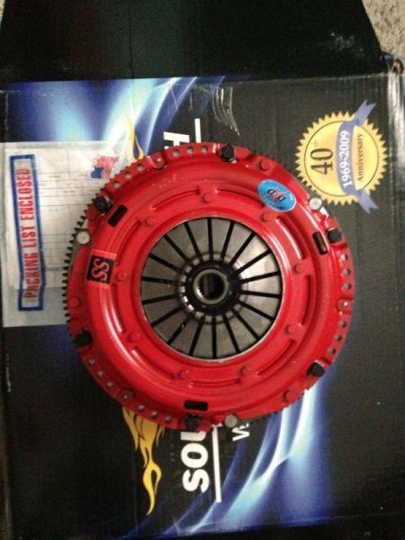

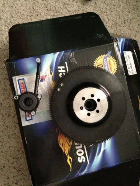

Bought a clutch  :drool: thanks to Issam Abed   :happy2:

« Reply #172 on: April 10, 2013, 08:46:05 am »
looks really good mate!   cant wait to see this in action  :popcornsoda:

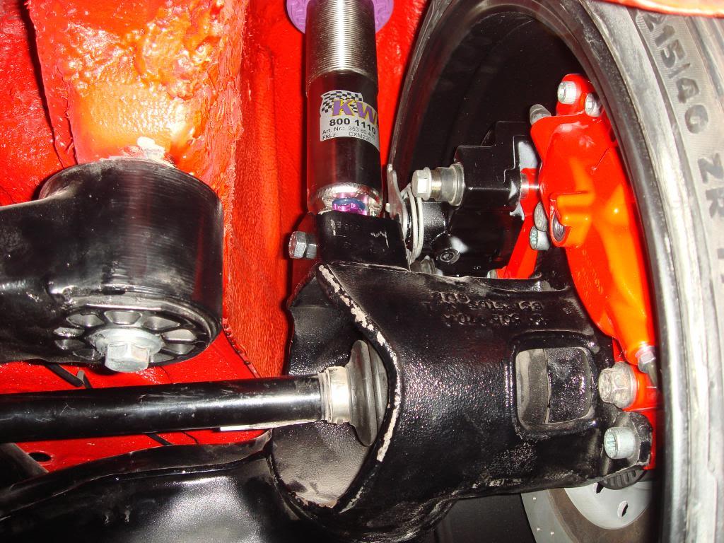

« Reply #177 on: April 27, 2013, 10:06:19 pm »

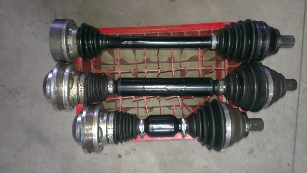

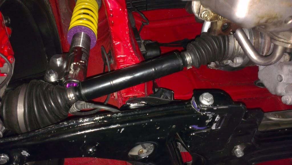

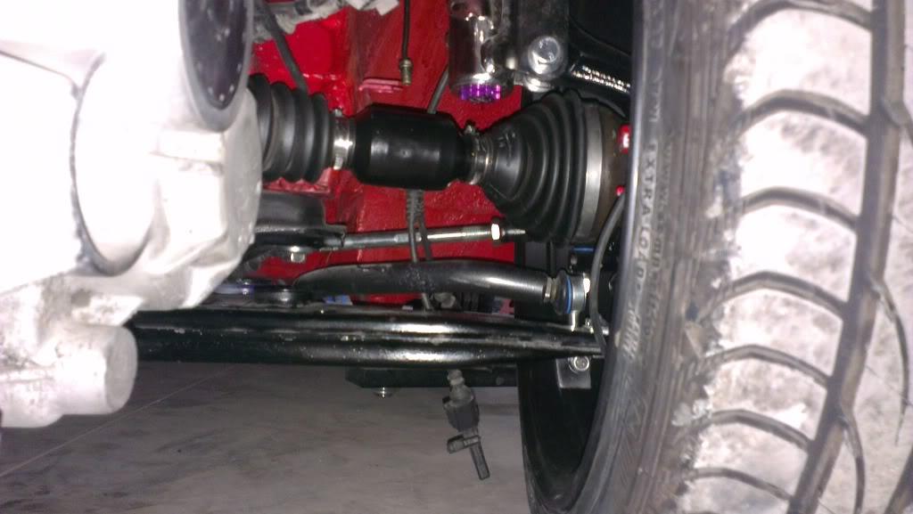

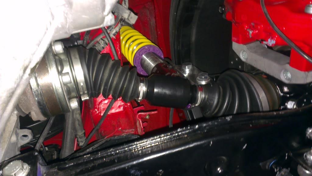

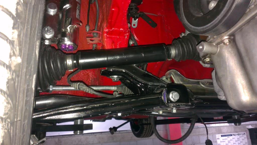

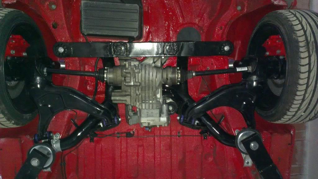

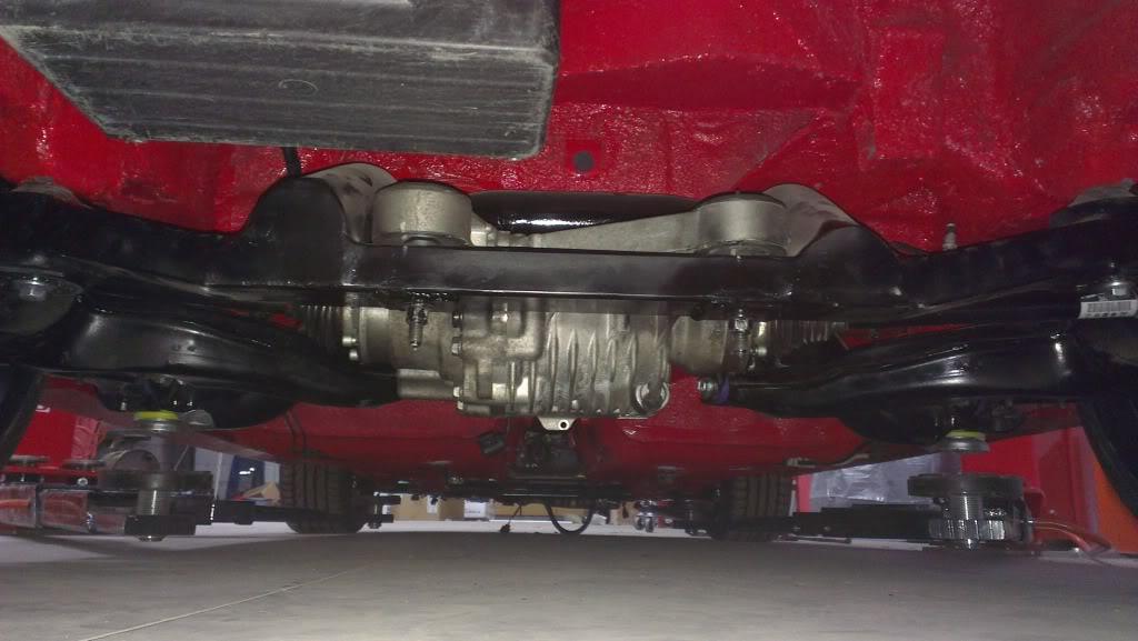

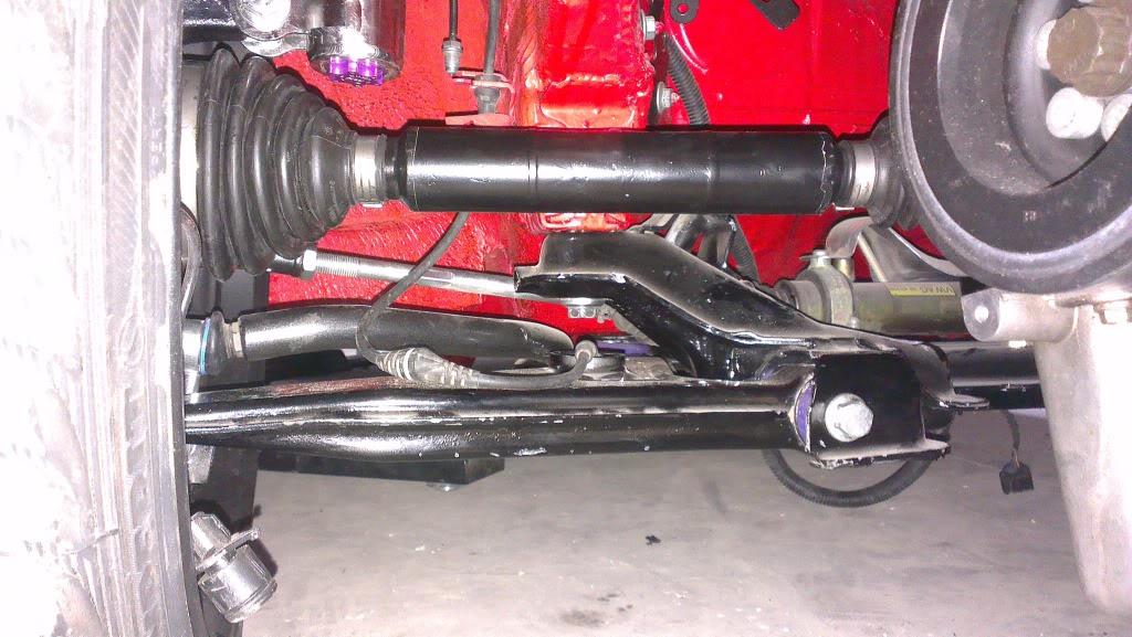

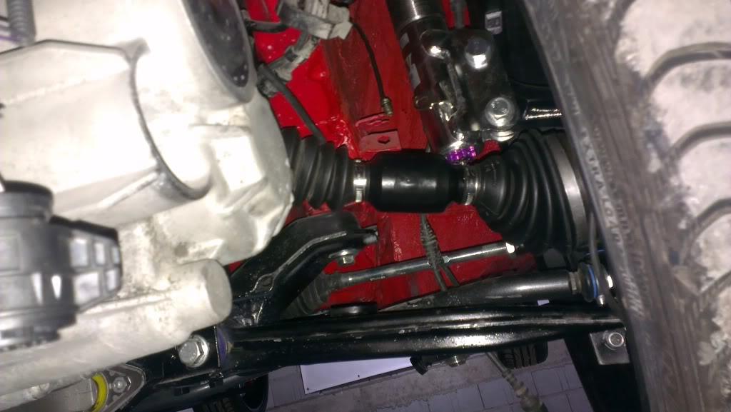

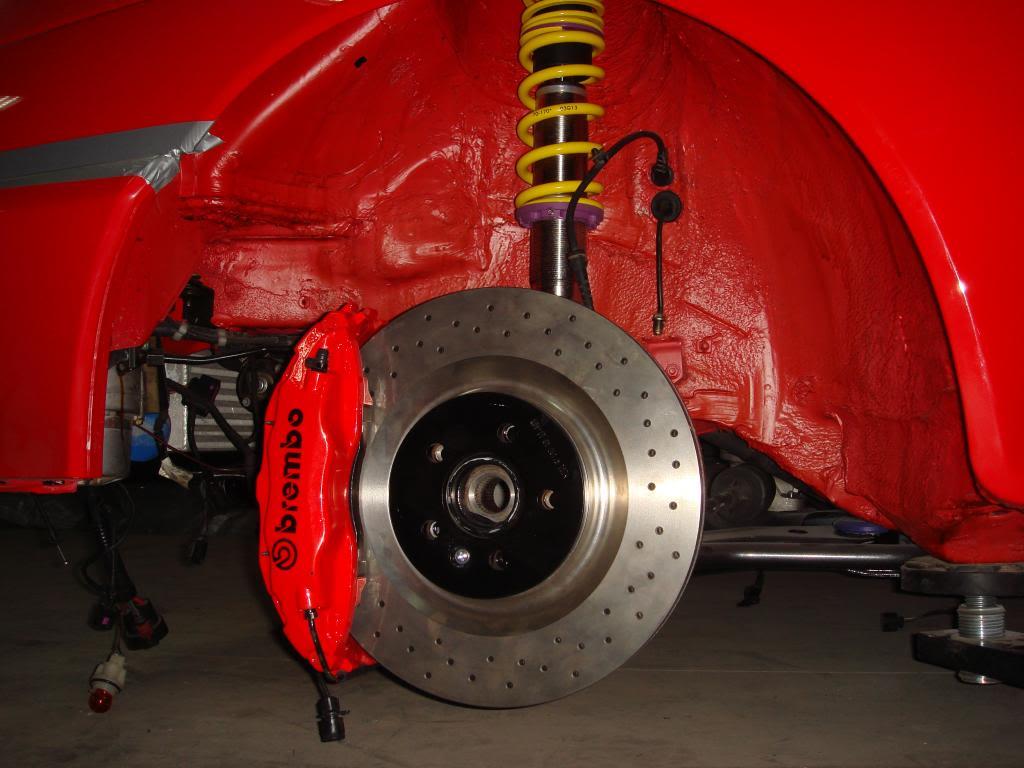

Axle shafts finally finished. After a long search for original ones wit the right dimensions ... i had ro make them  :P
but there is one thing that I really don't like   :embarrassed:
I think the angle is too big and it will be braking joints  :rolleye:
as for the others ....
when lowered on the ground they are pretty straight

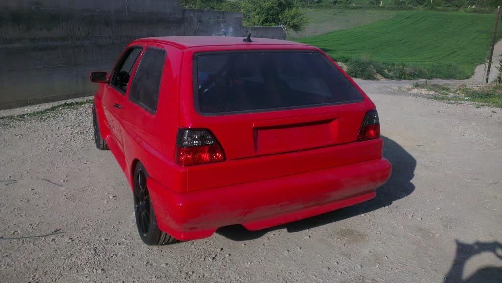

got it out so it can see some sunlight  :drool:

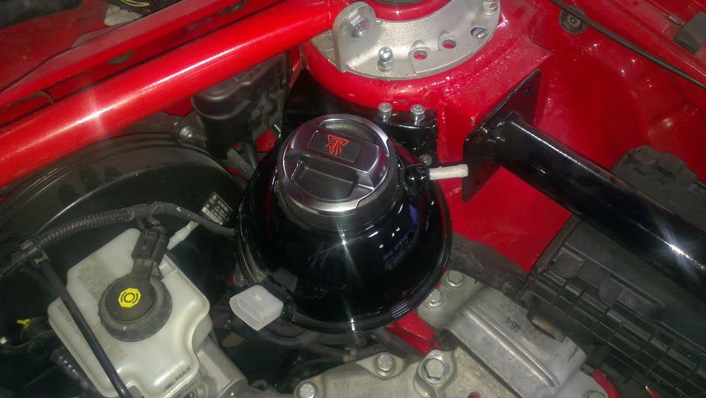

and with my other project

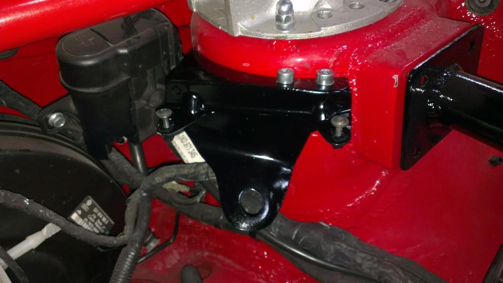

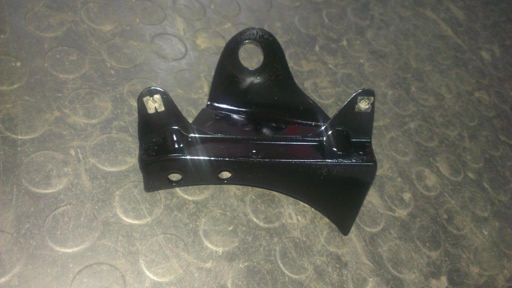

made a holder for the expansion tank

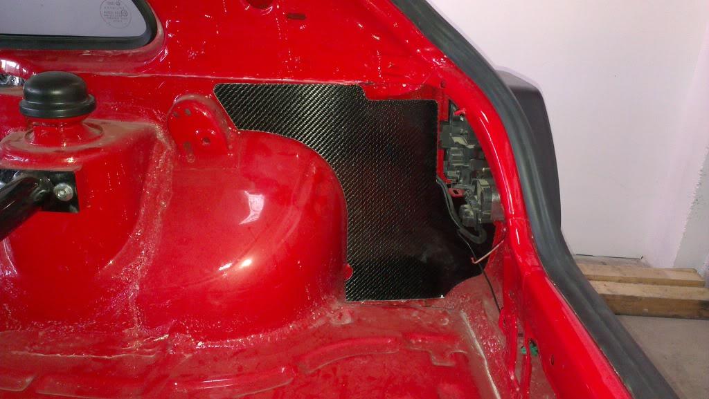

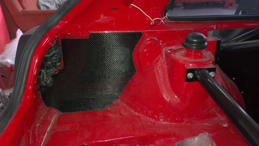

finally arrived ... boot carbon cards
