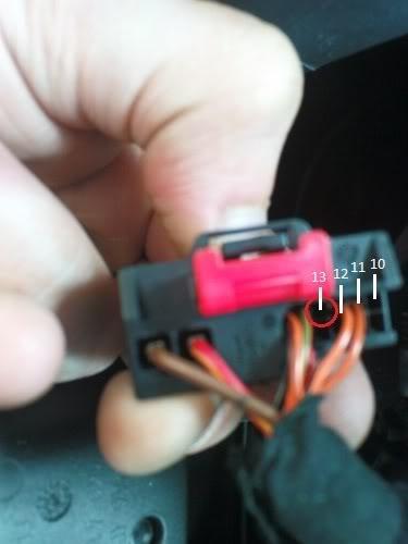

did you check that the plug on the back of the control module had the diagnostic wire?
pin 13?
pin 13?
Is this the black and white wire? if so its there already.
