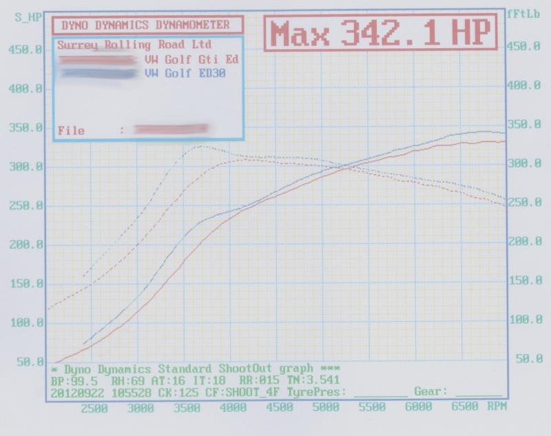

So, today Northern Thor, Hedge and I went down to visit Charlie at Surrey Rolling Road. A bit about the dyno. I've used Surrey Rolling Road a number of times before and along with the JKM dyno (my car read only 1bhp apart from the two dynos within a couple of weeks a couple of years ago) they are the only dyno's I tend to use as I believe them to be some of the best operated and most accurate. So, what is interesting about the graphs, well, I've overlaid my previous dyno plot from Surrey Rolling Road onto the one I got today. The RED LINE is the old code and the BLUE LINE the revised code. The old code was run in 3rd gear, the one today in forth. The old runs (red) were run during late autumn with ambient temperatures a little lower than were seen today. Only difference in hardware between two runs is that I now have the RS4 fuel pressure regulator fitted.
BHP and TORQUE
BHP and AFR
So, I'm going to let the graphs do the talking, this is a factual post based on my experience. What I will say is that I am extremely pleased with these figures from the dyno today. All in all, I am very happy with the revised code, complimented with the linear throttle mapping.

Nice write up Dom  :happy2: Seems that the new map has certainly made a difference mate and after driving my mate's Stage 2+ S3 the other day (after also having the new revised map installed) I echo your findings with the linear/ progressive power delivery of the new software with the added extra punch towards the top end of the rev range.
One thing that does surprise me though is your RR graph  :confused: From my experience, the power delivery at low rpm was definitely less aggressive/torquey than the previous map, yet that graph suggests the complete opposite..  :confused:

Doms car is the only one ive seen with a better result then the old code.
Couple of 2+ cars at JKM the other week ran less figures then before on the old code.
but it's not been confirmed whether there was an issue with the dyno.
