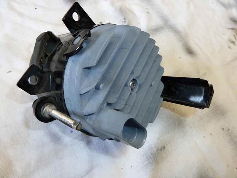

its the same part and yes as far as i can tell from forum posts etc they are complete units.
they also come apart so the internals can be put in the golf fog housings..
the pin allocation..
Pin 1: DRL (all 4 @ 100%, I=380 mA)
Pin 2: Massa
Pin 3: PO (Positionlight) all 4 LED`s dimmed, I=55 mA

think i might get these and have a play. :)
I'll probably turn fogs off completely with VCDS and then wire these myself. hopefully its as easy as ignition live / earth / and a feed from the lights so it knows when to dim?

They use what appears to be the same 3 wire system as the audis... So you can either use a control box (like the chap did over on r32oc where he installed the a6 drls on his r32) or u just leave pin 2 empty
From what I've read and my understanding, pin 2 is the 'dim' function at 15% output, which is usually activated by the CECM... Which is why it would be nice to get the CECM to do the work. But if this can't be done, then either leaving it untouched could work...or...if memory serves me correct I think the correct solution to avoid MFA errors if using them as fogs was to actually wire pin 2 to ground, ain't got a clue what this does internally - assuming it tells the light unit that there is no longer a 'dim' function available and to work at full brightness?...
