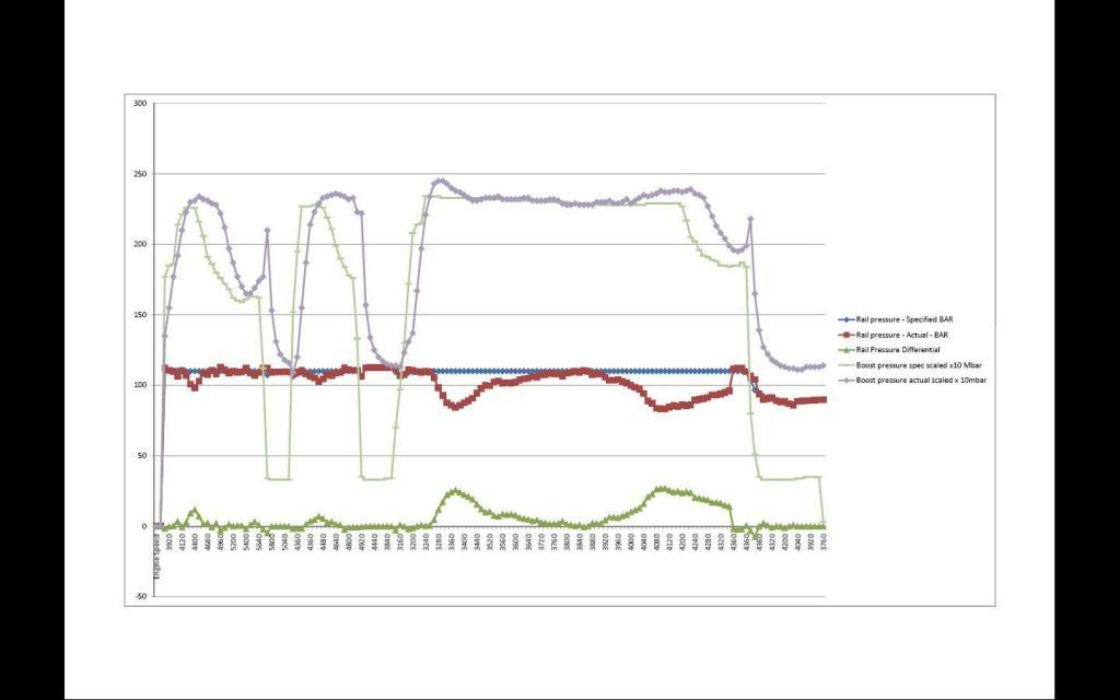

Now I've got VCDS I decided to do a bit of logging - I've been experiencing a couple of flat spots in the delivery of power from my stage 2 bluefin mapped car.
Well.. I've noticed what the problem is : the car is boosting slightly over the specified boost up to 1.4 BAR achieved and this is causing fuel delivery issues, where the fuel rail pressure achieved isn't matching up with the requested on wide open throttle, with the engine heavily loaded in 5th/6th gear pulling through 3000 to 4500 rpm.
Here is a graph
I think I need to contact superchips to see what they can do first thing Monday.
Anyone had this with bluefin stage 2?

The ECU is usually requesting 0.1 to 0.2 bar less than the car actually achieves. When the car is achieving 1.43 BAR boost, its seems its too much for the fuel rail because you can see the pressure drop away by 10 to 20 bar from the requested fuel pressure when the car hits that boost. Slightly lower boost and its fine.
You can see it clearly from the graph. The top two lines are Boost Requested and Boost Achieved - i've scaled them if you add a 0 to the end of the number you get millibars and then deduct atmospheric pressure of 1080 millibars and you get boost pressure
The next two lines down are the fuel pressure requested on the rail (in blue) and the fuel pressure achieved (in red) - they are measured in bar.
The horizontal axis is RPM.
And the bottom green line is the differential between the requested and the achieved for the rail pressure - also measured in bar. When you see the differential line spike - there is the problem - both times at peak load in the 3000 to 4500 rpm peak torque zone where the car is running 1.43 BAR boost.

I can't really read your graph very well, for me it's easier to look at the numbers.
You will get a drop in fuel pressure at the mid range, it's a known limitation of the stock fuel pump.
I think your graph may be making it look worse than it is.

Hi there,
During this phase of fuel pressure drop in the high torque zone, timing goes down to a steady +3, fuel pressure is fluctuating all over the place, but on average a 20BAR less than requested.
The car goes from feeling strong with a nice consistent surge to a slight feeling of alternating gentle reining in during the 3750 rpm through 4300 rpm, then it comes strong again and then the same feeling as it passes peak power in the 5300-5500 rpm range. - I only feel this if I'm doing a wide open throttle pull in 6th gear starting at 2000 rpm.
Last week, it threw a DTC code P0087 Lower limit fuel pressure intermittent in the Engine ECU at 3200 RPM with WOT in 6th gear and the car did an enforced throttle reduction.
So, I think, perhaps because of the Forge unit (I'm running the stronger spring), in my particular case, the bluefin programming will need it's requested boost toned down by 0.1 or 0.2 BAR to stop it 'over boosting' and maintain fuel pressure in this danger zone. I suppose they programmed stage 2 for a normal diaphragm valve with the only hardware change expected being a hi-flow cat and down-pipe.
I'm going to have a conversation with SC on Monday.

Yeah I read your story with your conversation with the guy from australia on mkvgolf.
 I think my problem is a little different from yours, because when I read your story, your fuel pressure requested versus achieved was inconsistantly variable all the time, whereas mine is only inconsistantly variable on high load, in a specific series of RPM where boost is excessive (i.e. 1.43 BAR).
At anything lower than 1.4 BAR boost, my fuel pressure is perfect. I'm going to ask SC to scale back the requested boost in the danger zone, so that the car will only achieve less than 1.4 BAR boost in those areas and then I think it will be fine - I'll let you know how I get on.
