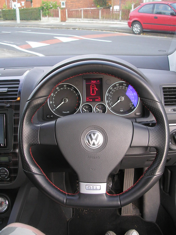

« Reply #5 on: July 27, 2012, 09:38:59 pm »
Got .:R clocks in my 140 Diesel, have to find the right part number to get them to work, no glowplug light and revs are high but everything works as it should, looks amazing too  :happy2:
