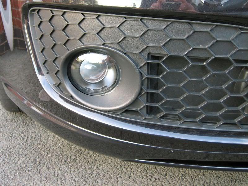

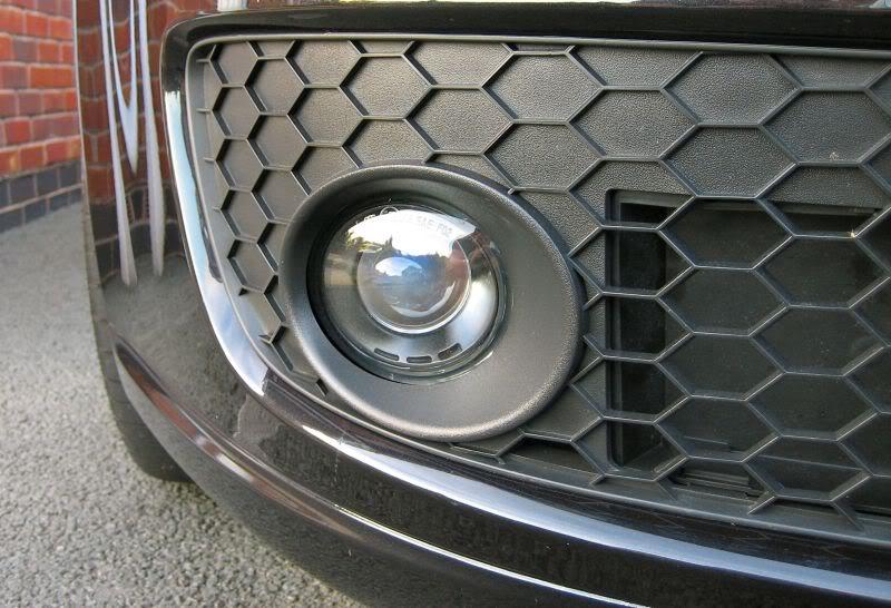

Hey, just taken some pic's so you can see the difference
