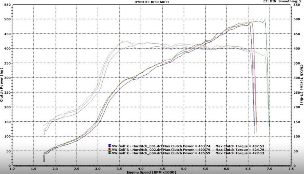

so your running 2.0bar now john? and it made 500?
TSR PERFORMANCE GTX30 520BHP
LITCHFIELD R35 GT-R 660BHP
MSL E63 AMG 720BHP
HCP BM3 M5 800BHP
Re: Hurdy's 500+bhp Golf .:R
« Reply #2613 on: May 30, 2014, 05:57:11 pm »
Last time I went on Statllers dyno it made 500bhp and just made 364.08g/s at the redline. It now makes 364.08g/s at 6200rpm and power still builds up to 7400rpm. I recon much more than 500bhp peak, probably nearer 530-550. At 2 bar boost. Boost controller actually reads this......

500bhp on the nose??  :popcornsoda:
On the lower setting and just making 364.08g/s at the redline on Statllers dyno it made this.......
Isnt that 400+Hp and not 500+Hp   :innocent:  :grin:
« Reply #2623 on: May 31, 2014, 01:06:29 pm »
Normally I'd say yes, apart from when it did the power below at Statller......
On the EXACT same settings it did the power below at Awesome GTI......
Soooo...
460bhp at Statller = 495bhp at Awesome GTI
Ergo...
499.8bhp at Statller = well over 500bhp at Awesome GTI
Statller's bhp roughly equates to Awesome GTI's awhp as it was 462awhp at Awesome.  :star:
