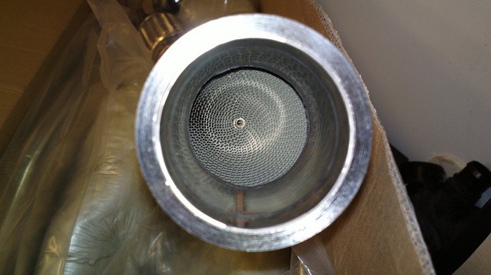

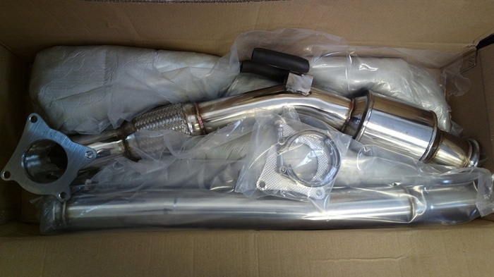

I received my catted ebay downpipe and took a couple of photos.
Heres the package, the v-clamp doesnt look too quality but hopefully it will do the trick. I might need to find some high temp sealant for the connection. Welds look pretty good, atleast better then my squat bench  :smiley:
The 100 cell cat here. Looks like it will flow a lot better then stock, not sure if it will clean air :wink:

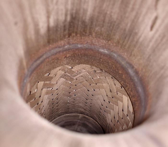

Its already rusted inside :happy2: But the flex joint _looks_ like its leak free.
