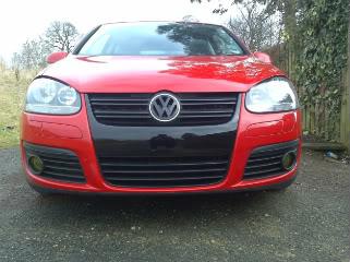

Any chance any one on here knows how to remove the number plate mounting? Got some new black plates for the car and think it would look abit nicer without the mounting as the front plate is also slighly smaller!  :happy2:

You have to take off the front grille (easy peasy four screws) then push the circular plastic clip on the back of the grille that hold on the plate holder through (you'll see what I mean once the grills off) then you can pop the clips holding the plate holder on out!  :happy2:
Call me if you want a clearer explanation Manu!  :happy2:

Thanks for the replies guys! Although...the number plate which i have for the front is slightly smaller than the normal ones and i think there will be some holes on the grills...i do know about the hole-less grill available in the US but is there another i can go about covering these holes?  :smiley:

I too did the same as whiteGTI and drilled out my plugs...
never tried to take the grille piece out  :ashamed:
vinyl wrap or blanking plugs from a DIY store can be used with varying levels of success...
either that or fit 2 bullet cams  :surprised:

all I did mate was take the grille to a bodyshop and they filled the 4 holes and sprayed it for £30
its cheap enough to be done. or have you thought about getting a "euro-style" plate holder?

Cant beleive I did not think of that! Gonna check out some body shops and see how it goes...maybe try and get some new pics of my car up aswell.

Spraying won't be so easy on your grill Manu unless your happy to lose the brushed aluminium effect?
