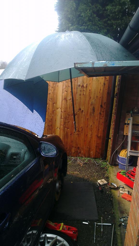

Not good. This is how I ended up doing the timing on mine a couple of weekends ago just because it wouldn't stop raining  :signLOL:

Ghetto - I like it  :laugh:
