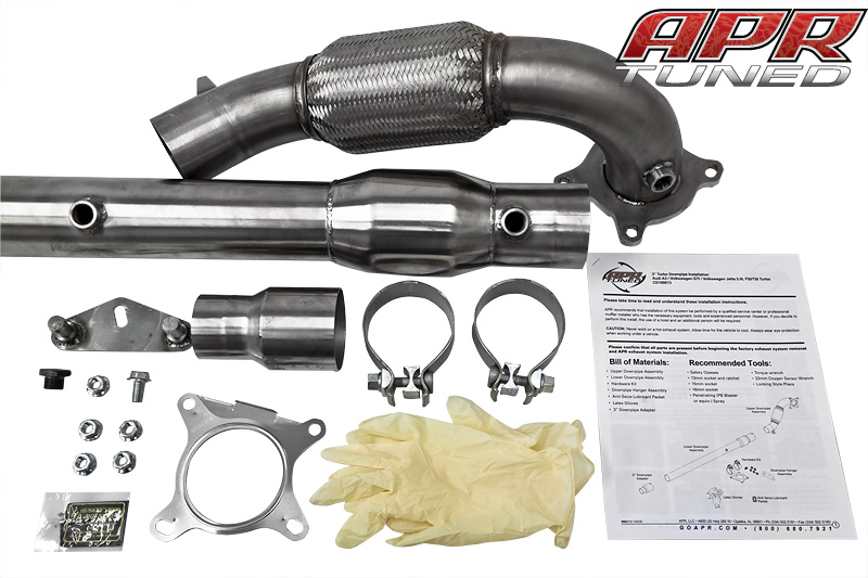

There aren't any OEM ones that will give you performance increases.  Most OEM 2.0TFSI downpipes from transverse FWD cars will bolt right up, like Audi A3's and TT's.  You'll need an aftermarket dp to get any performance benefits, 3" is usually the best with a highflow catalyst of 100 to 200 cell count.

Most milltek dp's are the same across all 2.0 TFSi's, even their AWD ones, just check the part number on the dp before you purchase and cross reference at their website.
Our's will go all the way back to the hanger in front of the rear axles and would replace their center section.  You will need to trim some length to be able to use a reducer as I believe most milltek exhausts for MK5's are 2.75" and our DP is 3".
