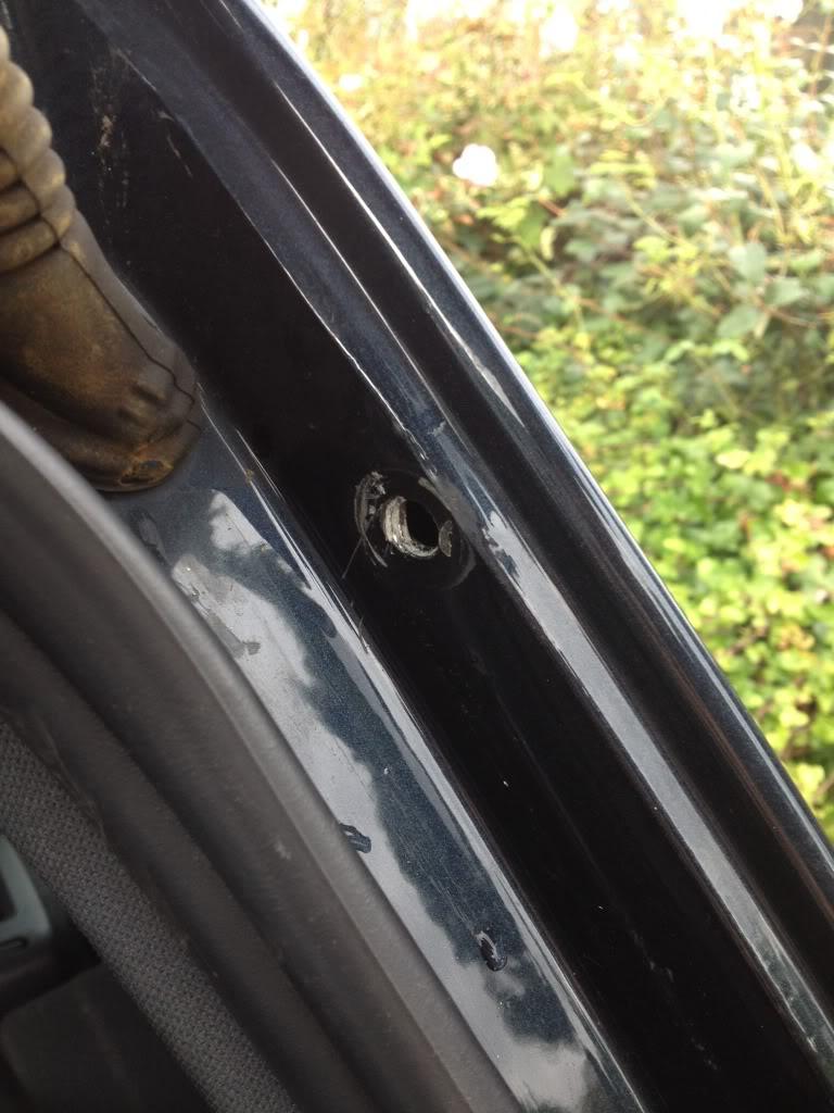

My first post, it looks like a good forum! I have just bought an 05 plate Mk5 Gti, and need some help!
Last weekend, I opened the boot. The right hand strut ripped itself out of the body! The bolt with a ball on the end, onto which the strut fits litteraly ripped out! See this pic (sorry if it's a bit big, but wanted to show the detail):
I took it to a garage today. They said they couldn't get any access behind the panel, to secure the bolt with a nut. The didn't want to weld it, in case it damaged the paint (also it wouldn't look very neat).
I've searched around on the net, and I've found two other people with the same problem, but I can't seem to find any solutions.
Any thoughts?
If not, the next step I'll try a main dealer I guess.
Thanks,
Alex

Assuming that the end screws into the body panel then the only solution I can think of is to install a nutsert/rivnut that the strut can screw into. You may have to enlarge the original hole by drilling to accept the nutsert.
This is how the nutsert works without having to go behind the panel.

Thank you, that's a very helpful reply. I might speak to the garage again and see if they have one, but I'm also very tempted to get the tool and give it a go myself!

I have this problem with the strut mount nut lost inside bodywork.
Has anyone resolved this with a rivnut or other method.
Rivnut looks like good solution but I can see access issues for a drill if hole needs enlarging.
Thanks !

I've just had this happen to my cat, same side. I've seen a few posts about the rivnut but some people have said it's only a temp fix.
Anyone found a better solution? Maybe welding of a nut?

Is there actually a captive nut behind there?  The metalwork looks kinda reinforced enough to be tapped in that area, which could be why this problem happens....it's not man enough!
But yeah, a rivnut is the least invasive fix unfortunately, but I'm not a fan of them personally.

I used the Rivnut method and it has held good (touch wood) for last 5 years.  I'd advise getting a few different sizes of Rivnut to see which fits best.
To answer Pudding's question - there is a not-very-captive nut behind that easily gets dislodged.

Rivnutted mine, same issue, same side. Just don't use too much force when you drill or you'll feel like a muppet when you make a lump in the bodywork...not that I did that or anything  :ashamed:
