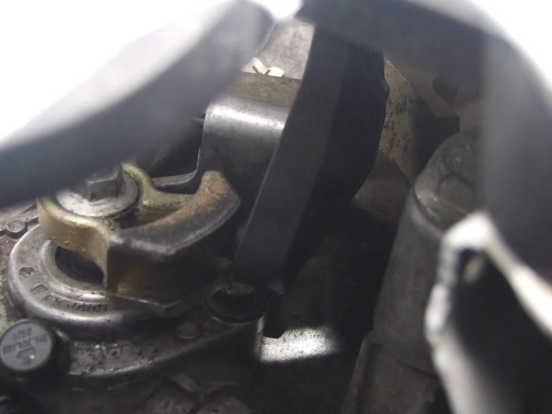

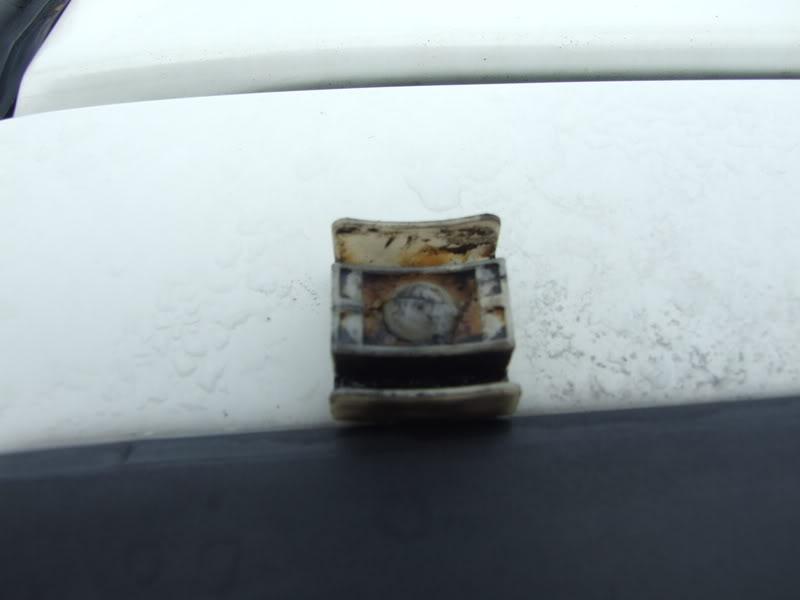

Re: Gearshift Problem....
« Reply #14 on: June 15, 2009, 08:24:09 am »
Not heard from mark yet...
It is the side side action that is screwed for some reason.
The black bracket doesnt sit in the channel it should do.
Have tried to relocate, no joy.
Currently limping through france towards calais.
