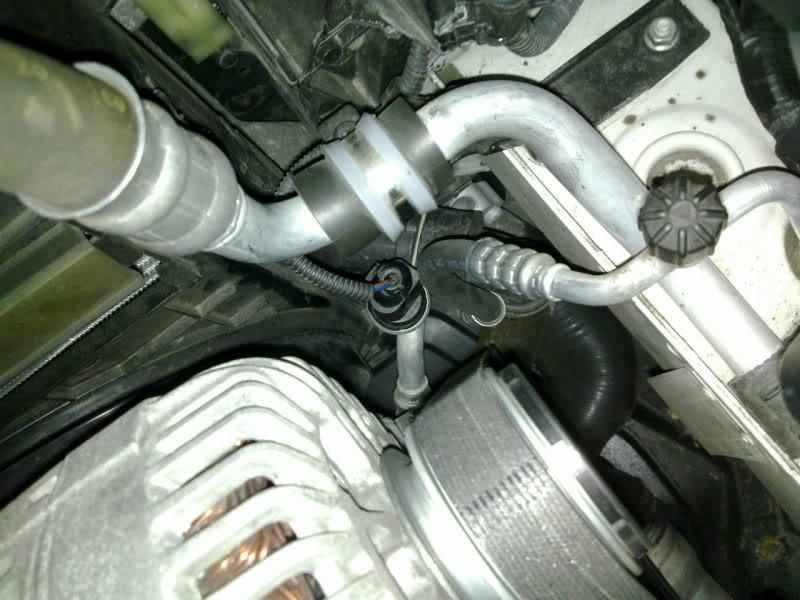

Yet again my car strikes again, this tim ethe aircon isnt working.
I did a VCDS scan, and it said 00229 - low pressure
I took it to kwik fit, who said they drew 400grams out, and put 530grams in, and it had no leaks.
So it only leaves the pressure switch or the compressor.
Am I correct in assuming the switch is the one that you can see behind the radiator pointing upwards? and I can change this without letting all the gas out?
or is it a waste of time, and I just need to pay for the compressor? Does anyone happen to know the part number for the switch by any chance?
Thanks in advance for any help :happy2:

Re: air con not working - Help!
« Reply #3 on: October 08, 2012, 06:21:28 pm »
Yes you can... the part where the pressure switch screws into has a valve in it.  :happy2:

« Reply #5 on: October 08, 2012, 06:32:54 pm »
Is that the sensor behind the headlight area?
I'd rather try the sensor before the compressor to be honest
« Reply #6 on: October 08, 2012, 06:35:42 pm »
Yep... behind the rad. on the left hand side.
« Reply #7 on: October 08, 2012, 06:37:07 pm »
Centre of pic with elec. connector on top
« Reply #8 on: October 08, 2012, 06:49:09 pm »
Thanks for info, looks like a nice easy part to get to  :surprised: :scared:
« Reply #9 on: October 08, 2012, 06:51:20 pm »
You need a crow foot spanner.  :happy2:

« Reply #10 on: October 08, 2012, 07:00:10 pm »
Before you buy a switch Dom check the power to the pump very easy to pop the plug and do this first, think I've swapped one switch ever on your platform but fitted loads of pumps, costs nothing to check, let me know if it is the pump, got a few good used in stock (it pulses by the way)

« Reply #11 on: October 08, 2012, 07:17:55 pm »
Thanks for the tip steve, I'll try and find the terminals first then :happy2:

« Reply #12 on: October 08, 2012, 07:31:22 pm »
Just for info my air con fault turned out to be the switch, was around £50 from VW but i guess the pump failing is more common

« Reply #13 on: October 08, 2012, 07:42:47 pm »
Wouldnt a failed pump throw a different fault code?

« Reply #14 on: October 08, 2012, 08:05:27 pm »
90% of the time no codes for a fuxxed pump bet we fitted 15 to Vag group cars this Summer
