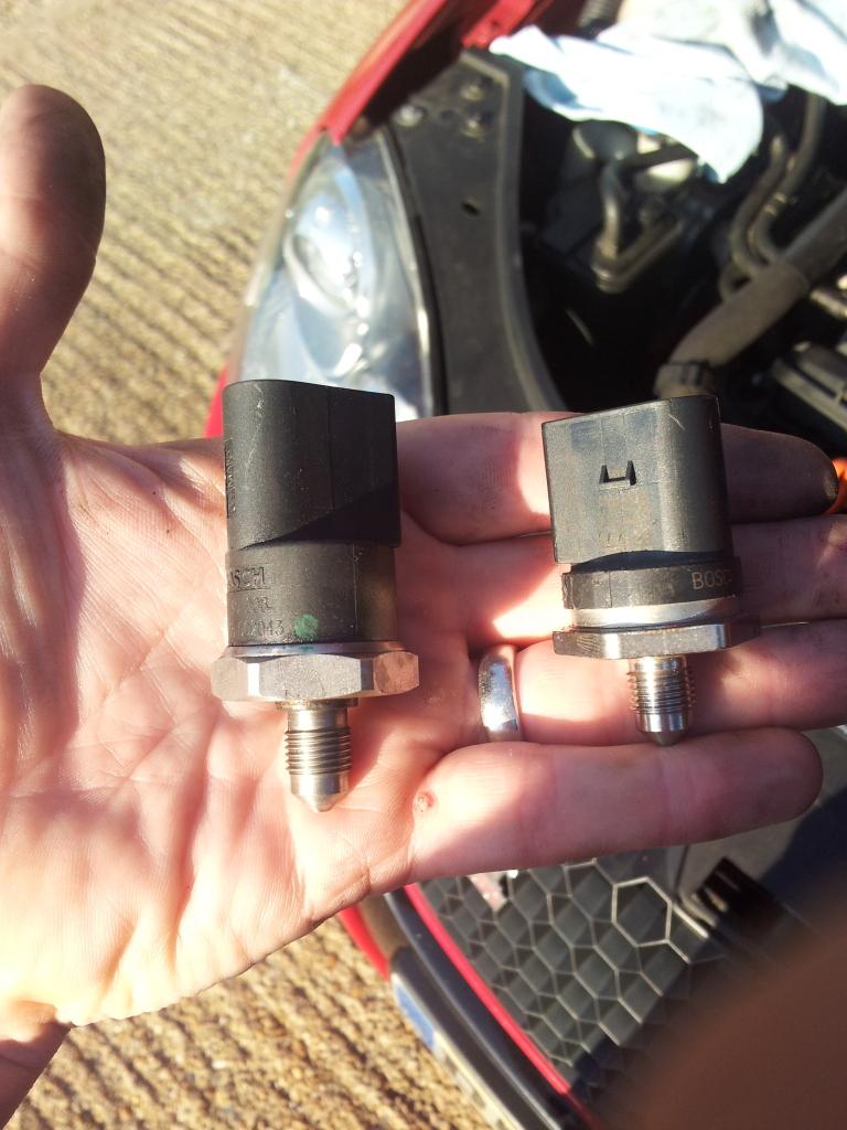

Just to let everybody know you cannot fit a BWA(KO3) G247 into a BYD(KO4) engine.
Something to do with single point signal on the BWA and two point signal on the BYD.
If you have the BWA G247 in a BYD you will get a 'lean at idle' fault and 24mpg even on a long run.
I hope this helps everybody.

The one on the left is a BWA and the one on the right is a BYD:
Which reminds me must get the Wartner out :scared:
