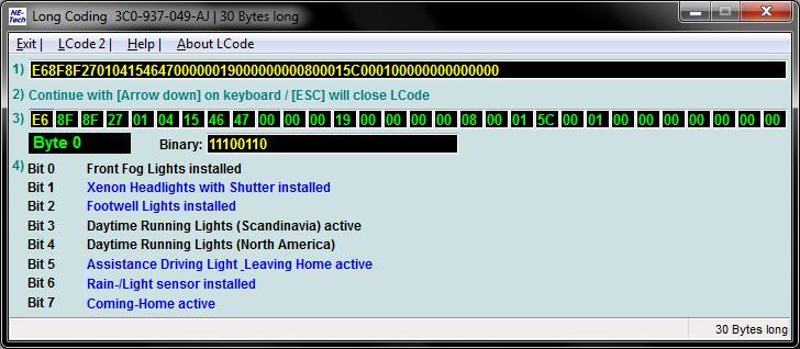

Offline SI-R32
  • -Receive: 126
  • Posts: 1001
Re: Fool the Light Sensor
« Reply #29 on: October 13, 2012, 08:57:37 am »
if you tick  byte 0 bit 3 with VCDS in the pic below in the CECM your headlights will work exactly as you want, just like a Volvo
