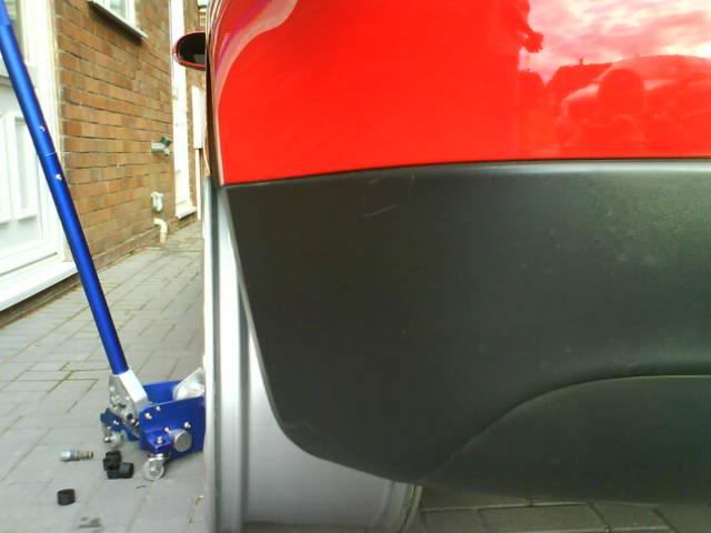

I cant get the wheels i have in staggered widths.I have been told to go for 225/35/19 as 215 are so  small for a 9j wheel according to manufactures guide. (I know 215's can be fitted but i want it safe).
Also 225/35's are the same rolling circumference as the 18" monza II's i have on now so it is just the width that is a issue but when i trial fitted the wheel it seemed to sit ok and not sticking out horrendously.
Re: What tyres? 19" x 9j
« Reply #3 on: June 19, 2009, 03:11:04 pm »
The pic shows a trial fit on the rear, the fronts are more of an issue with width clearance. :happy2:
