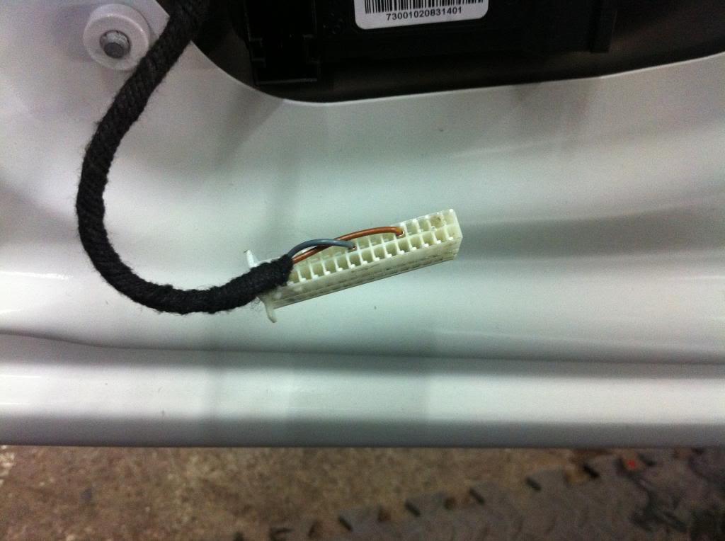

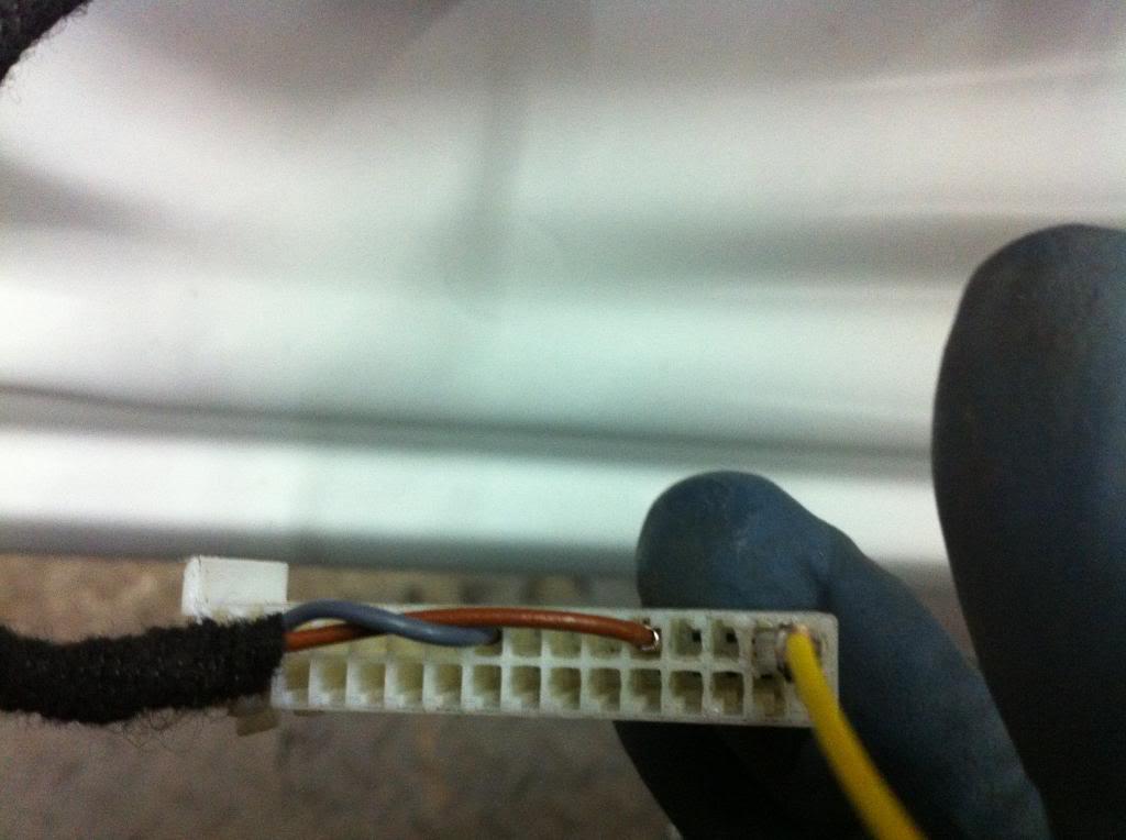

Car is a May2008 built ED30 3 door,
Started at passenger side door,

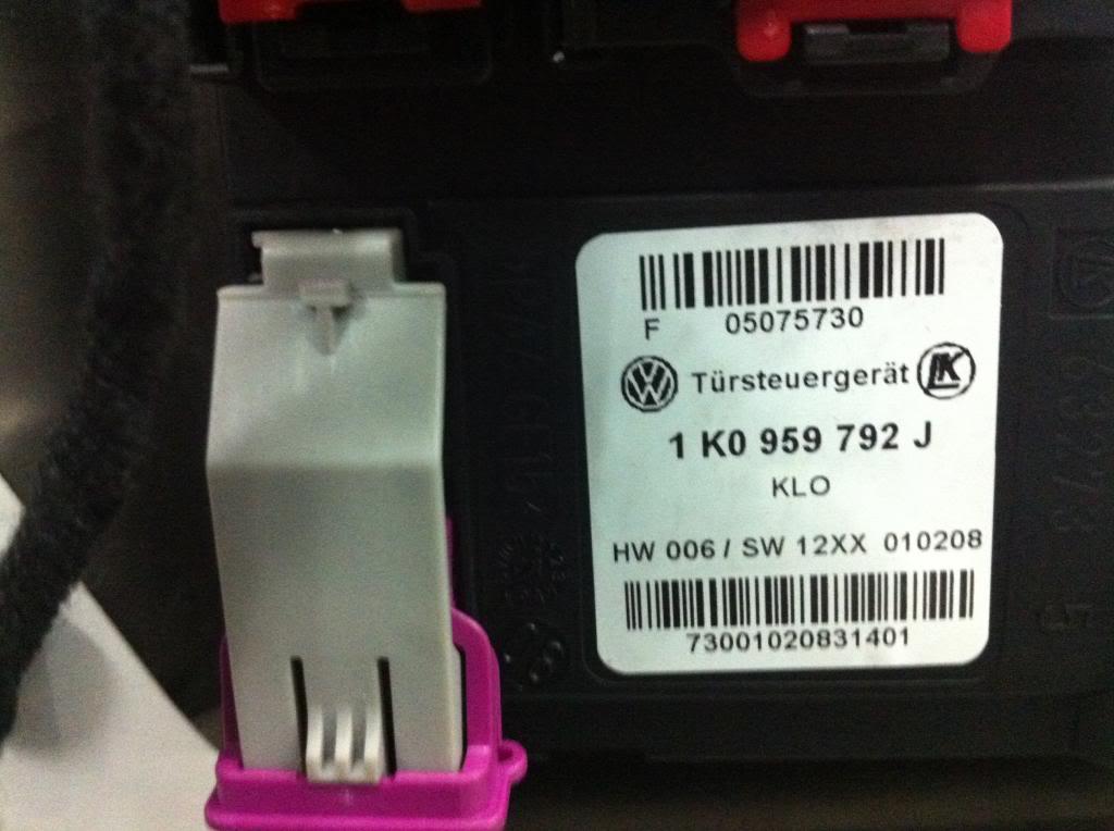

 I Have this controller (btw  Any idea as to what type of controller it is?  GEN 3 min or max)
Trying to fit into  pin numbers 18 and 19
The offending items
The repair wire just will not fit in that hole without butchering the connecter block.
Will call  TPS in the morning to check they have supplied the correct part.
Cheers for the help so far

That yellow cable seems really thick! My one was thin as the factory ones going into the controller

Yeah dude that's the wrong wire. They must have given you the wrong one.
000 979 019 fits fine.

All is  sorted now, tps supplied me a  979 019E and not an 019
Thanks for the help

BTW to answer your question, thats a gen 3 controller. MIN or MAX you'll need to scan with VCDS  :happy2:
