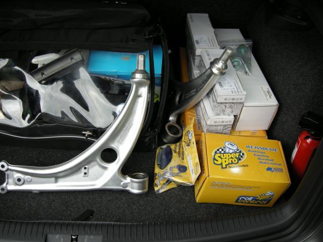

After a long, long time of no updates, and saving for parts - tomorrow is the day I will have the chassis nicely sorted on the car... pic of some stuff to be fitted;
Can't wait! H&R ARB's are being fitted too - really looking forward to how the car will drive after this lot!

Which wishbones are they, TT or Superpro, look very shiny!  :happy2:

Hi Martin - they're actually neither! They were sold to me as S3 wishbones, but they arrived and were Passat numbered parts.
They are ali, and from the research I did - the difference between S3 arms and Passats is just the console. I was replacing this anyway, so it worked out in the end!
I cleaned them, and then acid etch primed - top coat was Halfords aluminium paint - turned out way better than I ever expected!
Went out in the car today - all the float from the front has gone. Love the way it is driving now, and I've barely tested it at all...

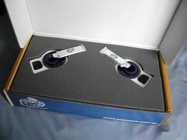

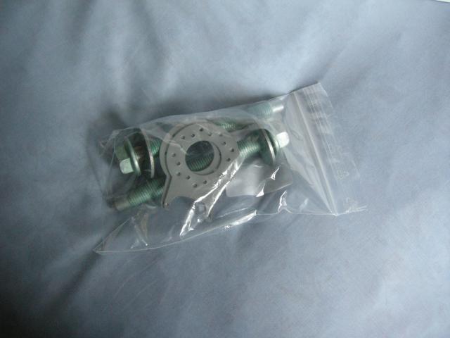

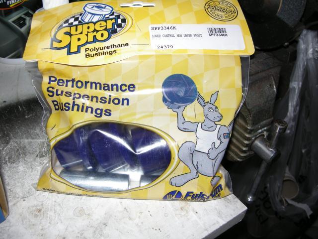

Just realised I didn't really list the work that I had done. It was a very enjoyable day waiting at APS! Here's the full list of works carried out;
H&R ARB's - 26mm front, 22mm rear

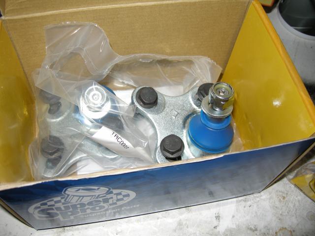

Passat (S3!) aluminium front wishbones
Superpro front wishbone bushes
Superpro ALK consoles
Superpro balljoints
ECS subframe spacer kit
R8 coilpacks
The car feels well planted now, and these mods have nicely tightened the chassis, whilst remaining a comfortable ride.

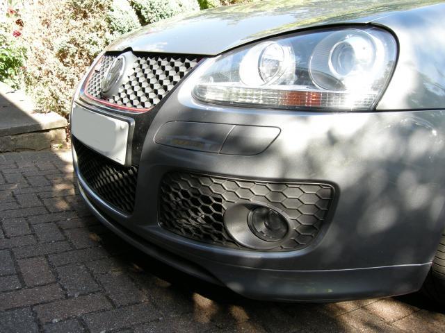

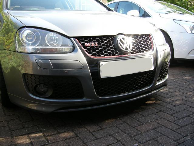

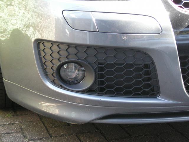

Another subtle OEM touch I always wanted to do was to add the early GTI projector fog lights. I am sure many of you will say it is a waste of money, but I really like the way they sort of match to the Xenon's;
Very happy with the car now - the next mods will be the brakes.

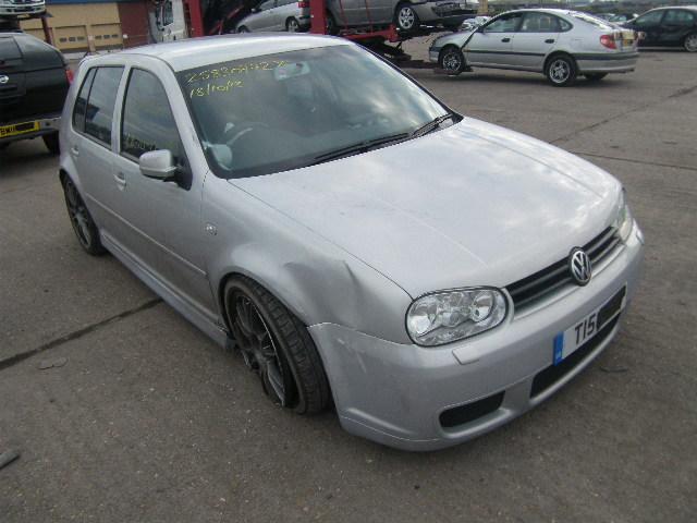

How time flies, and I do still miss my mkiv which I had for 10 years - ended up with K04 turbo on an AGU engine :driver:;
Poor thing after a 1-series hit it from behind & pushed me into the side of a bus;
