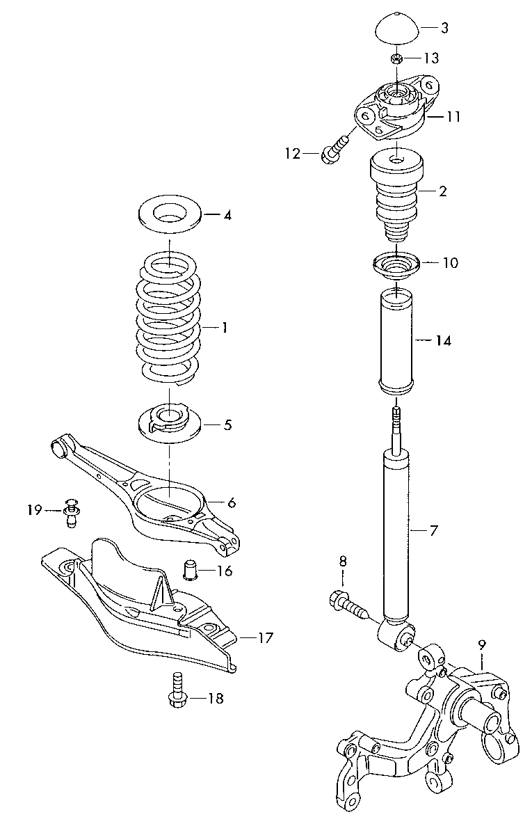

If someone likes to raise rear just less than half an inch I'd recommend
this Audi TT rubber (non S-Line):
Nr 4:
1K0 512 149 B - TT S-Line/GTI/Golf/A3 etc.
8J0 512 149
- Audi TT (non S-Line) -
~ 7.5 mm thicker
